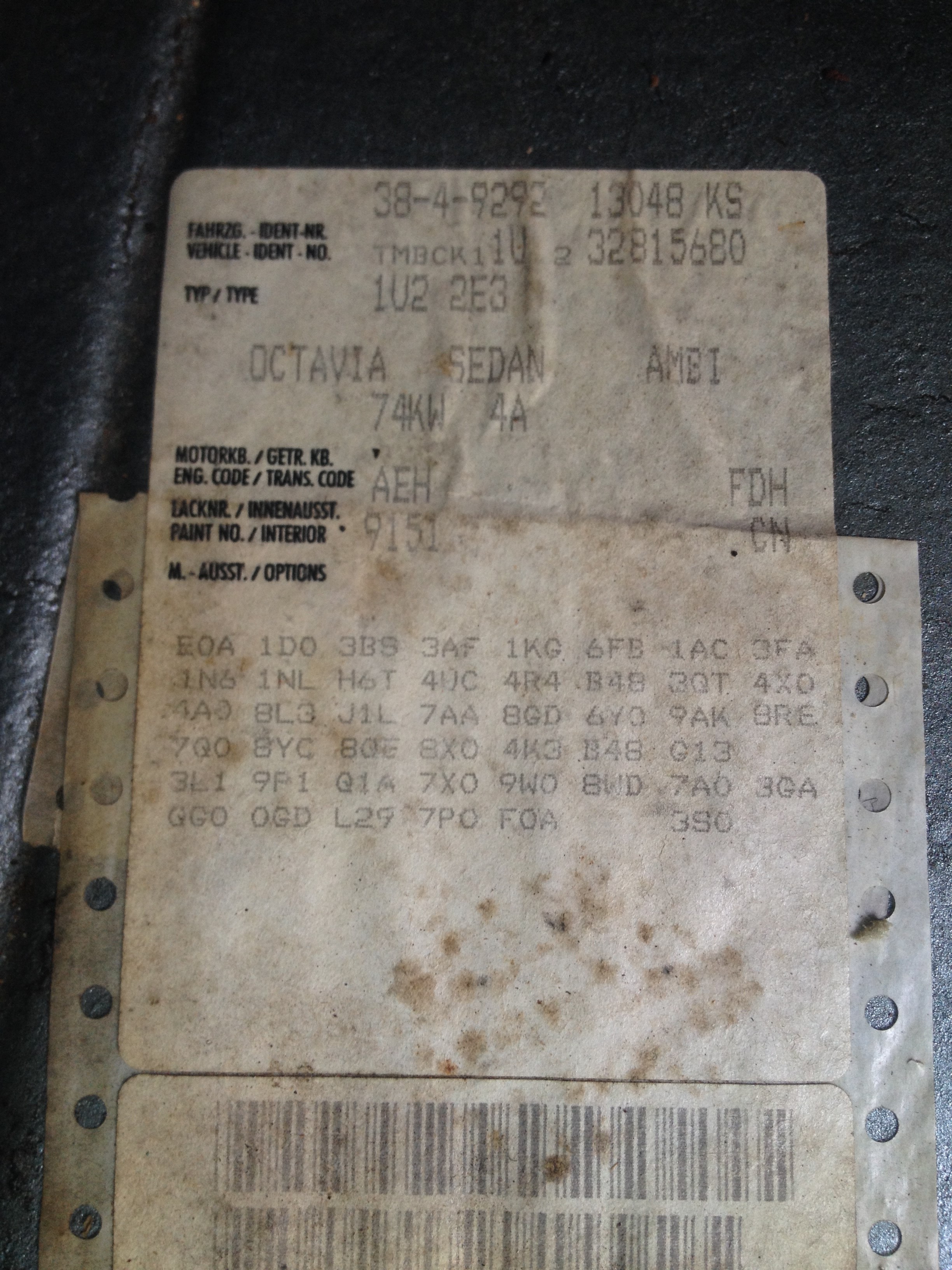

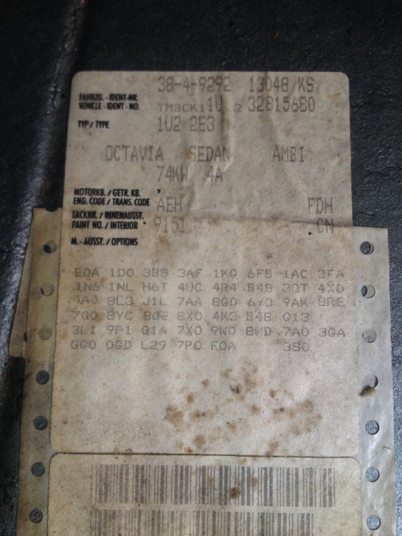

@KenONeill i get the ELM327 wifi yesterday and plug it in but seems not working , keep giving me message can not connect to car ECU so seems not able to get real time data for temperature reading and also i have another issue to figure out why this interface not working :) , any way i attached my car label for motor and transmission code , also i attached the ELM327 photo if you know some post about this
