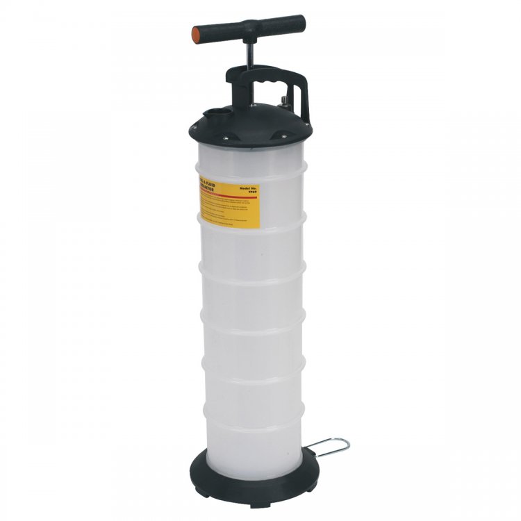

2) Oil extraction equipment.  Getting under the Defender is a doddle with no jacking required but for the Yeti I was thinking about a branded 2.5tn Sealey ramp but I just cba.  Searching the net and different forums it appears that oil extraction is becoming increasingly popular.  Even with draining the oil via the sump plug it appears there's still a fair bit of oil hiding in there, the drainage systems seem to get nearly all out of the sump with a satisfying straw like slurpppp at the end.  After all, as most people said, how do you think people service prestige boat engines etc... does the job.  Does anyone know if it's unadvisable that the 1.6 TDI isn't drained this way.  From my research I've gathered surprisingly that some manufacturers do this with a genuine service (never using the drainplug), some manufacturers outright state that the sump isn't correctly configured to allow this and must not be attempted.

Simply when removing the oil via the dipstick tube with the suitable equipment for removing hot oil also then replace the sump plug with a new one and that is the last of the oil out the sump.
Edited by Awayoffski
Hi Awayoffski,  I don't quite understand :)  I'm trying to avoid getting under the Yeti and removing the sump plug at all.  If I could get under it easily like with the Land Rover I would as I don't mind any mess etc it's just for ease of oil extraction and safety really.  I know the sump plug is the preferred method but not easy for the home mechanic.
Do not remove the Sump Plug then to get the last oil out, it is just how professional should be doing it now, H&S and all that jazz vacuuming out oil,
good practice changing sump plug and seeing the dregs.
I totally agree with yout Awayoffski, in an ideal situation I would do the whole sump plug removal like with my other diesel.  My ethos is when it goes for a major service it can have a sump plug drop treat :)  Just wondering how many folks on here use the vacuum method...  and recommend using it it if you've had one too many ales at the local and need a clearout :D

Bought a Pela 6000 oil extraction device from a Marine shop on the net.

used a Pela for years BUT always remove sump plug after vac'ing oil out of an engine for the FIRST time(new to me anyway)  just to make sure

I've tried the Pela 650 but wasn't that impressed as there was still a fair amount of dirty oil in the sump when the plug was removed. There is a lot less mess though using a vacuum but I think it is more to do with convenience rather than effectiveness. I'm still the type to run a little clean oil through before installing the sump plug back.

sump plug may be quicker sometimes (especially in winter) but vac is good for emptying the oil filter housing -and cooler?    there's an awful lot in there
Yeah, I liked that element to it.  Managed to extract that bit more from within the oil filter housing.  It would just be recirculated otherwise.  For a major service I'll have the sump plug dropped by the pro's. In the meantime, this method will essentially allow me to "over-service" the Yeti in a cost effective manner. Perhaps every 5,000 miles.  Quality filters are relatively cheap and so it a top branded oil... when you think of the price of a full tank of diesel these days :/  Think how much of a job the oil does...

I always use the drain plug method,I use a little syringe plus plastic tube to clear out any remaining oil in filter housings etc.
On engines with an 'upright' type oil filter - I always remove the filter first to allow any filter housing oil to drain into the sump first and then I  remove the sump plug.
