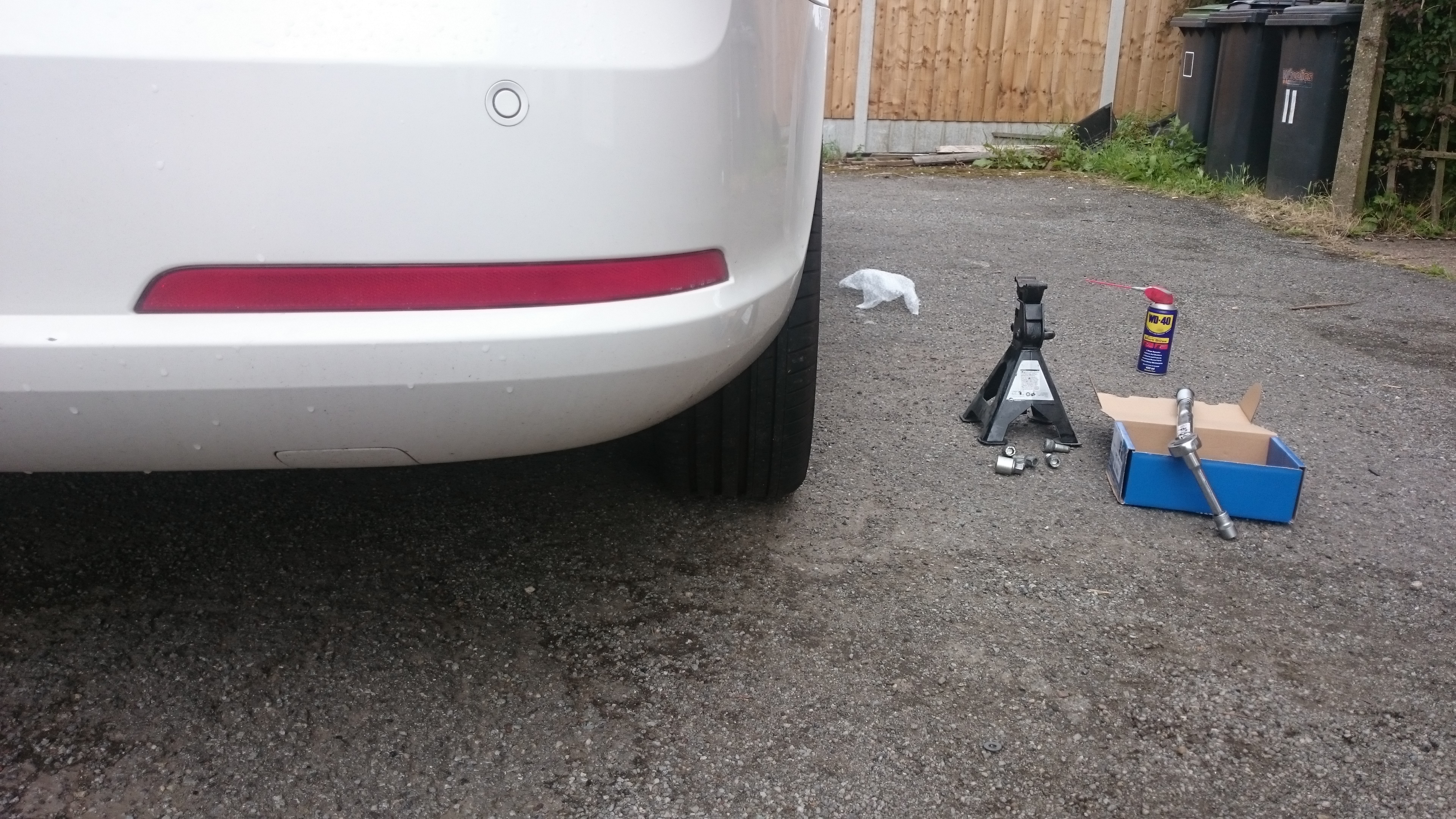

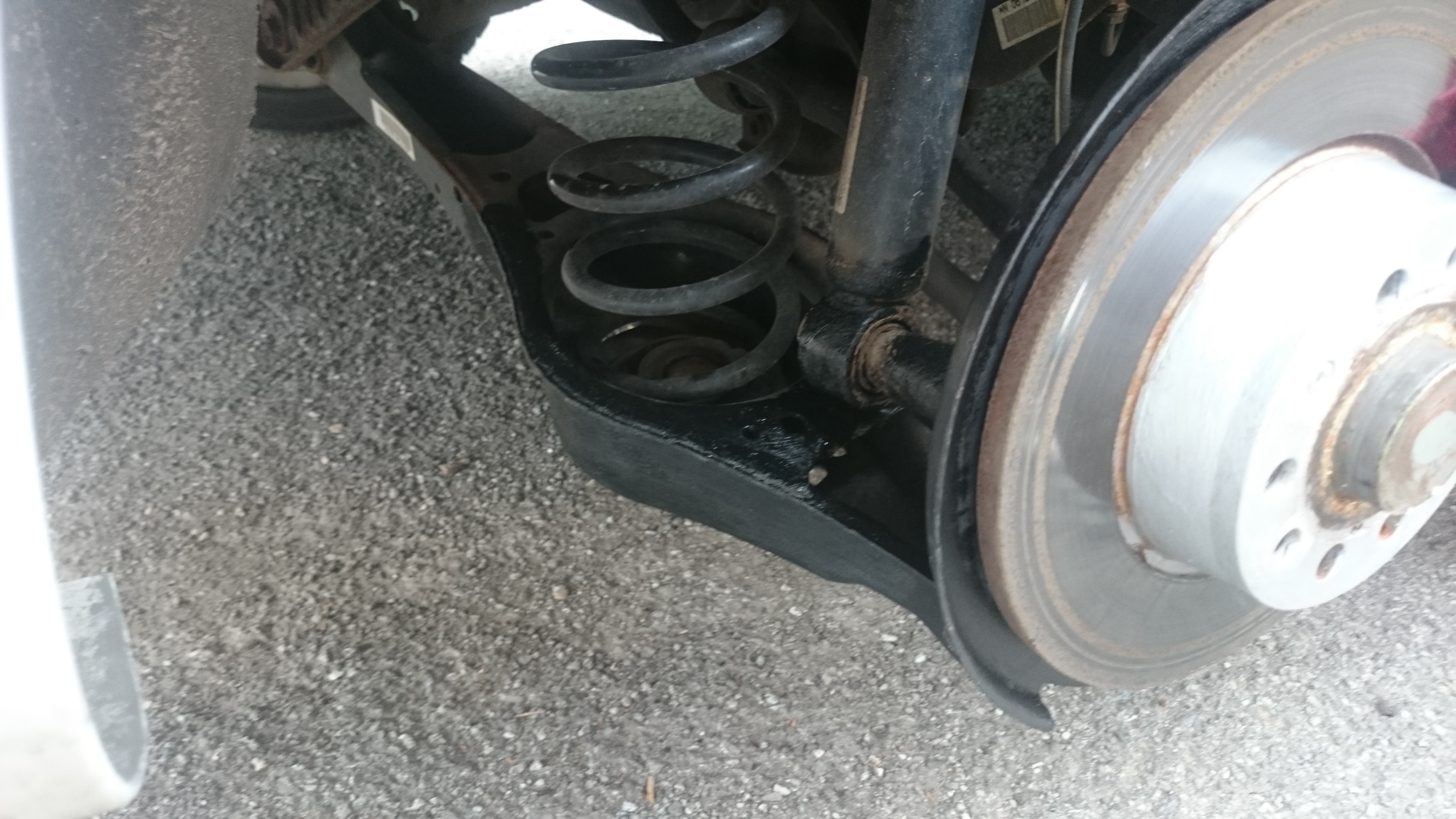

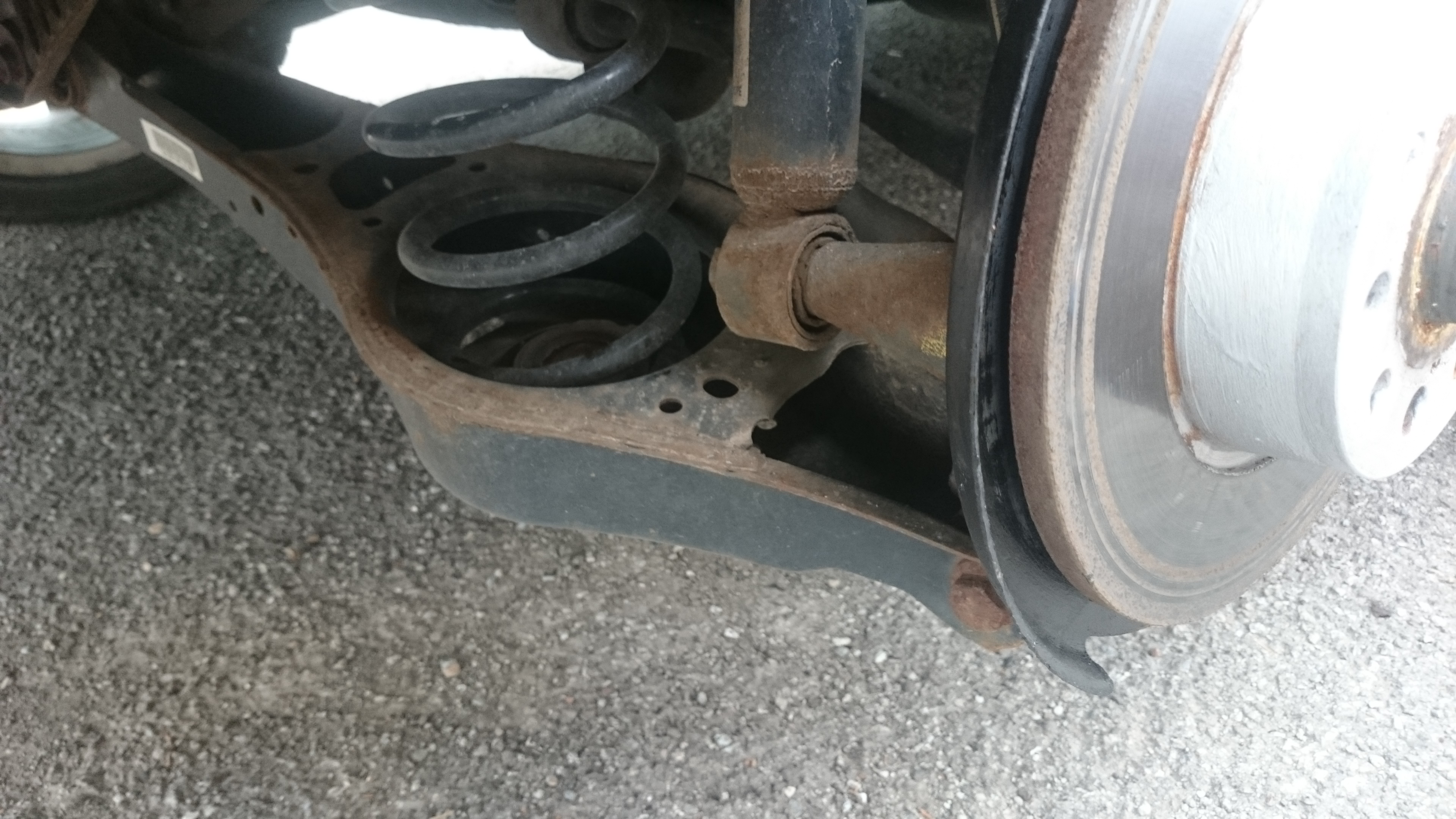

Spacers didn't fit like I wanted them to so whilst the wheels were off I gave the underside a clean and tidy up and put the new caps on

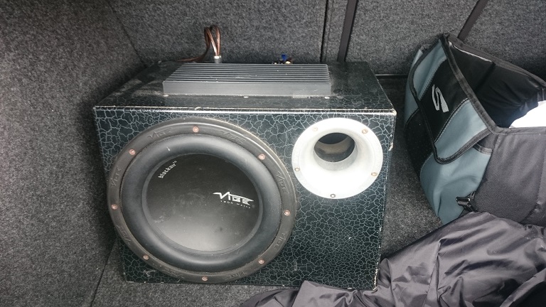

wiring kits in for my sub - a few cuts and swear words, but its in :D - just waiting for my gain controller and work out where i want it then it'll be finished.

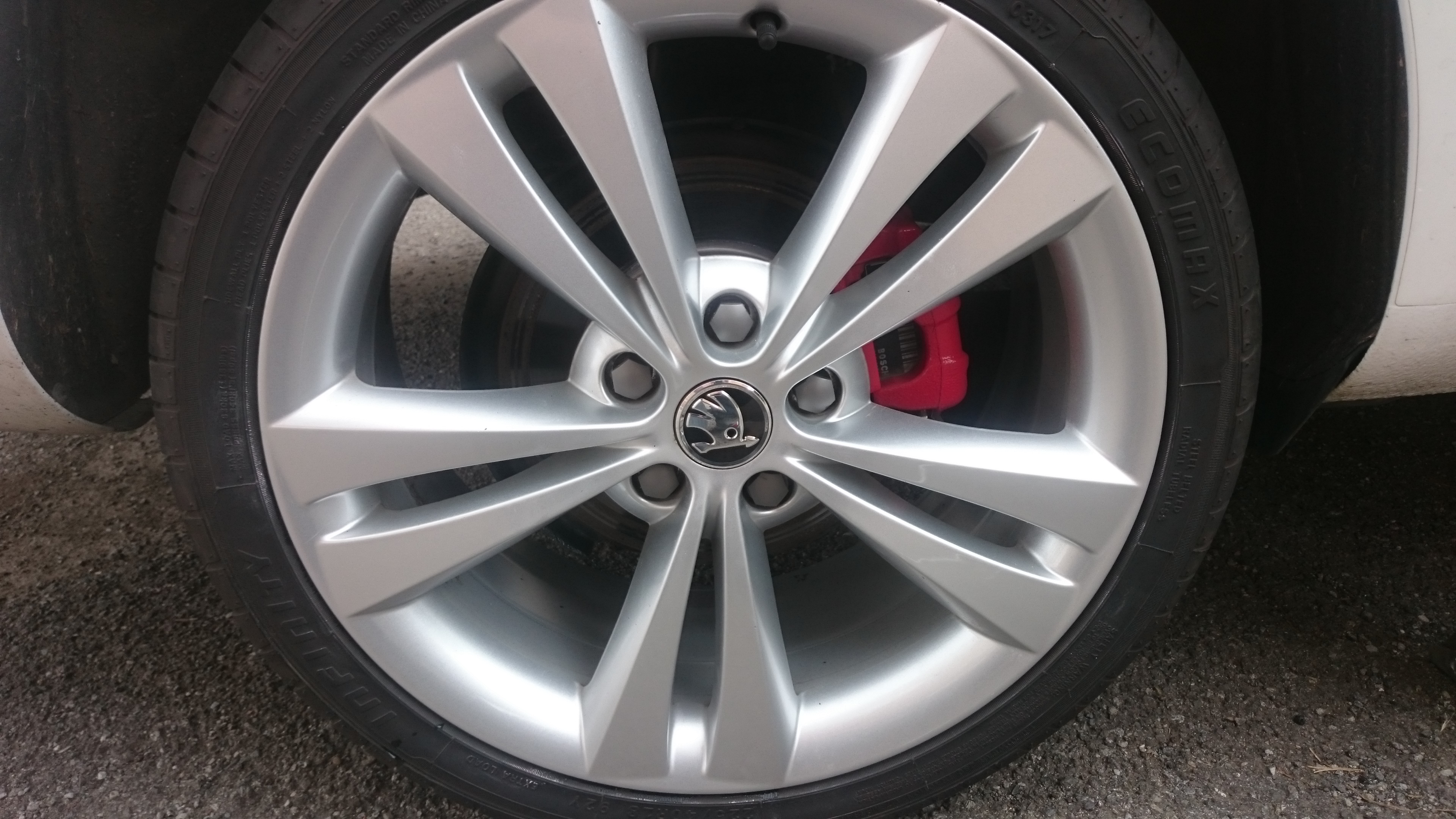

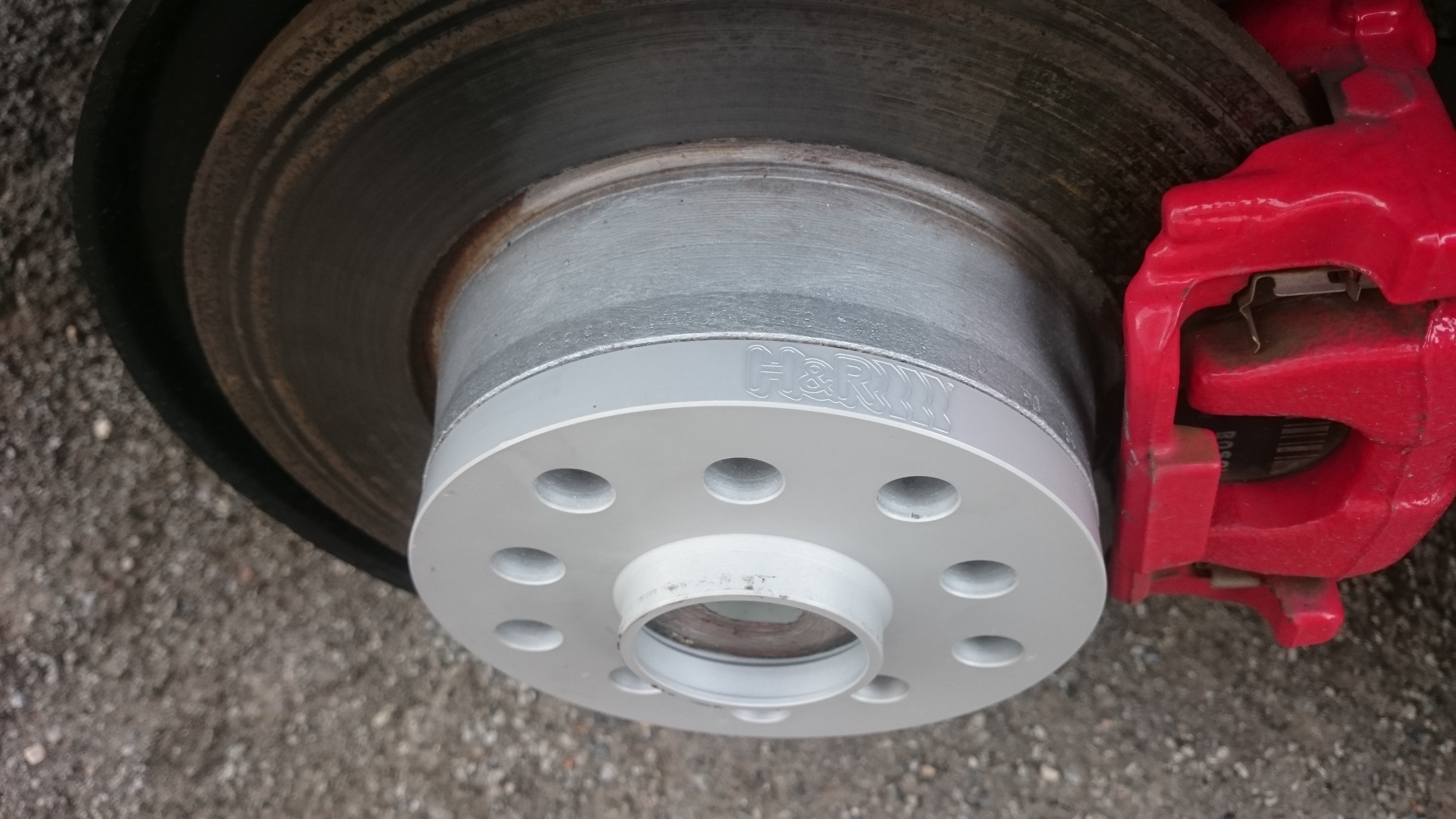

H+R spacers arrived - put them on and it looks much better with the rears now filling out the arch

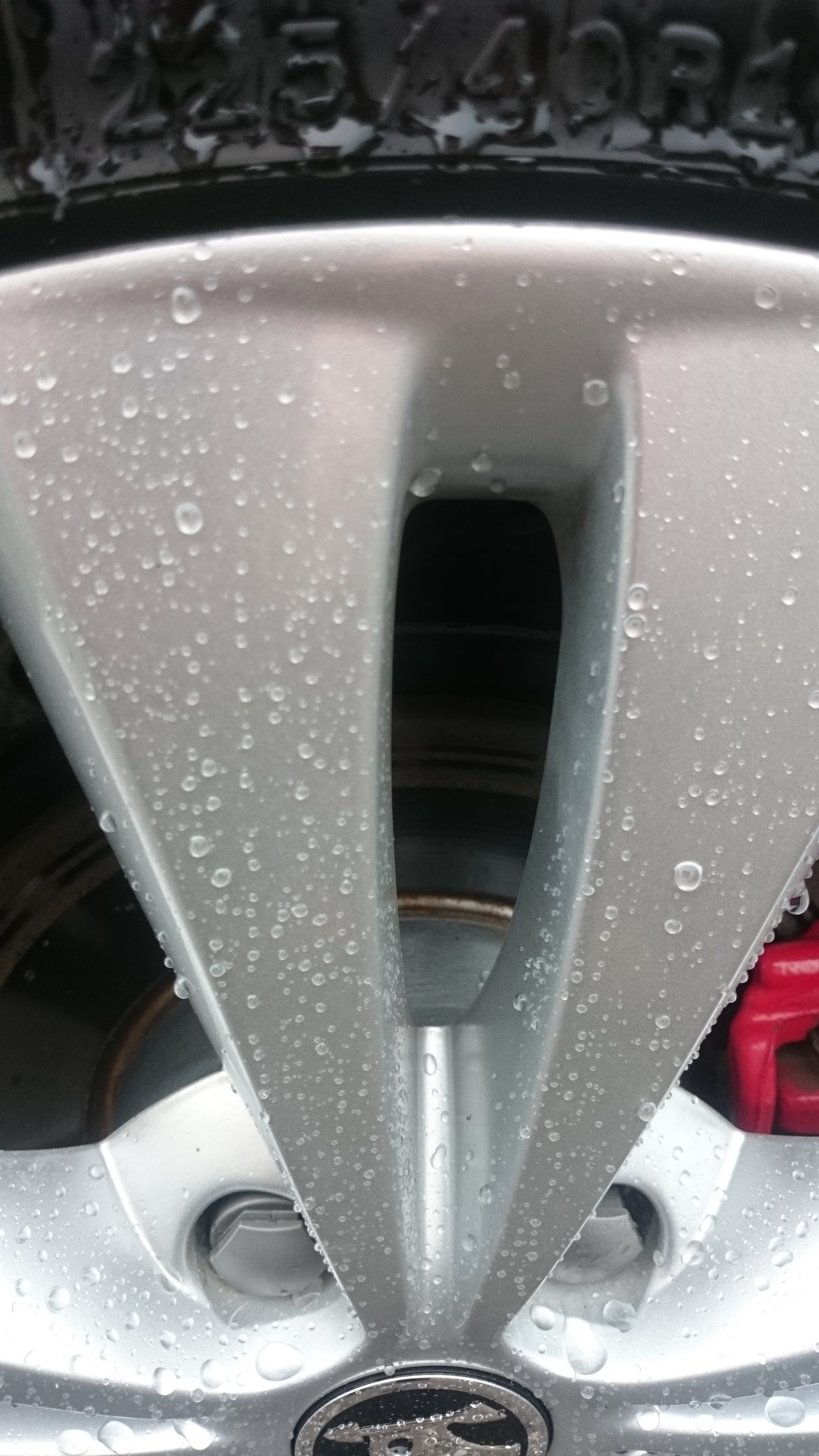

saw some nice beading on my alloys with all the rain so shows the poor boys sealant 2 weeks in is still working well
without spacer
with spacer

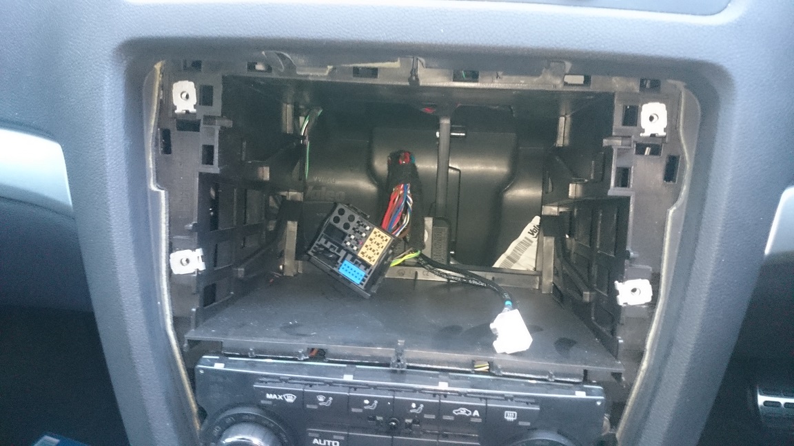

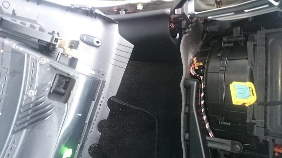

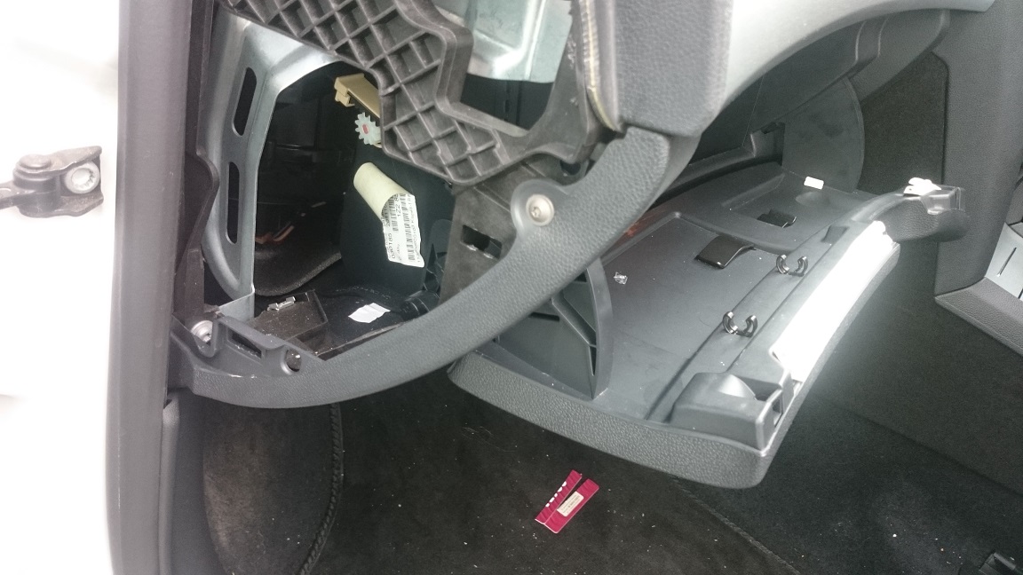

so to carry on from the audio : battery off - head unit out
Glove box out
important bit here, once you remove the air bag switch do not turn on your ignition or put the battery back on or you will have a air bag light on and need VCDS to reset it( im not sure why these two keep inserting rotated but they do and I cant fix it :crying:)

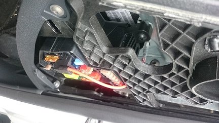

piggy back for the remote using the cigarette fuse as my 12v
Edited by Gissin

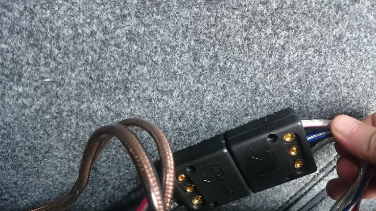

once ive ran all my cables down the inside of the car I decided I would like the option of taking thr sub out  easy, should I need the boot space so in came the vibe fast plug plug.JPG.9ba1309eb8d544f81d32cb3e5ed03f94.JPG

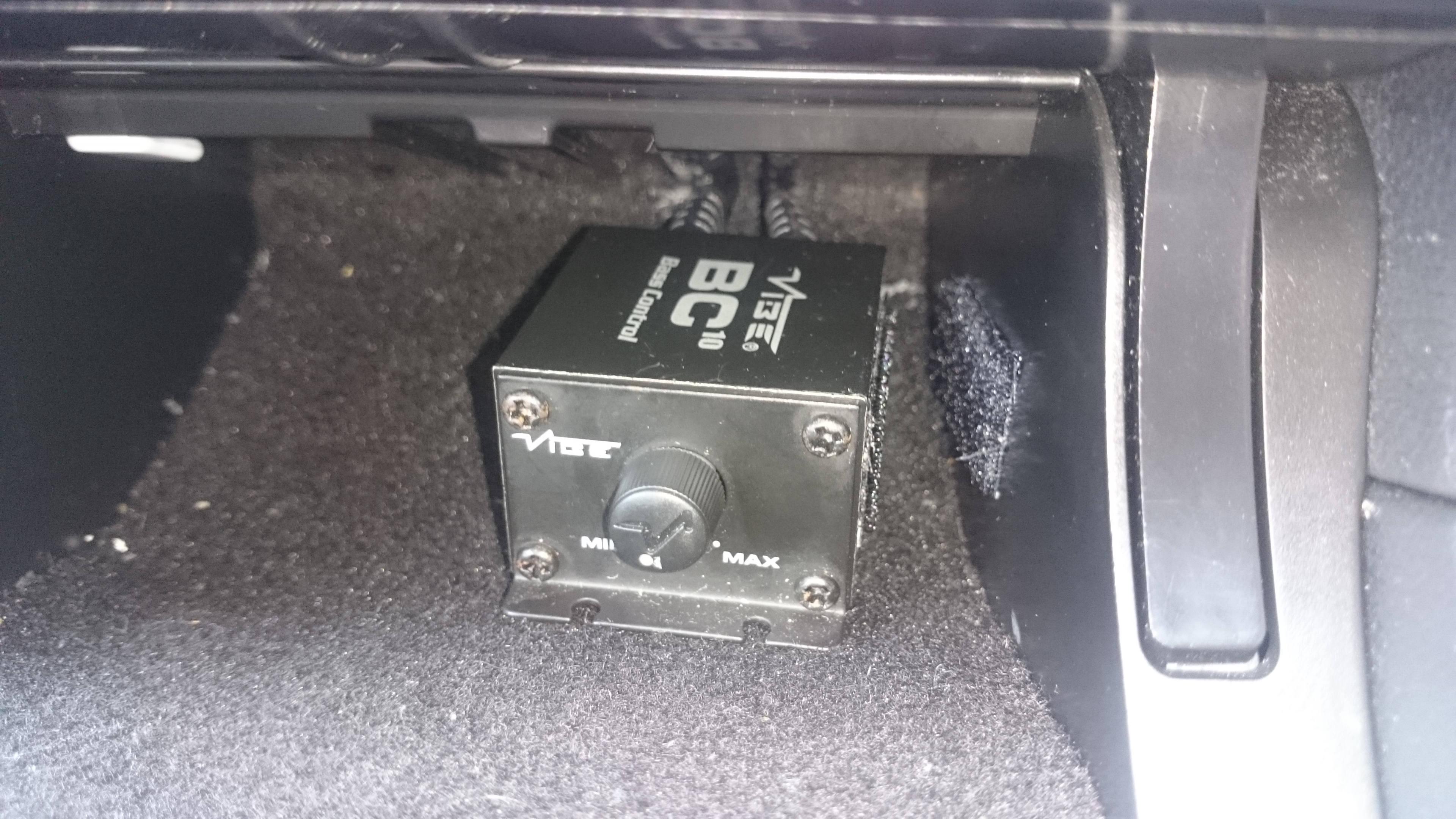

I also decided id like to be able to control the gain remotely for those early morning starts so I used a vibe BC10 which I had lying around from an old install on my Passat, previously I put this in my glove box but I never liked leaning across the car so I opted for the ashtray area this time - connected this up to the rca's once in place, I just drilled a hole through the back, wasn't neat if im honest but you wont ever see it soo..F** it :biggrin:
connected everything back up and amazingly everything worked first time, the sub is nothing special but adds just enough without being too much in your face, however it does need a good clean up

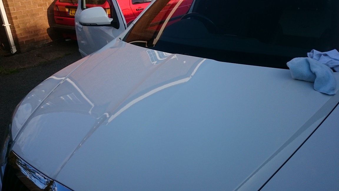

feeling pretty happy  everything worked I decided I'd do a clean and light hand polish too - ended up with some quite nice reflections so naturally I had to take some photos

Are the wind defectors team heko? if so did you buy from ebay? I've seen plenty on the site, but i'm not conviced about quality? Also the wheel spacers. Did you just fit them on the rears? and what size are they?
Best Regards
Marc
15 hours ago, Marc83 said:
Hi Gussin.
Love what you've done to the car so far. Just a couple of questions.
Best Regards
Marc
cheers man, still got a long way to go though :blink:
yes, they are team heko quality is fine on mine, fit well and haven't moved ( I don't have the metal clips in either)
yes rears only as the fronts sit quite well already but I may put a small set on at a later date - mine are 15mm each so 30mm over the axle

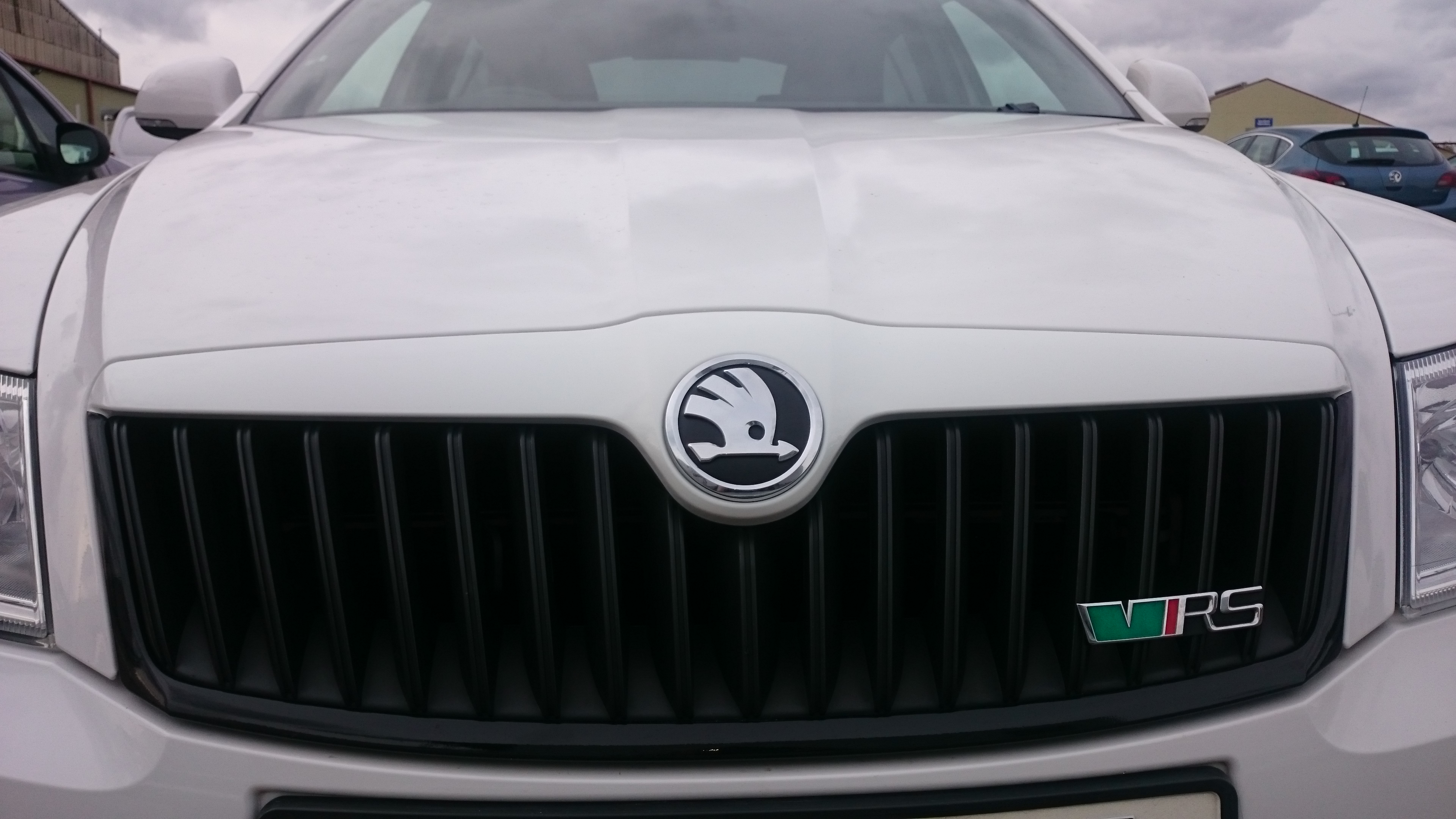

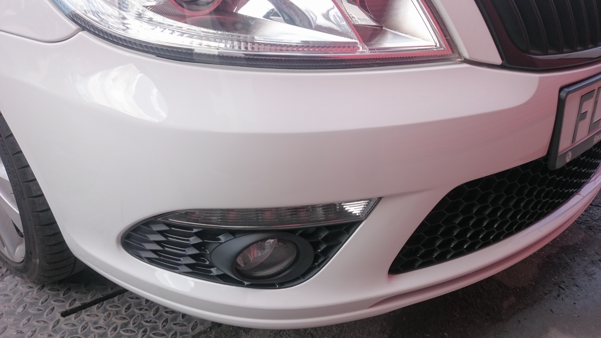

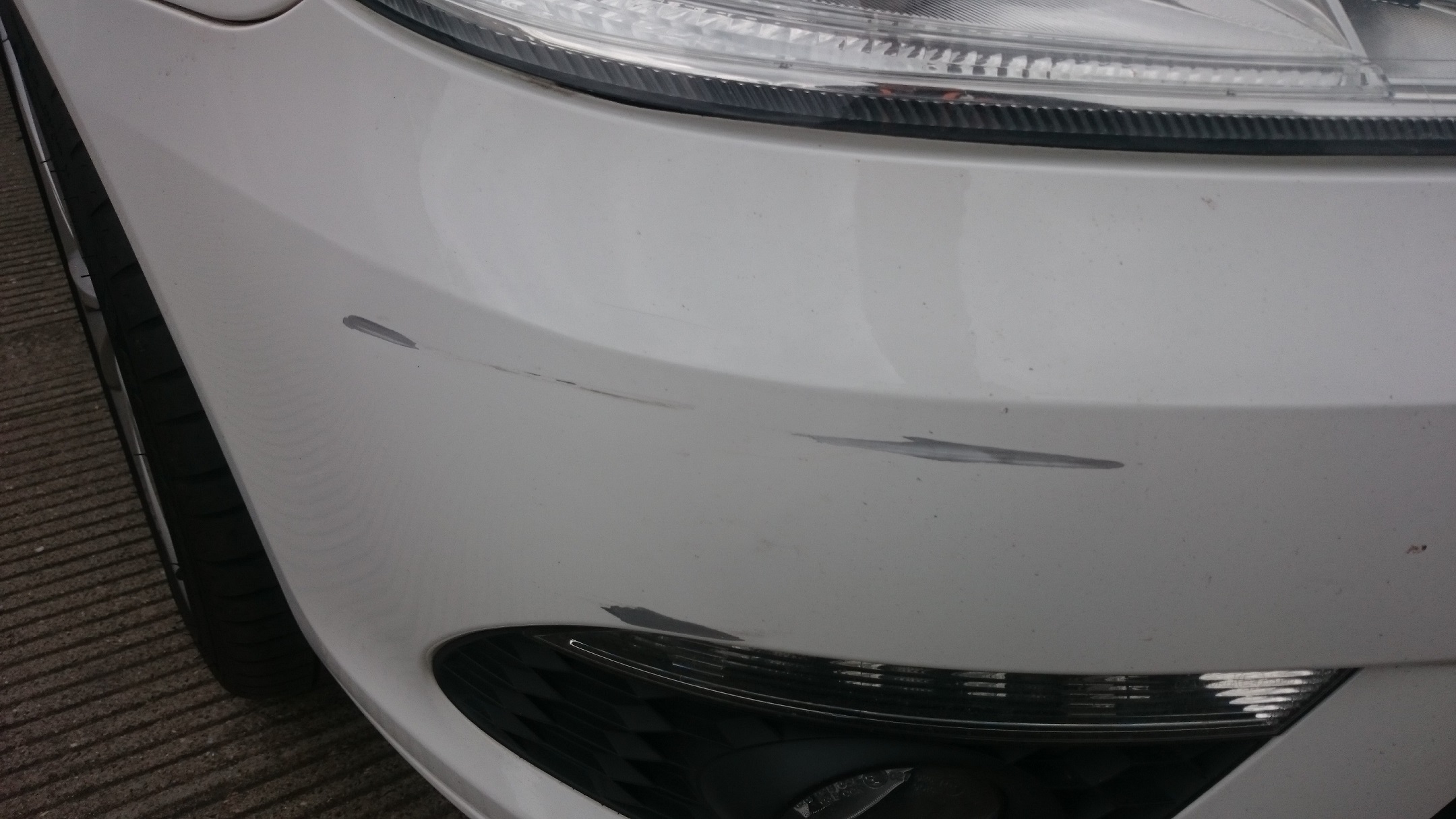

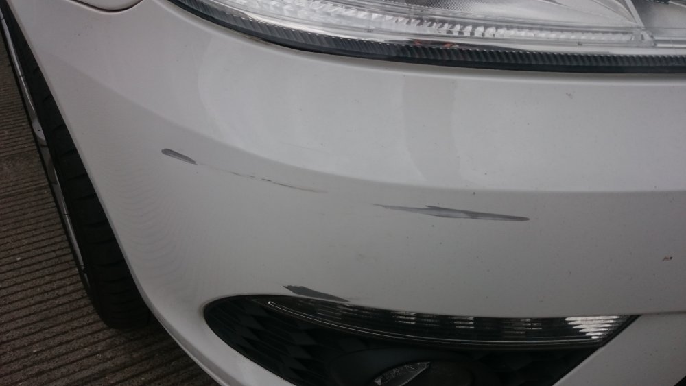

opted for having the scratch repaired and ill let them do the grill at the same time, two tone white and black - t minus 4 days
cars in the garage, thought about doing it myself but I'm rubbish at spraying.
going to have the b pillars done and thinking about a black roof at a later date too
well the cars back and looking good
big fan of my new grill think the two tone looks good, just need to fit my new badge on now 59d72ccdd1b99_grillnew.thumb.jpg.c130d93498fca12704886ba150bfd5f9.jpg

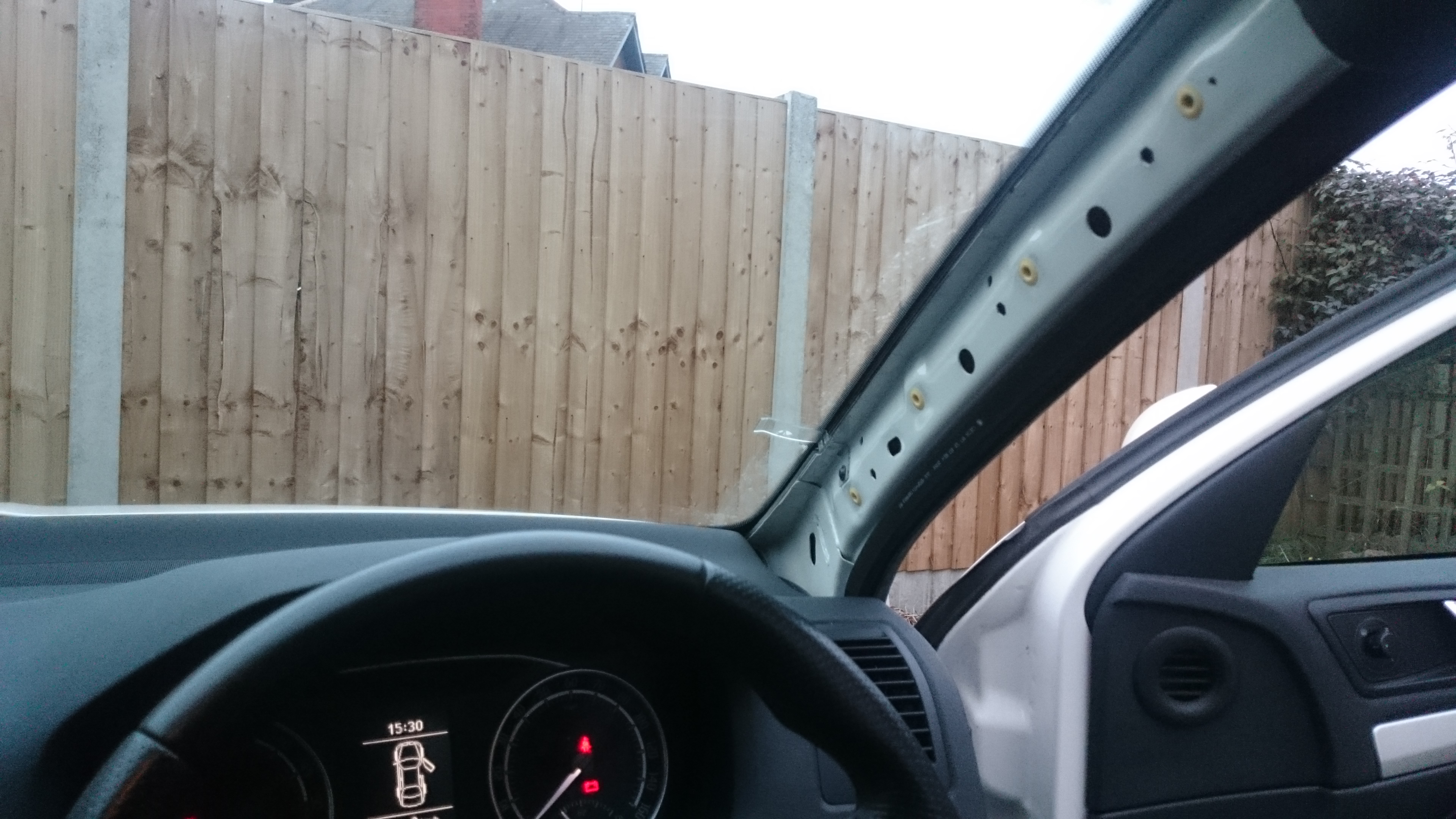

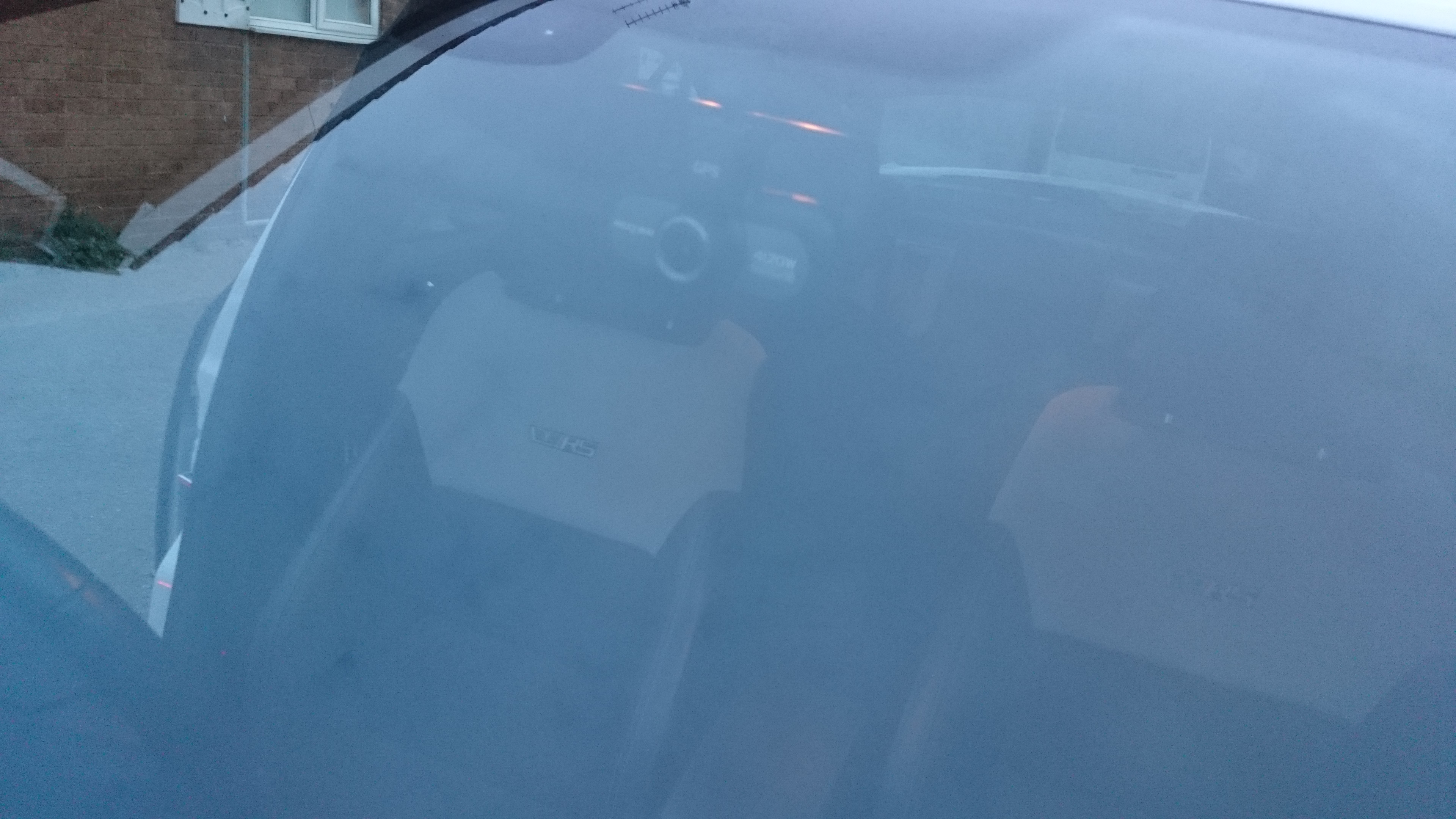

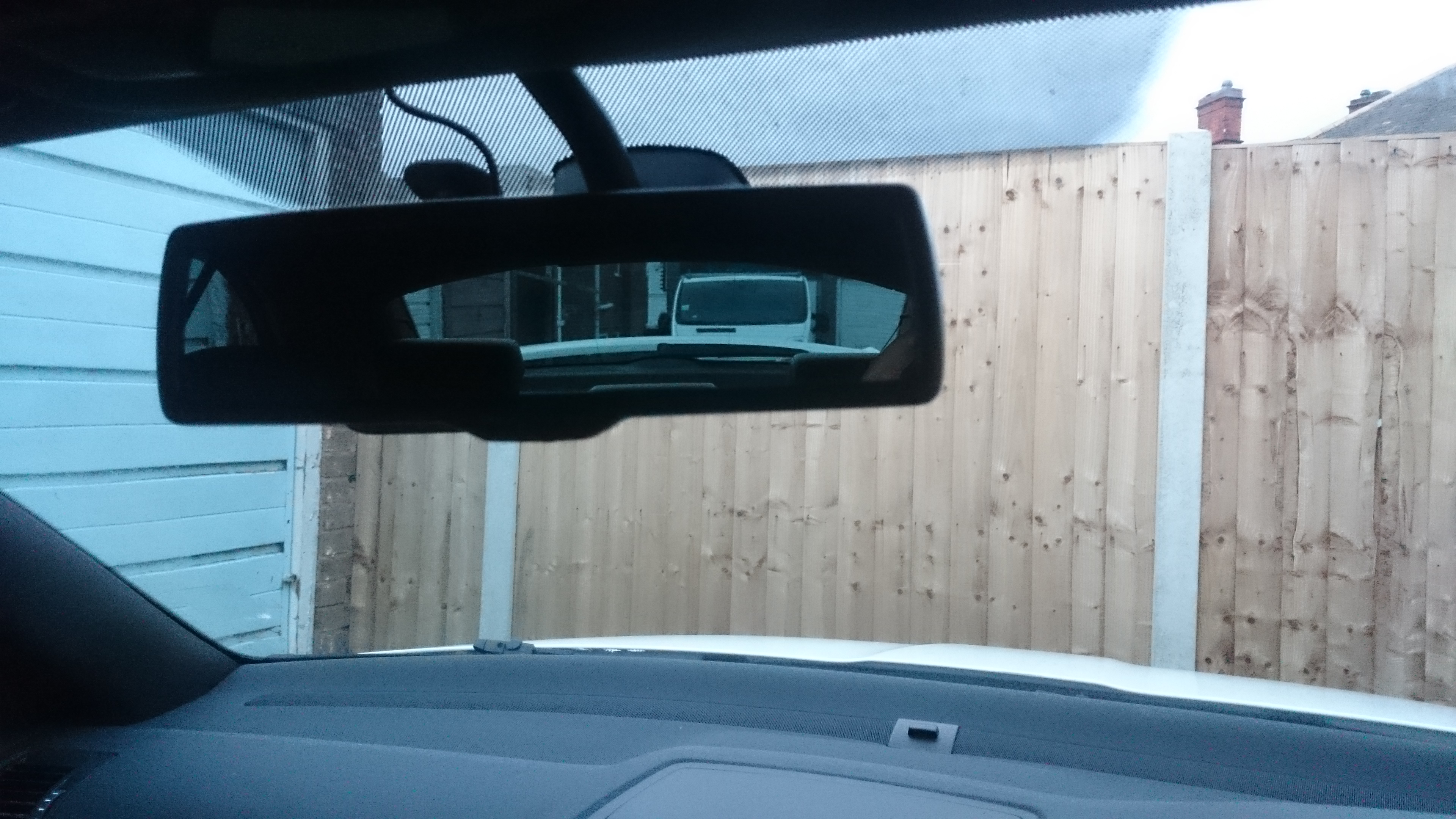

fitted my front dashcam (hardwired) - finally ...after doing my GF's car  first and her peasants 2 cars after that.
fitted my Briskoda window badge
Brought a wheel polishing set (drill sponges and cotton cones) - for when I take the alloys off I can deep clean and put 3+ decent coats of sealant on
fitted a full set of waterproof covers for the seats

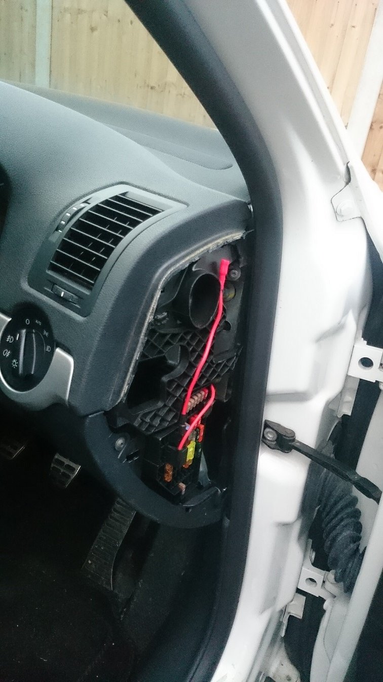

(Hard wired using the rear wiper fuse)
(A pillar off and run the cable up the side closes to the glass)
(push the cable into the gap in the headlining and found a nice position for it to be hidden by the mirror, reduced the cable and now sits next to sensor tube)
