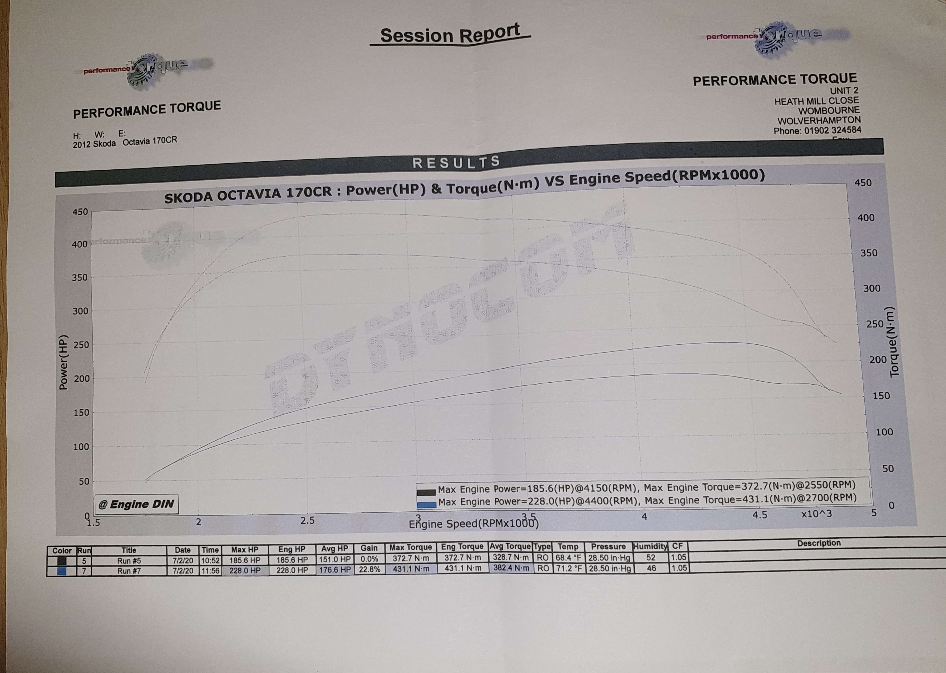

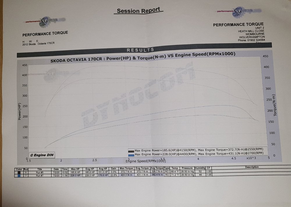

2 hours ago, skinnyman said:
So, were you happy with the results?
super happy, will  spent a good 3 hours on it.
the car was running really well and very clean (guess all the motorway miles / good fuels and cleaners do help) so ended up pulling 185 non mapped
delivery of power is very lineal and a really smooth in all the gears ..wish I had done it sooner  😅

new figures
228bhp
431.1nm (317.8 ft lbs)
11 hours ago, Gissin said:
new figures
228bhp
My fag packet maths makes that an increase of 43bhp and 43ft lbs.  I bet it feels like a different car now.
fag packet maths.. not heard that one for a while, manufacturing or construction by any chance ??
yeah it's much better to drive now, very similar in stock delivery, just that power seems readily available now- 3 and 4th are a lot of fun!! 20-50 in 3rd is almost instant :rock:

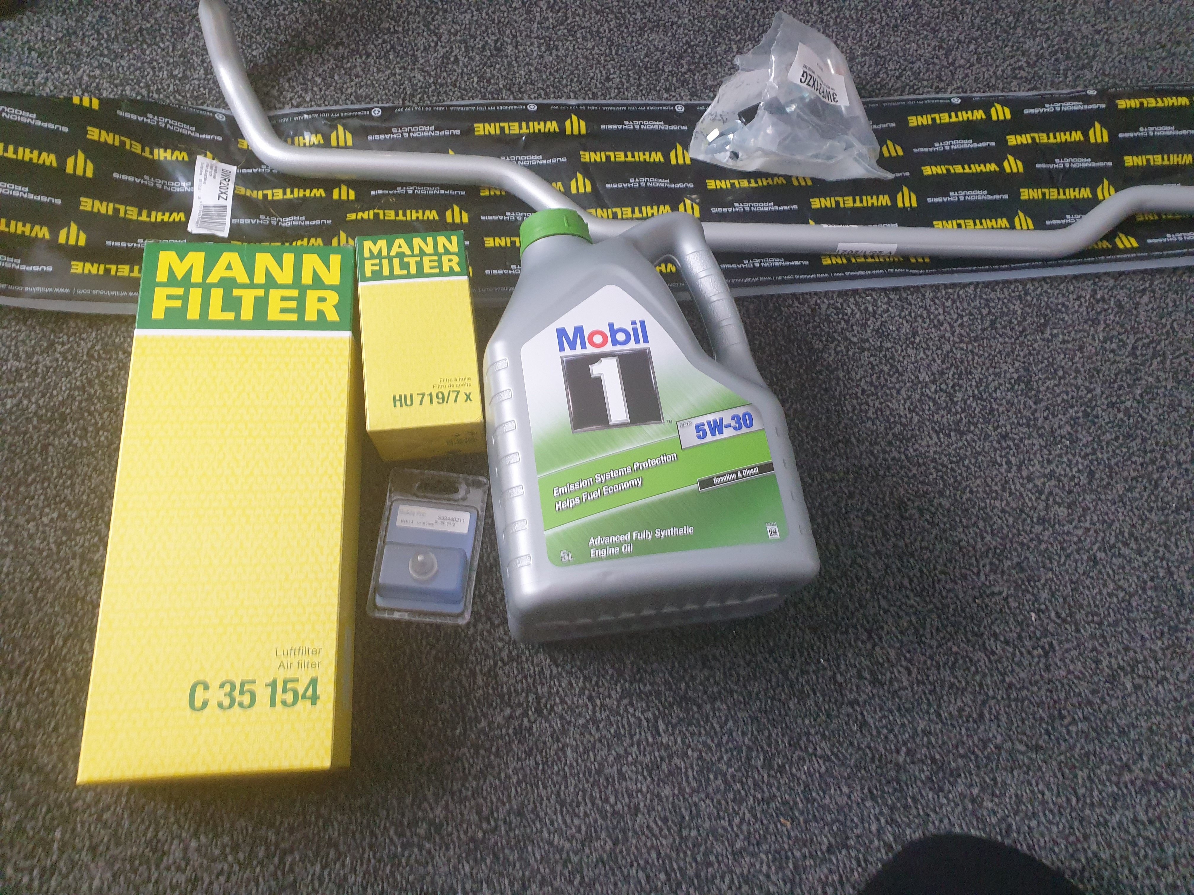

noticed my service was due when dropping it off so got some parts ready for when I pick it up.
top service from ecp, ordered at 10 last night, delivered by 10 today (free 4-5 day service)  👍🙆‍♂️

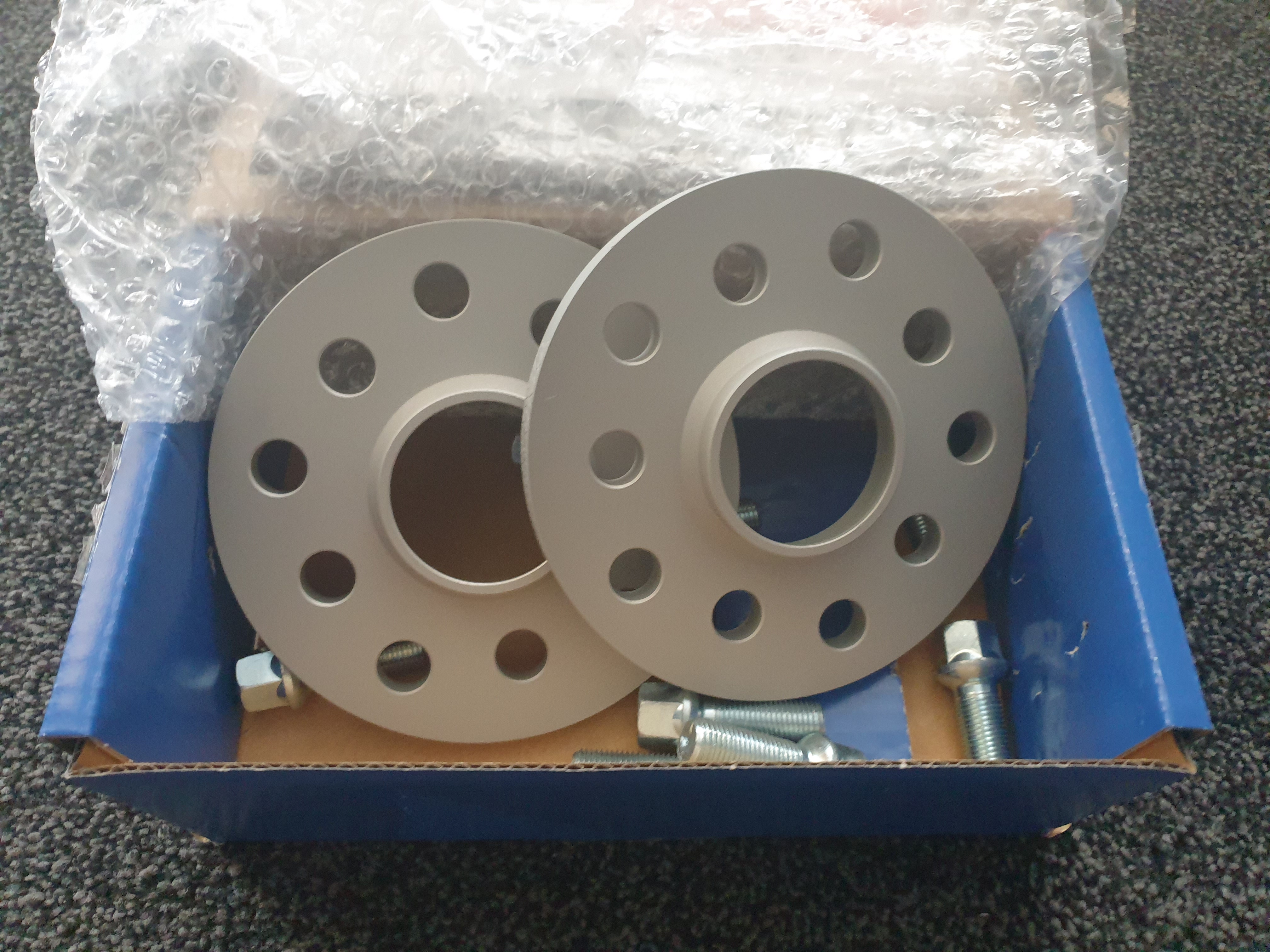

New front HR spacers ... I'm going to be busy this weekend :rock:
cars back
spacers fitted

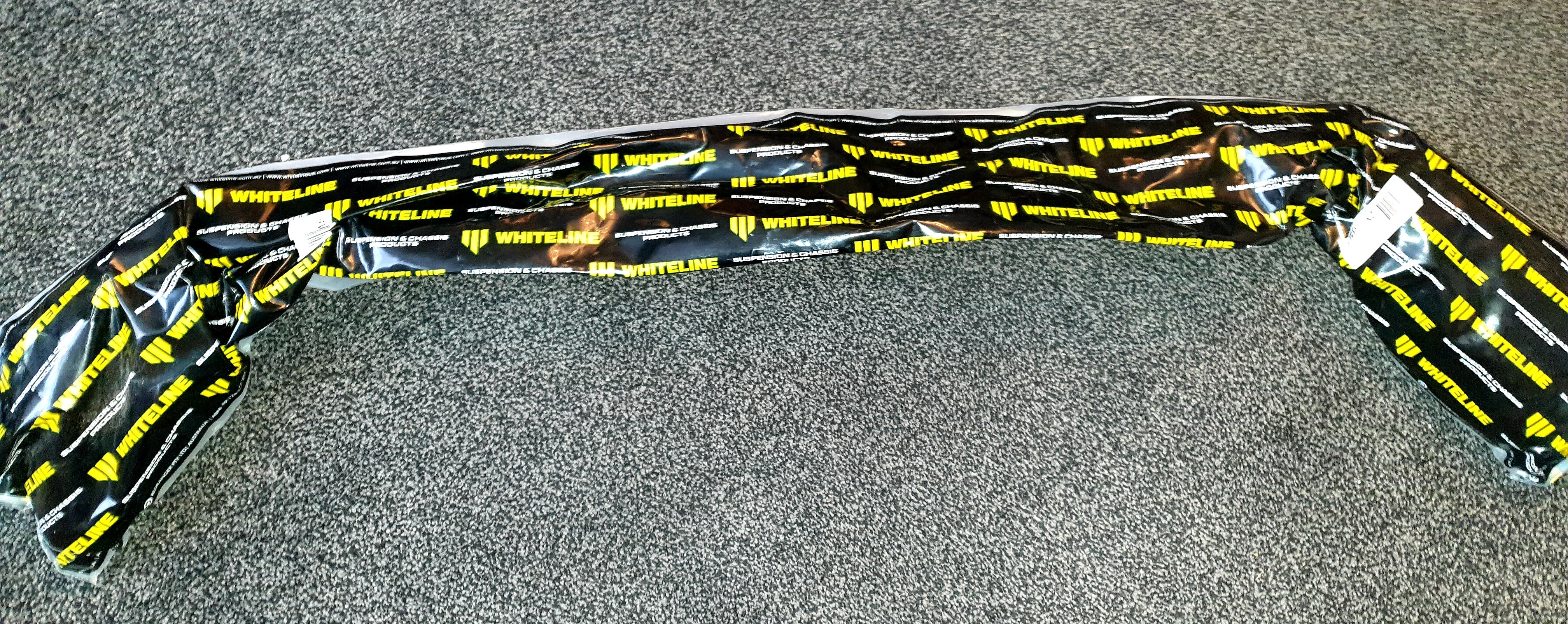

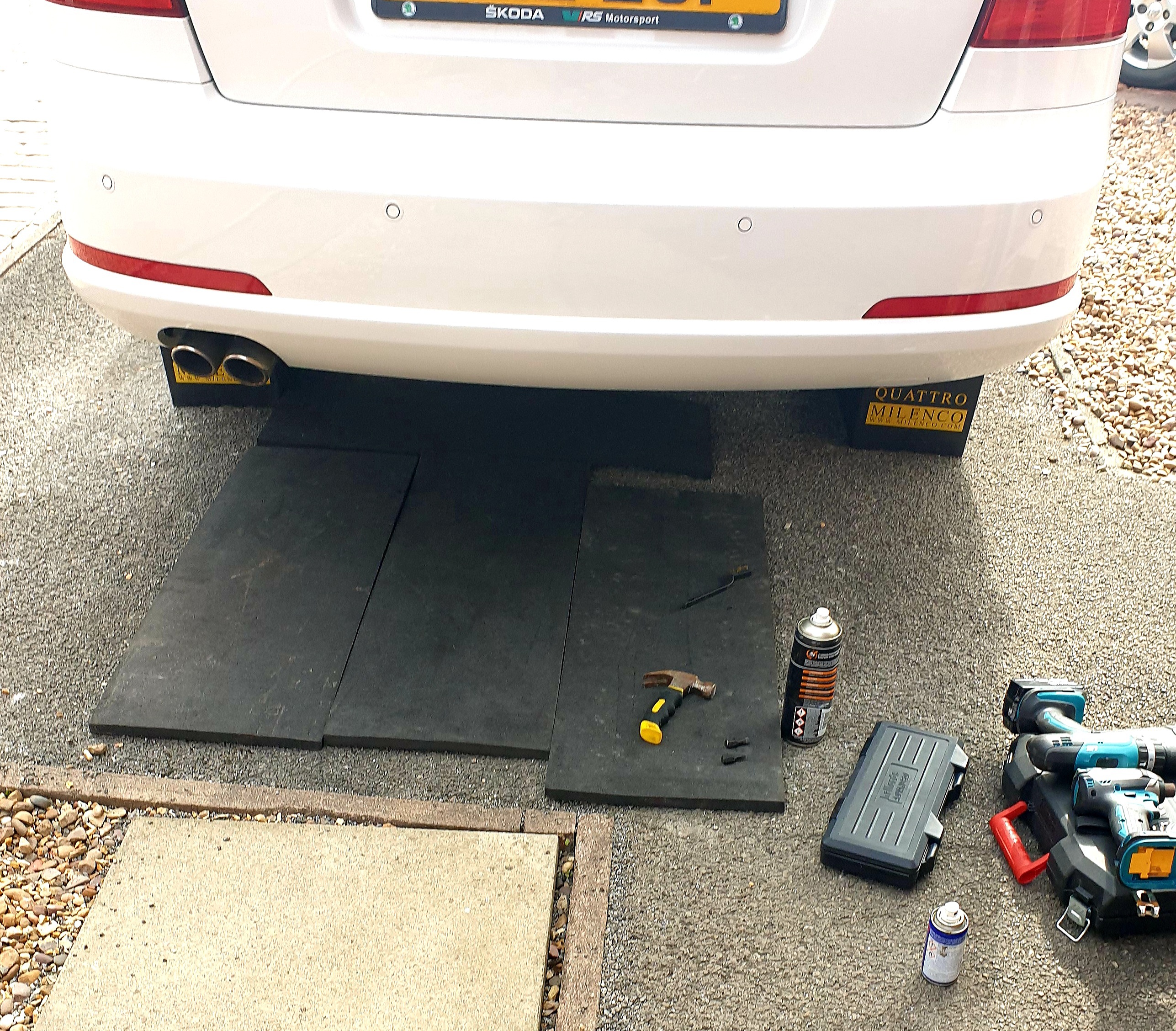

starting work on the rarb
skirts and service can wait till this weekend
Edited by Gissin

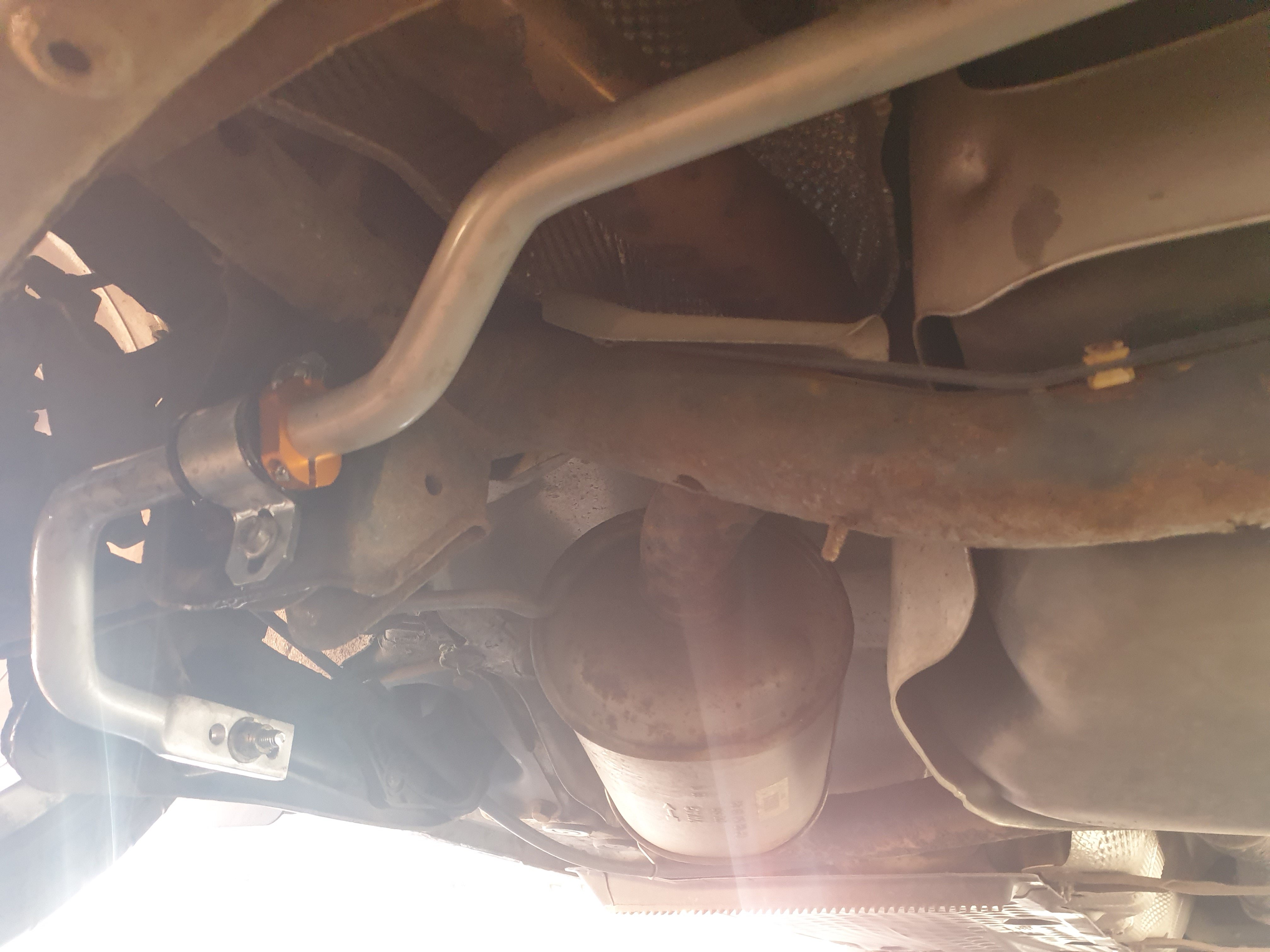

rarb on :muscle:
deffo needs a wire brush and paint under there but that's a job for another day! enough rolling on the floor for today :biggrin:
bit of an update, RARB on medium setting is awesome! pretty much eliminated body roll, now the weathers getting warm I'll give it a go on hard setting

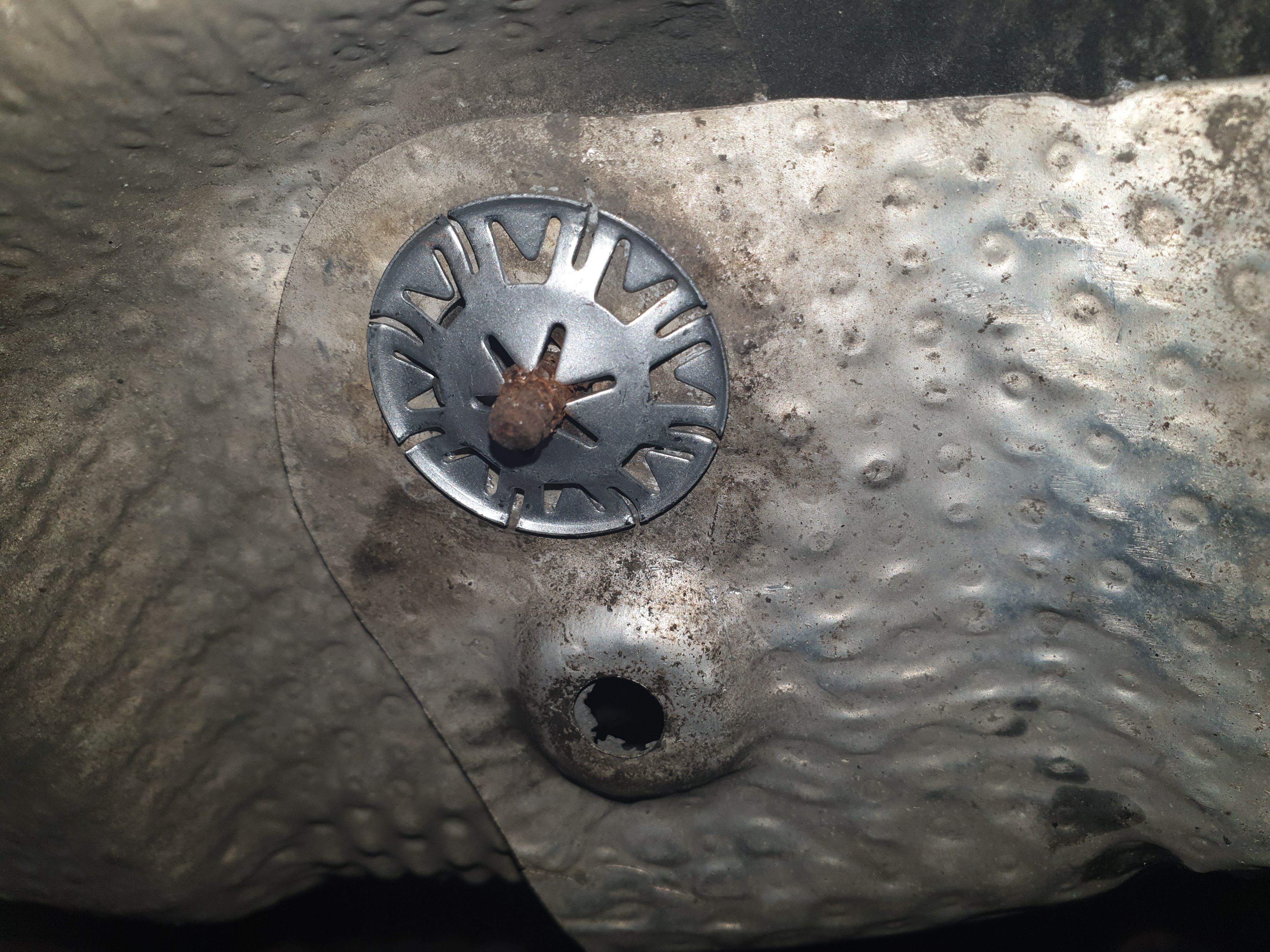

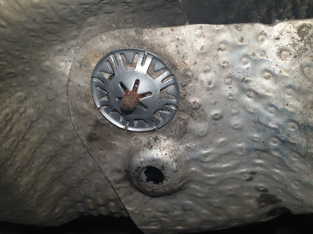

I've noticed a rattle from the rear end of the car sounds like a loose heat shield (possibly disturbed when fitting RARB) so hoping just a star washer fix.  need to get back under it to check all the bolts are still correctly torqued anyway. I'll give a wire brush and waxoyl whilst I'm there too.

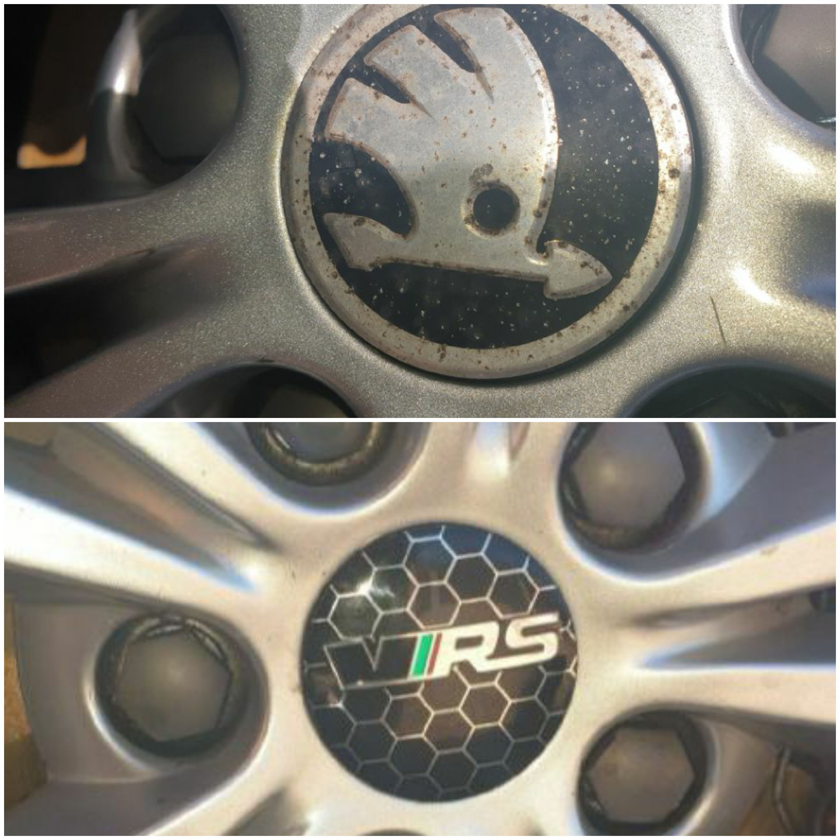

ordered these as I thought they looked cool and the wheel centre caps I currently have look a bit worse for wear... either the wheel cleaner I used has degraded them or they're non genuine.
Edited by Gissin
that's better
yep was a loose heatsheild, all fixed and now nice and quiet again, stuck a but of heat mate over the area to stop any further conrrosion

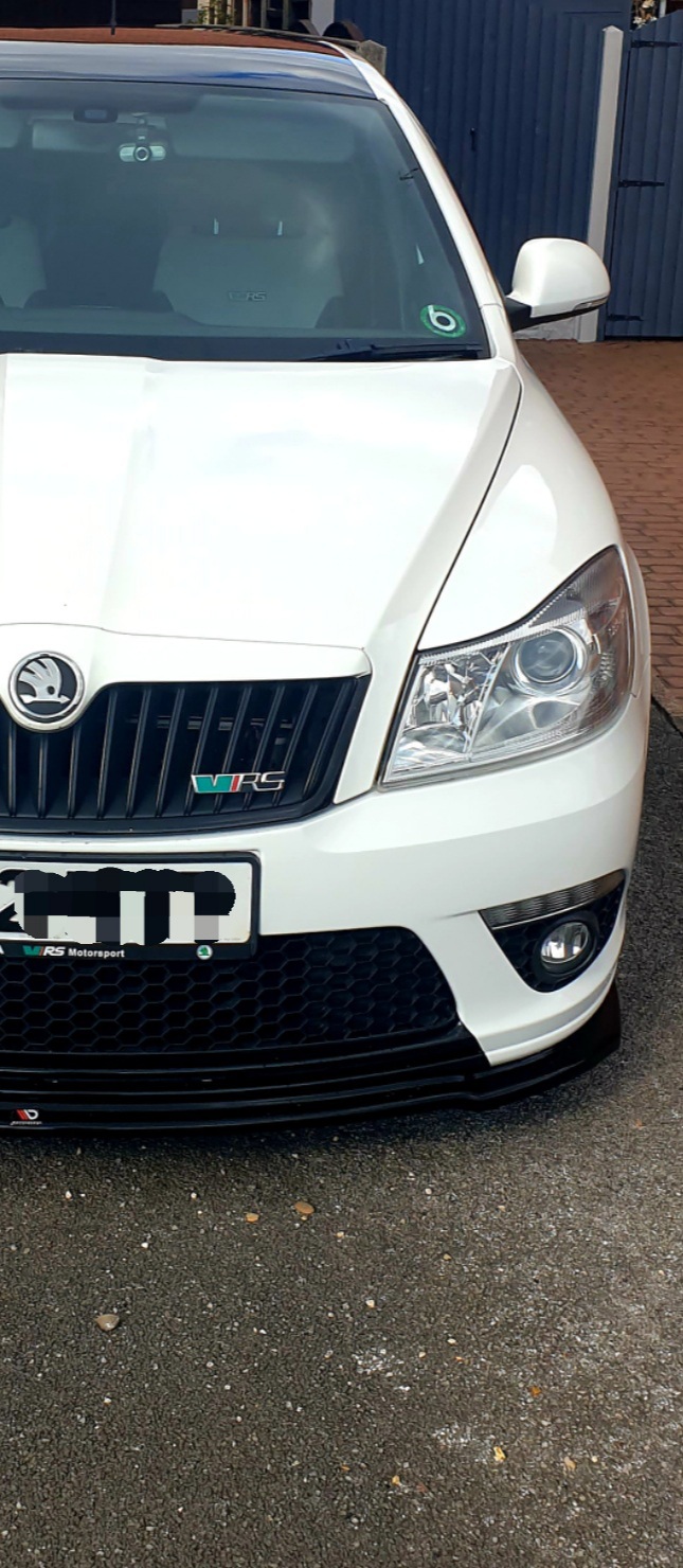

been busy putting a new kitchen in the house but thought it was time to update...
splitter and black roof looks awesome
Edited by Gissin
