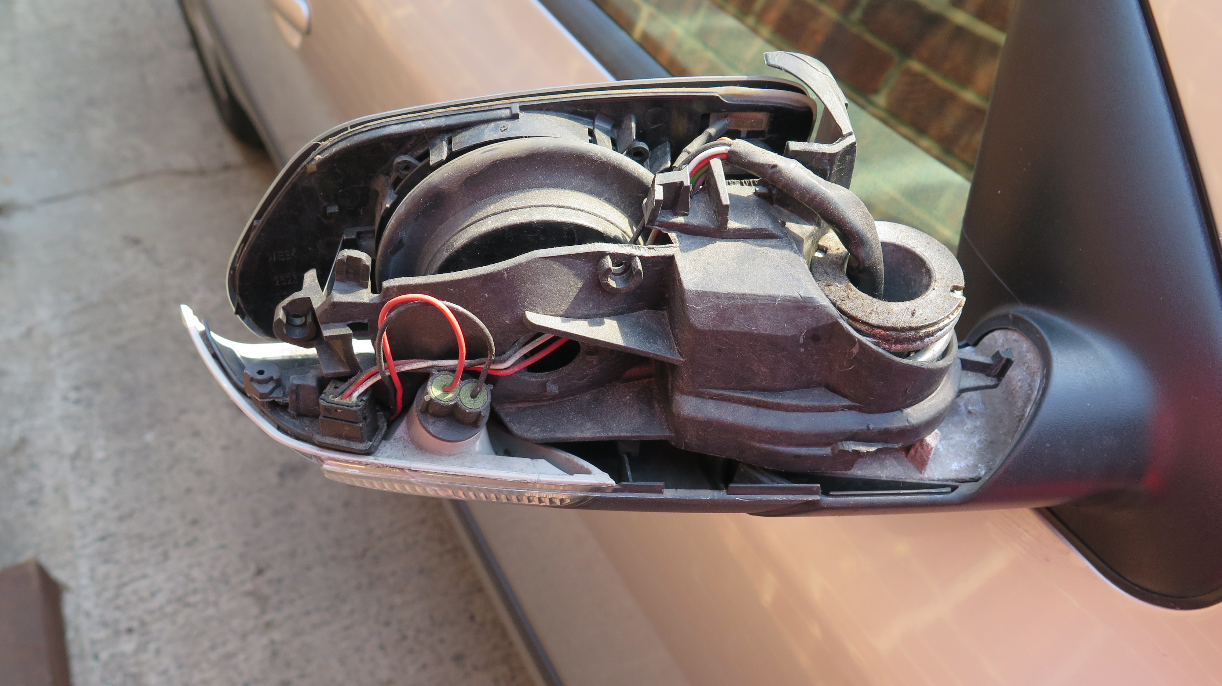

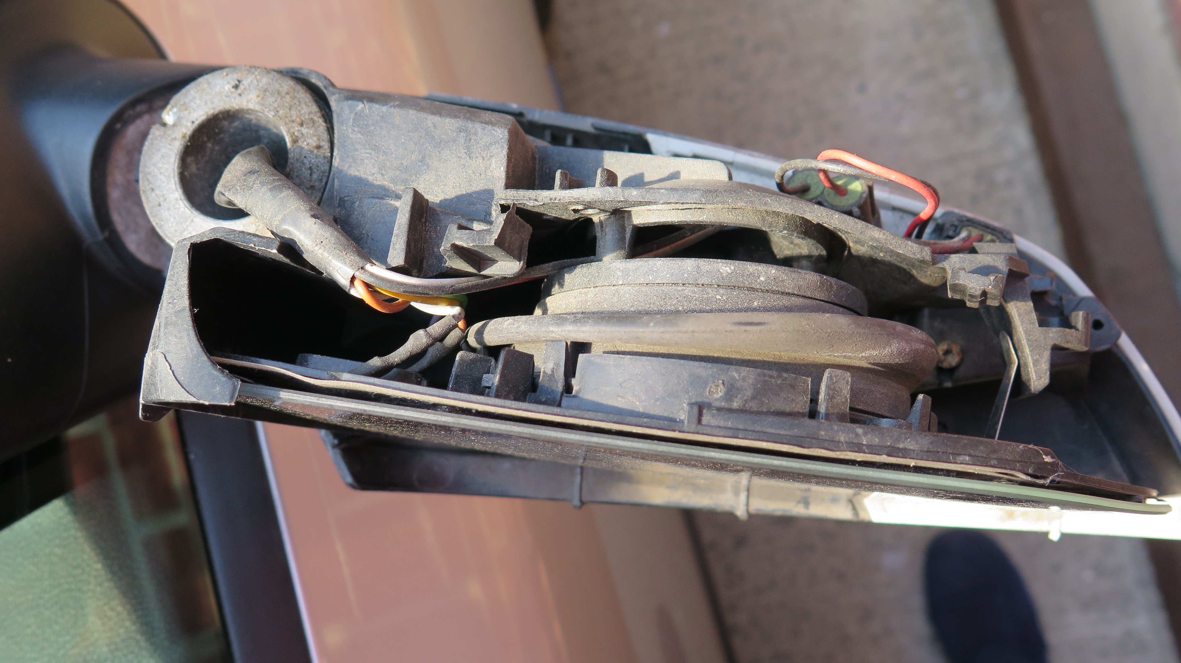

Came out of shops today to find that some *#@& had clipped my drivers side mirror and smashed it - really annoying, as they were bound to know they had done it. I took the car to the Skoda dealer for an estimate for repair & they want to replace the whole unit for £378. I nearly passed out, some people only pay that for a car. My insurance has a £100 voluntary excess and a £95 compulsory excess.
I've since had a good look at it and it looks like only the shell (both top and bottom parts) is broken & after seeing a YouTube video, it seems easy enough to replace those. The glass is still good and the indicator & puddle light still work. Does anyone know where I can source the parts I need, either online or local to Durham, and is it really as simple as it looks?

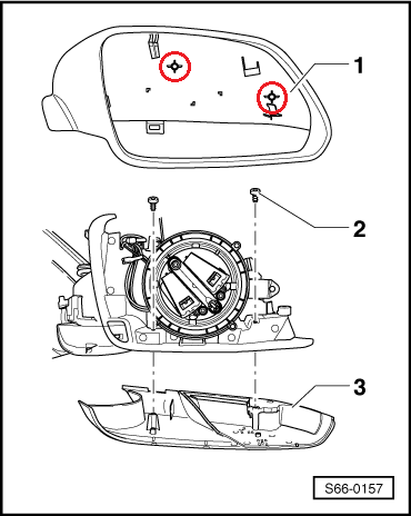

Seems like a pre fl model. I thought you could find one on eBay within 20 pounds?
Installation is quite easy. There are 2 or 3 screws(red circled below).

Thanks. I've ordered one from ebay for under £30, not quite the exact colour, but it's a 9 yr old car so it won't make too much difference to it's value. I only need the shell as everything else works fine. What I don't use, might come in useful another time.
