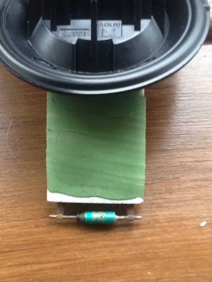

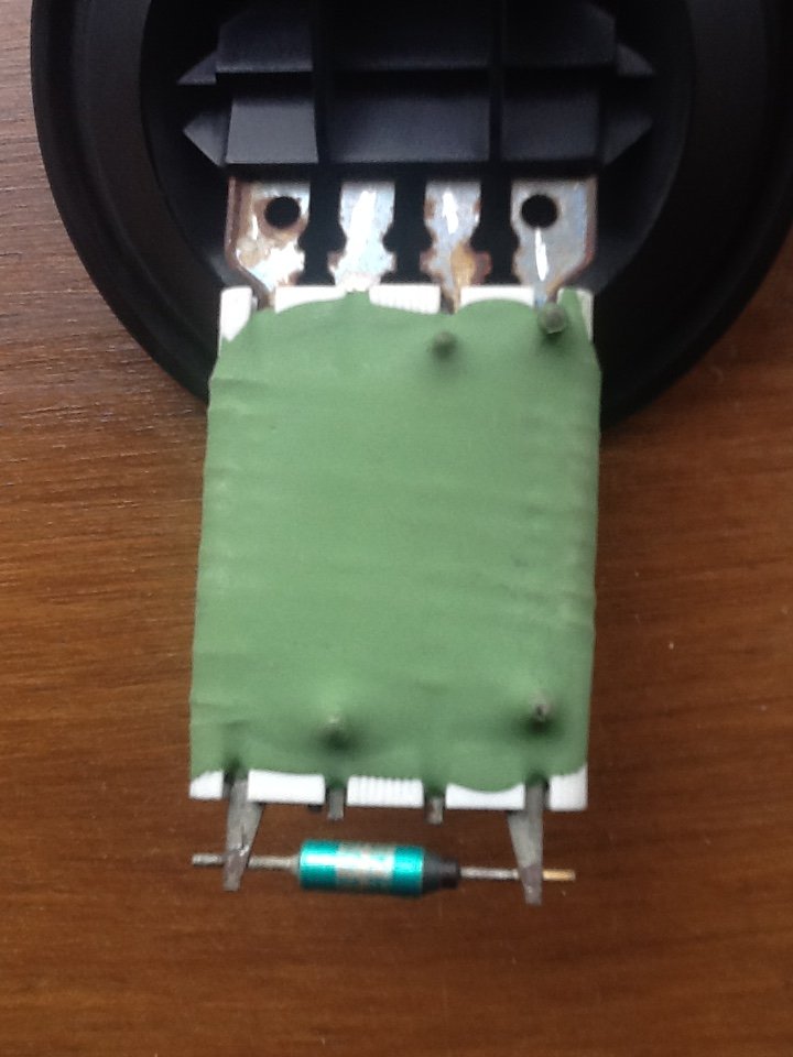

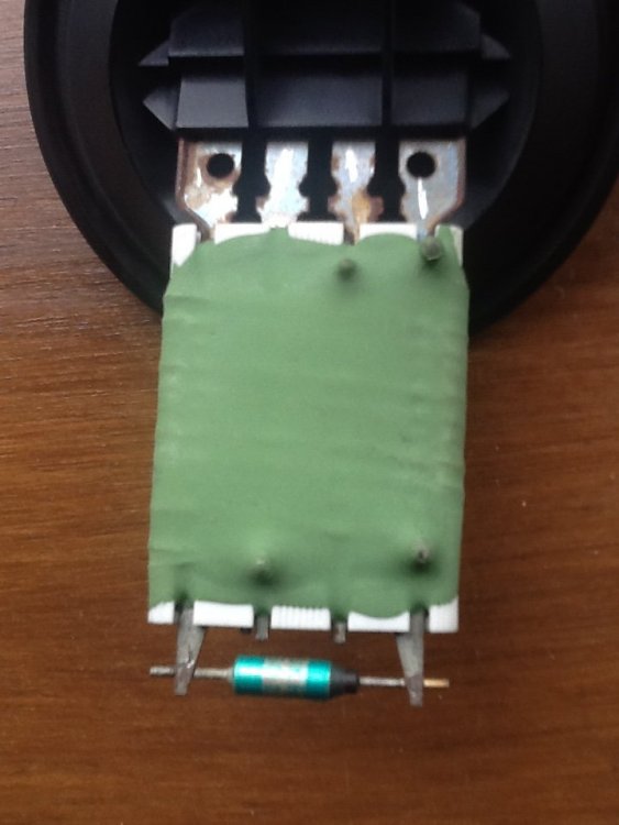

Well, took the thing apart again today to compare the resistances of old and new resistor packs. Old pack was open circuit from pin 2 to every other pin, which is to be expected as that is the low speed setting according to the diagram Wino kindly posted.
All other readings were identical on each resistor pack.
I gave the contact pins on the new resistor pack a good scrub with my fibreglass pen and refitted it thinking I would do as Wino suggested and use VCDS to check the motor voltages, but the thing works!
Not sure if I had a high resistance connection on previous fittings but I am sure the low speed fan setting seems faster than when I fitted it yesterday.
