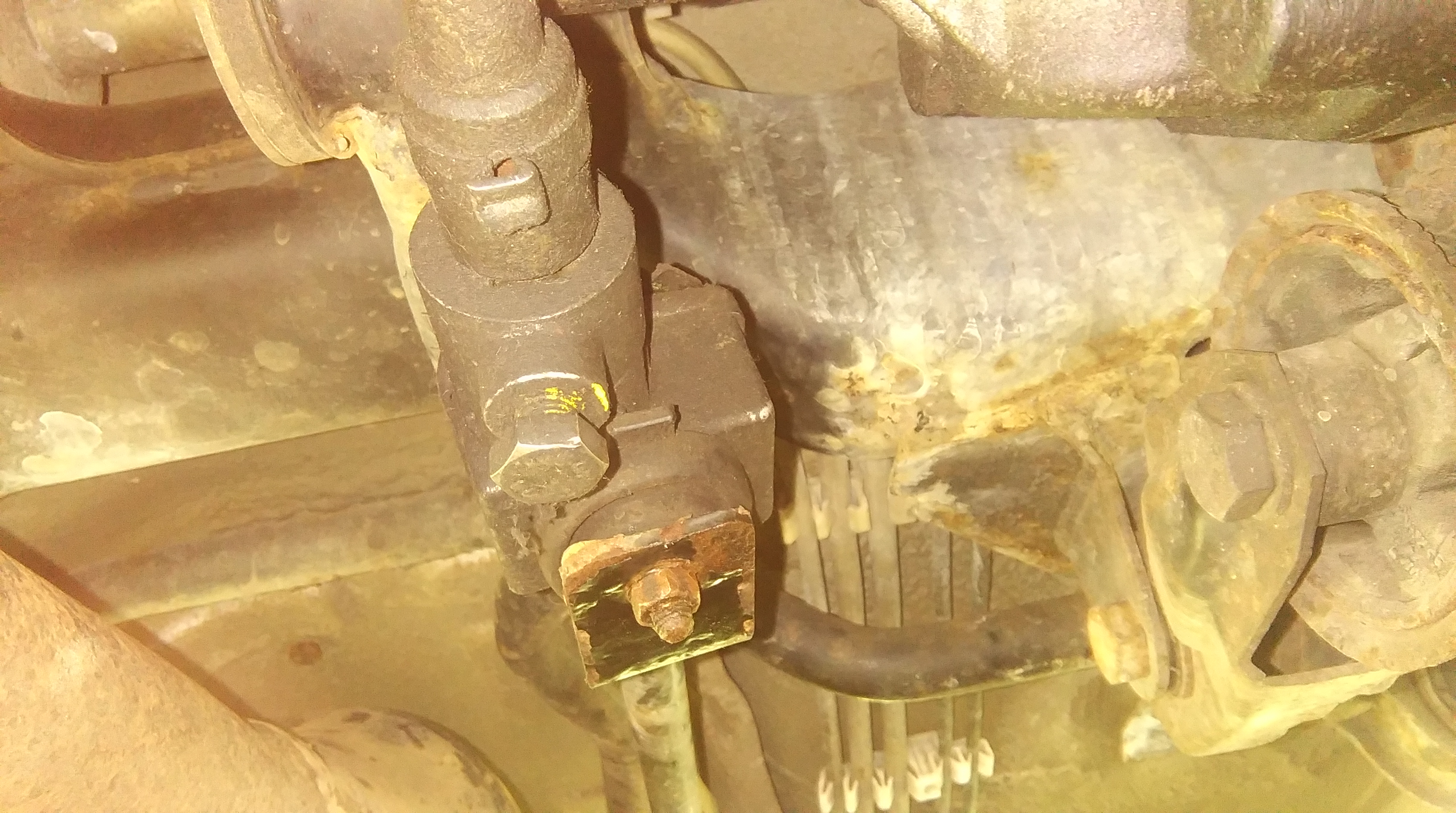

The gear linkage has play at the gearbox end. The bush and connection is different to the 1.3. I am ready to take it apart, only thing is , I have no part number (skoda or equivalent).
So does anybody have the information or a link to parts for 1.6 linkage? Or, maybe an easy fix, if the part is unavailable.

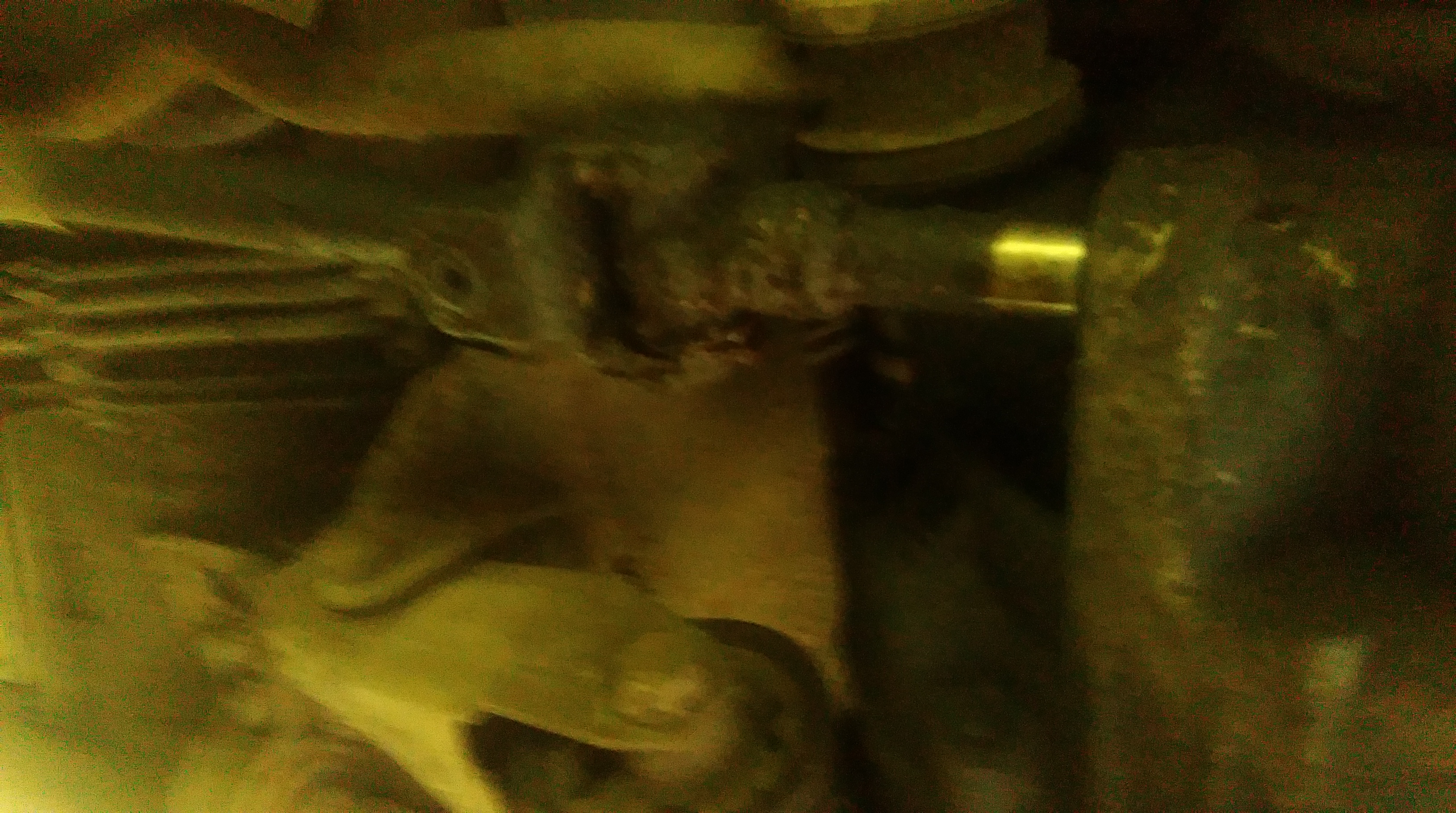

I have loaded photos of the1.6, it's linkage and a 1.3 linkage for comparison ( the dirty one) .....Thanks Antony.
I don't have part numbers, but the 1.6 engine and gearbox are the same as in the equivalent VW Golf 1.6. The linkage will be "a bit different" probably since I doubt the lever pivot is in the exact same position relative to the box.
Ken, thanks for the advice. I'll look into it. I have a feeling that the1.6 Golf had a different gearbox and linkage.  Any lead is a good one. Pod.
I now have an idea of which part I need. It seems to be 893711615a. See photos below. Anyone who knows where I can get one ,please let me know on the forum.
This is not 1.6 exlusive linkage, it's just older type, before -97 modification.
Felicias gearboxes are all almost identical, so you can fit whole linkage from 1.3 - I think this is easiest fix. Just look for post-97 one, as some early 1.3 linkages dont have bent for antirollbar.
I can't help you with part - even in czech republic is hard to find original bushings and chinese won't last for long.
