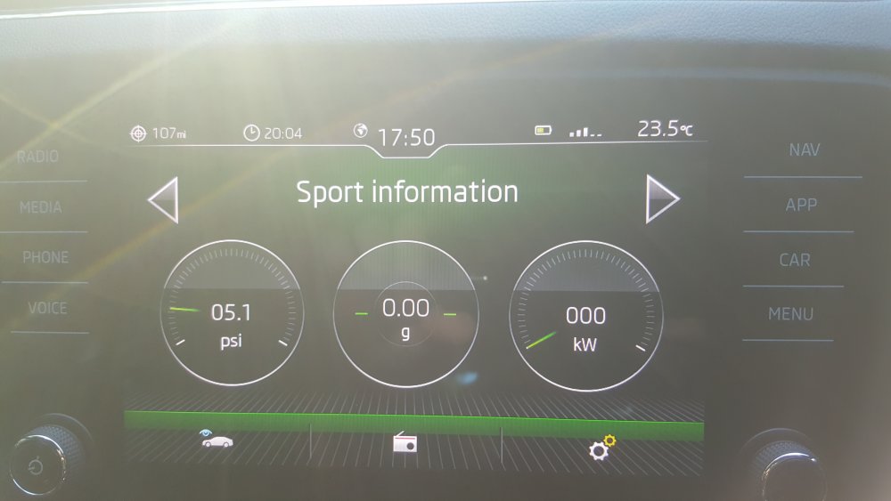

What this one ?

I have RS220 (162TSI) and have enabled the laptimer in the maxidot, using OBD11 - but been unable to get it in main infotainment screen, NOR can I enable the "performance monitor" as the picture from @themanwithnoaim posted.

How does one enable this with the Amundsen head unit. Same as this I guess. Octavia MK3 RS 230
This screen above is a SWaP feature - not possible to enable with VCDS/OBDeleven.
SWap stands for Software as purchase, which means you need a code specific to the car in order to activate/enable.
So basically not possible? I think I’ve seen some guys who have this. Have to find out how it was activated.
It is possible if you spec it with the car and I guess it is possible if you have a car that supports it and purchase the license from Skoda.
I have seen some reports of success stories in enabling via coding the Off-road screen, but the Performance one, is not possible.

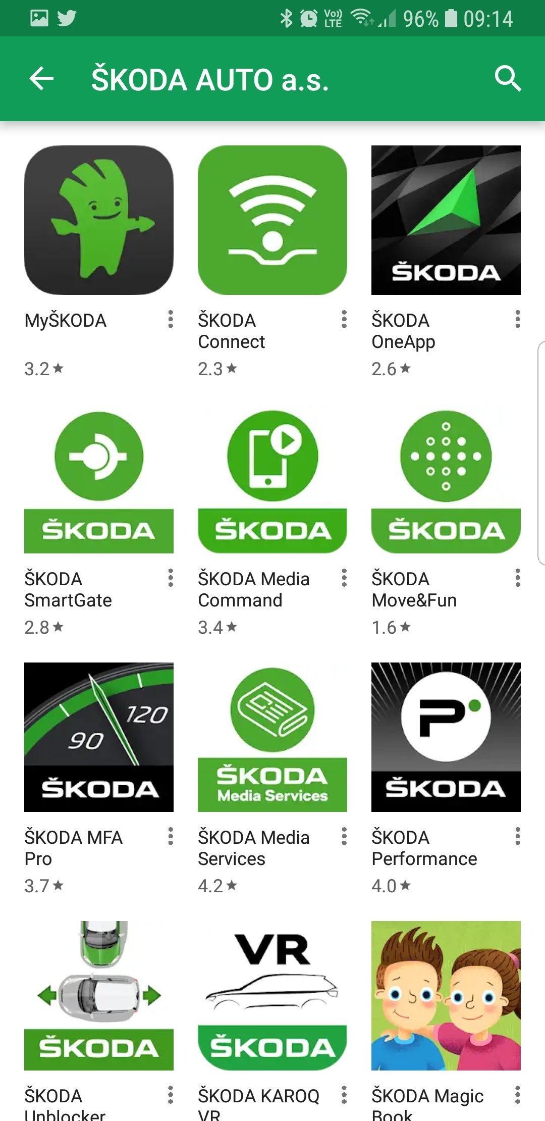

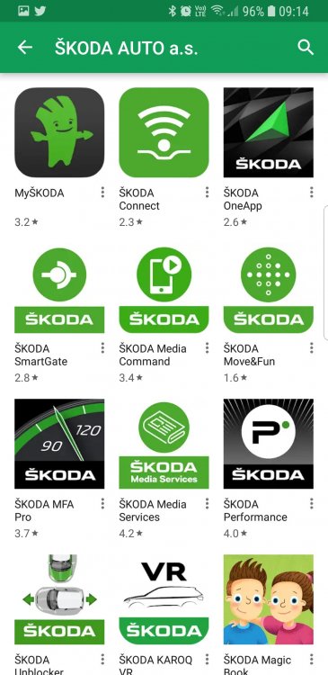

Download the Skoda app of the play store etc and you get all these features
I have the Skoda One App but does not give all features on iOS. Is there any other app?
Not sure, I get gmeter, kw, bhp, nm, all kinds of eco stuff, 0-60 timer, reaction timer Inc 0-60, cost per trip etc etc. All for free
Name of app?
I have installed all of these
dont think my S9 would cope with all that :D
