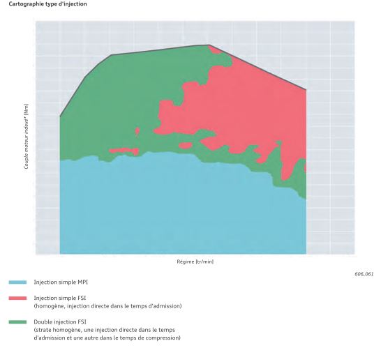

The EA888 Gen 3 of the 1.8 and 2.0 Octavia vRS has MPI and DI.
As well as 2 exhaust cam lift, VVT on intake and exhaust, tumble flaps in the intake manifold, and many more high-end technologies ;)
For more infi, look on the web for the Self Study Programs SSP 099 / SSP 606

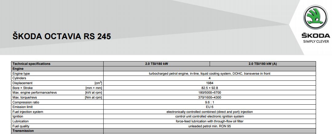

Carmagazine is wrong, from OFFICIAL Skoda form, the Octavia 245 has Direct AND Port injection
TD-OCTAVIA-RS-245-en.pdf
Pleased to hear that!
