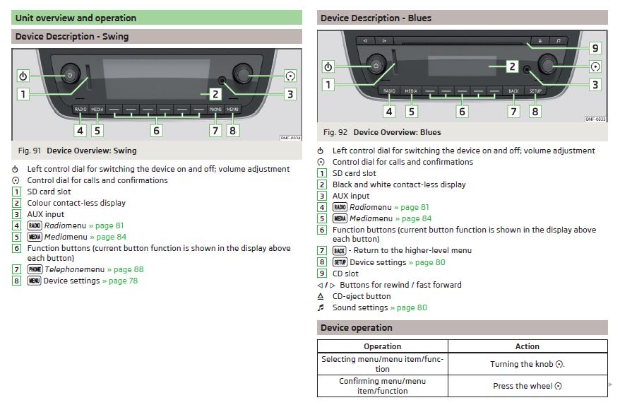

Problem is, I can't find out how to use the Function Buttons across the bottom of the radio facia.
I get deferent graphics above each button but when I press the Button, nothing happens!
It doesn't take me to another menu, just nothing happens.
I've looked at the Owners Manual & that doesn't explain how to use either. They just call them Function Buttons.
Is the Swing the std Radio fitted in all Citigo models or, is it a better quality Radio in the Citigo SE L Green Tech?

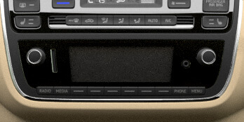

Does ya radio look like this?
Yes that's the one we've got in our new Citigo SE L Green Tech!
The function should apear above the button on the screen and the button function changes depending which screen you are on.
Page 76 to 86 in manual.

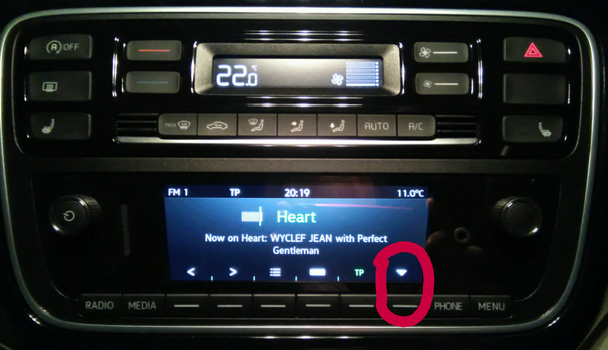

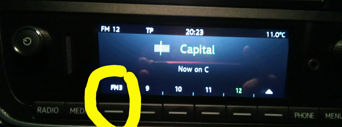

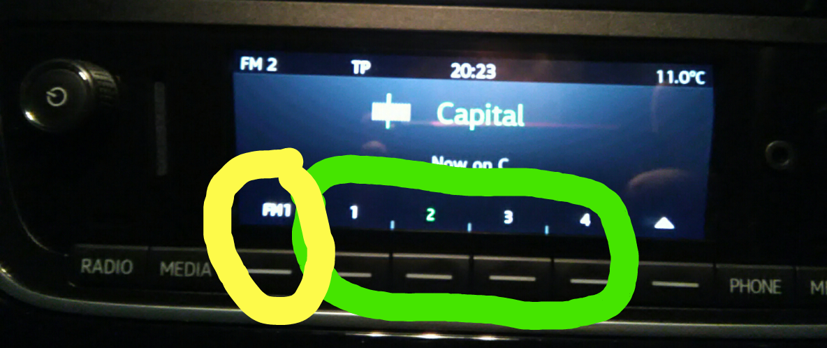

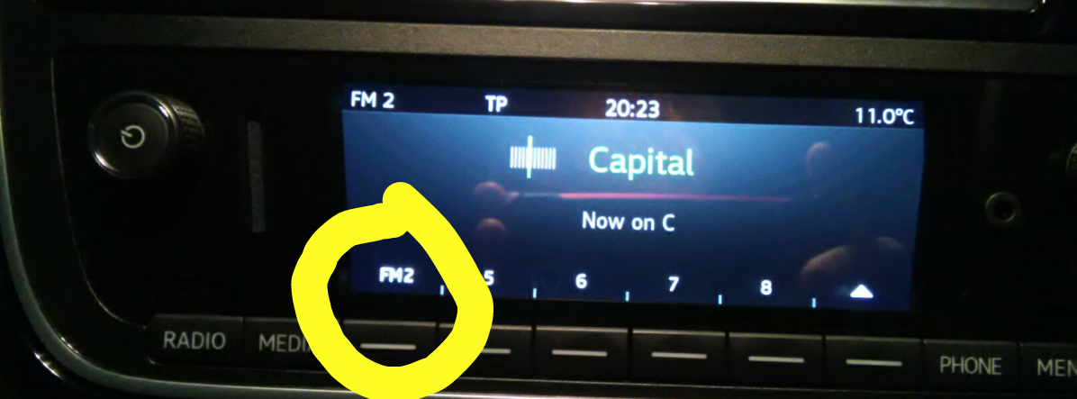

I have the same radio and it’s not so difficult to save stations.
You can save up to 12 stations under FM1,2 and 3 (yellow circle)
- to access FM menu press arrow down button (red circle)
- to save station press and hold button 1 - 12(green circle) until you hear beep
Good luck B)
