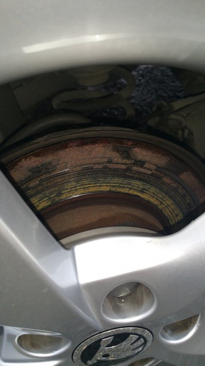

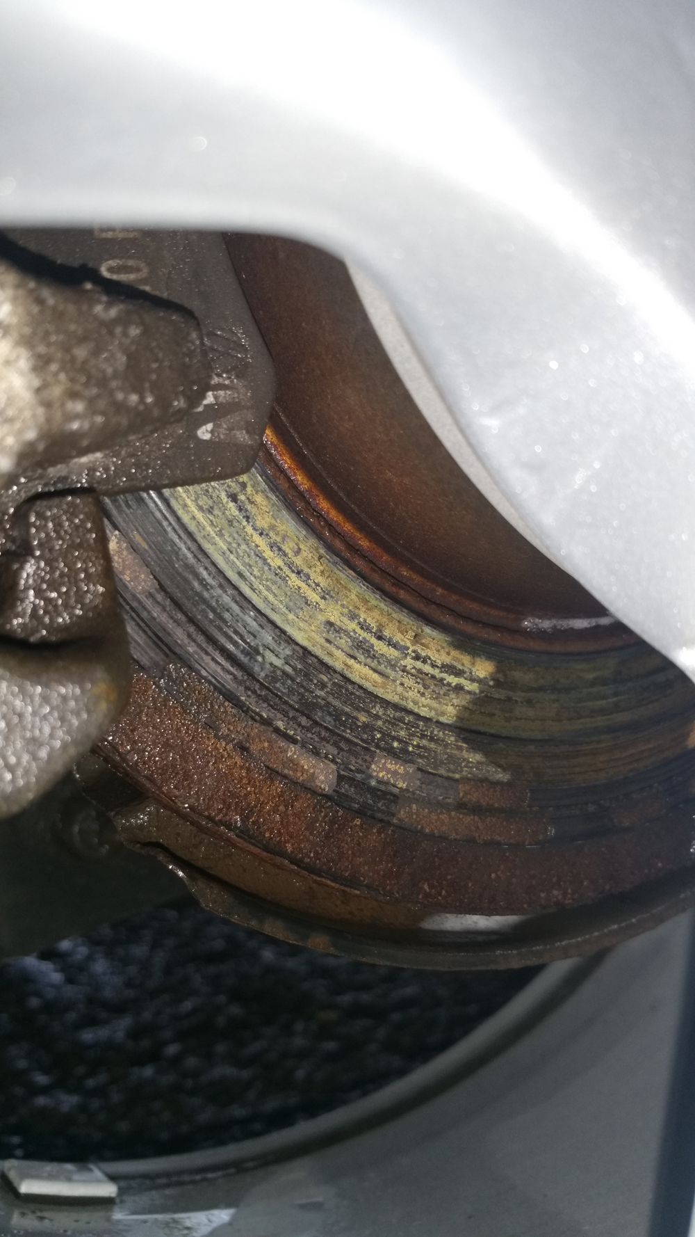

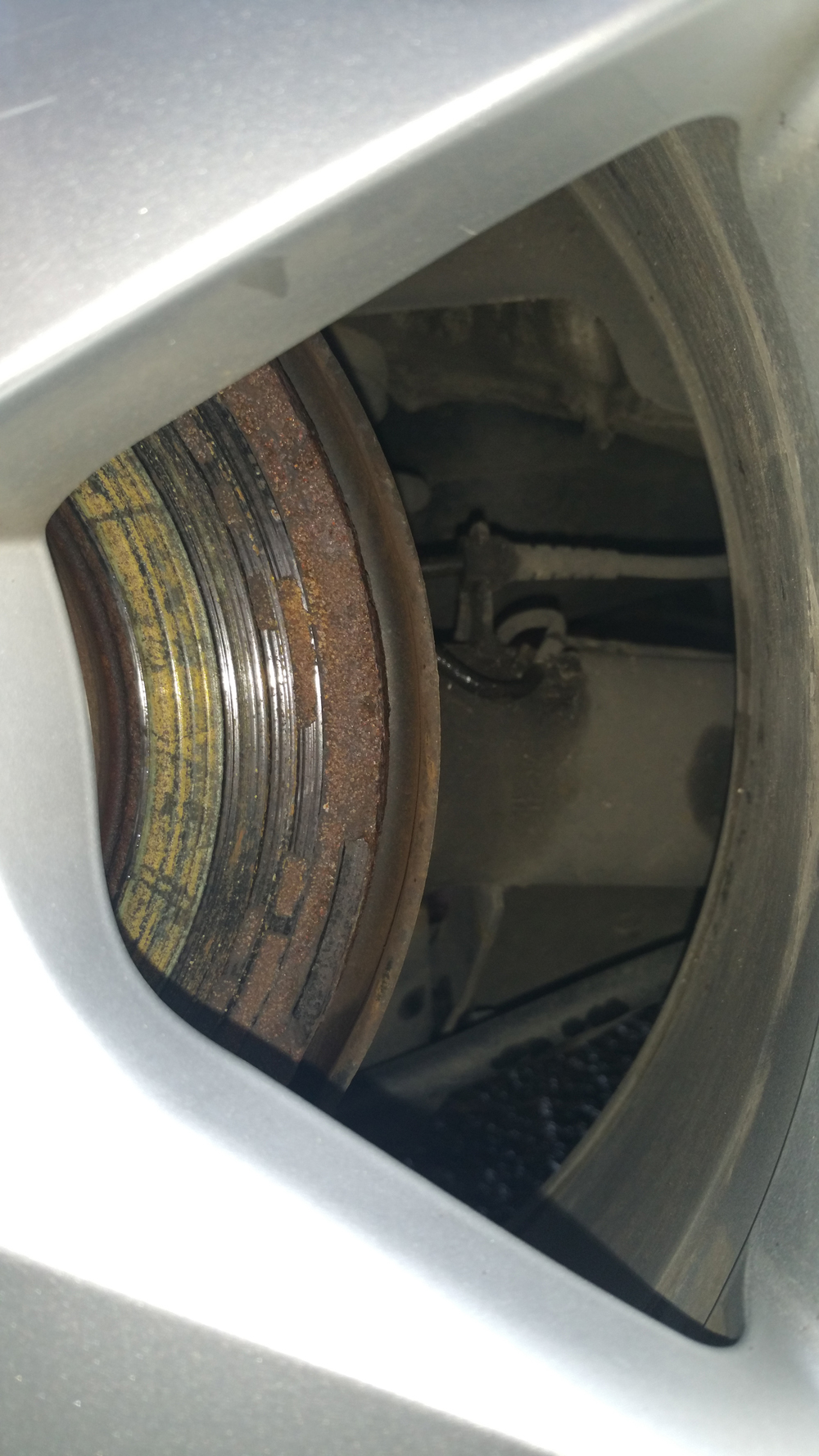

Guys - just had the car serviced - it's 3 years old with 23K miles on the clock. I reckoned the rear disks and pads needed doing. I said nothing to see if it was picked up at the service and it was.
My question is simple - my front disks and pads are still fine - I am simply wondering if it is "usual" for Superb II's to need the rear pads and disks changed at this point?  Car is a "1KS"  = Disc brakes at rear are the  272mm ones. I expected fronts to need doing first - are the superb II's a bit under-specced on the rear disks?
( 2014 1.6 TD CR Elegance, 6sp manual gearbox, no towbar/never towed in its life, rarely driven with any significant weight other than me, wife and sometimes 3 dogs).

Rear disc corrosion and pitting is fairly frequent tale.
They don't do a lot of work at the rear and seem to be very susceptible to corrosion and premature failure as a result. On my mk2 FL Octavia at 33k miles / 5 years the  rears were pretty knackered. [ Using the 272mm disc as well. ] Quite a few have seen less than that. Short trips, coastal proximity, salt spray and arguably cheaper manufacturing composition all probably play a part.
Skoda prices are quite high to do the discs and pads. There are other options if you want to look further afield than a franchised dealer or consider doing yourself.
Edited by TheClient
Are they worn or are they corroded?
Annual mileage of 8,000 miles means corrosion will be more likely than wear.
Whilst the easier life of the rear discs reveals itself in terms of reduced wear a side effect of that is unfortunately increased susceptibility to corrosion.

I think you guys have zeroed in on the cause. The cars first 5000 miles / 1st year was driving between dealers  to be on show and sit for awhile. I havent done huge miles as you can see - mainly infrequent long drives - I'm also not a million miles from the coast. Salt is not an issue but those disks will be sitting around damp for some time, especially during a West of Ireland winter.
1 hour ago, ahenners said:
What's the best way to stop corrosion on the rears, if largely used on motorway?
Heavy braking helps. It doesn't need to be every day, one a week or so is all it needs. A nice long down hill stretch on a quiet road is ideal, leaving your braking later than normal, apply plenty of pressure to the brake pedal and for as long as possible.
Also after slowing down to 10mph normally try using the handbrake to bring the car to a stop*
Both these options maximise the braking forces on the rear discs which helps to scrub off any corrosion as well as putting some heat through them.
* clearly only do this when safe to do so and when no one is behind you (no brake lights).
