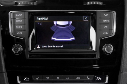

Sorry to revive an old thread but did this unit show the parking sensor display too? Also did you manage to get a rear camera to work?

@Kammy yep! You get a nice display like this (not my photo, just another parkpilot photo - too lazy to go take a pic!)image.png.908744912de9a2e3a406af8347a910d0.png
I'm told that if you fit a compatible camera then you get the parking guide lines too - magic
