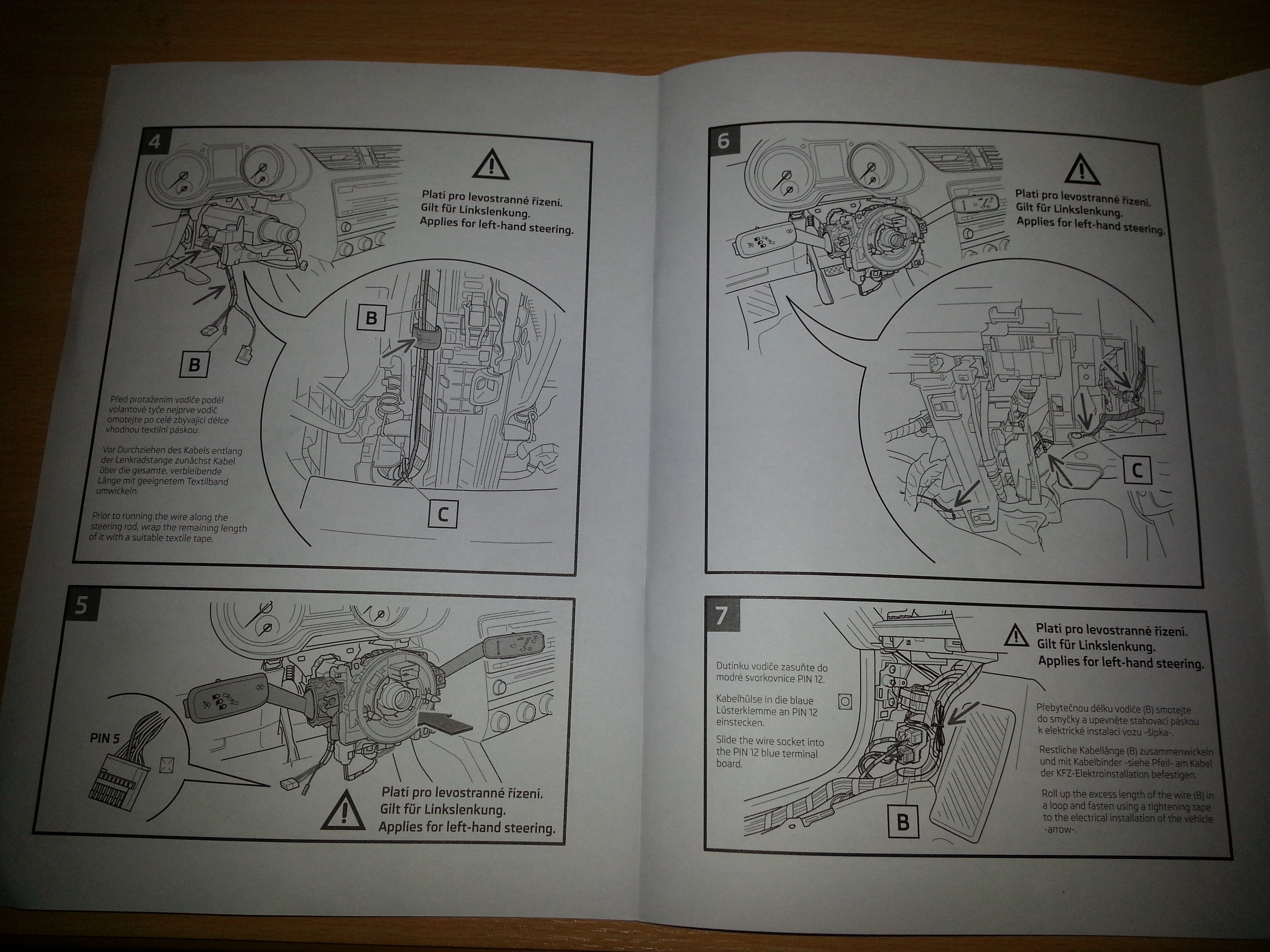

To go to a scrap yard if you can find one, you'll have to take the steering wheel assembly off as well as get the wire that goes with it off which goes somewhere in the fuse box (?).5989a7238e738_2014-03-2314_45_07.thumb.jpg.6709c72d9537c8f3bda32948e84bf022.jpg
It can be coded with VCDS I believe. However yes, its a single use code I believe that the dealer uses to activate it. For the sake of just getting it done with no messing or problems, I just let them do the whole job.
