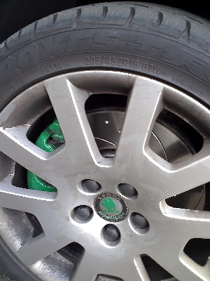

  • I'll be sure to post pics of those same Zimmermans fitted to mine later this week, just to tempt you even further

And in answer to your earlier question, although I didn't believe it when this pictorial was first posted (wow, that was a long time ago! :rotz: ), they fit fine under 16"s - that's what I have! :)

Likewise, to be honest. I had these previously:
I reckon they braked just as hard as the 312s I have now; they just didn't last particularly long as a result of the amount / type of driving I do.
