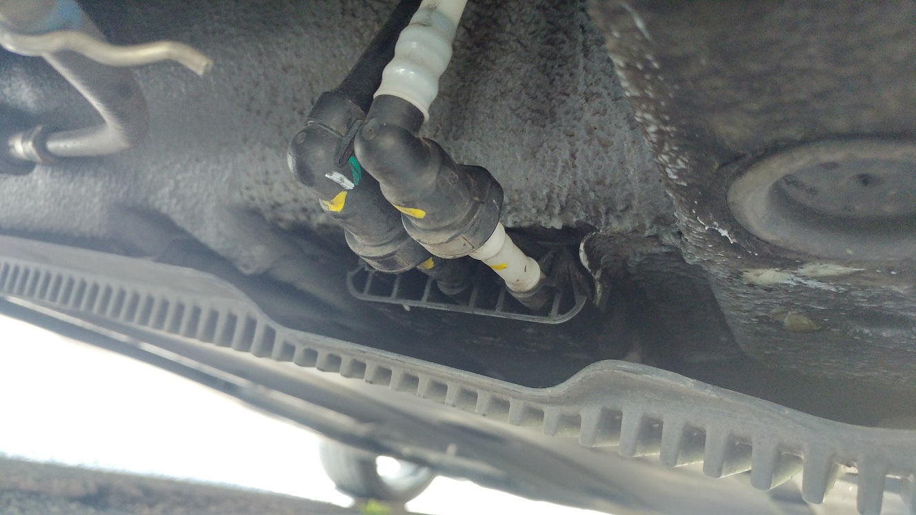

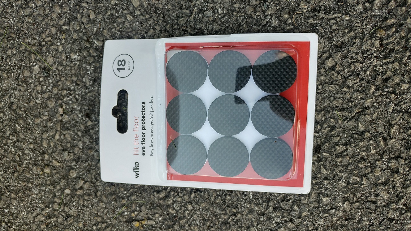

Fixing the fuel line rattle in 5 mins for £1

This is genuinely 100% silent ... Or at least for the moment!
Took it out on a good drive and kept the revs in the range where it used to happen, and nothing ... It's beautiful.

So you just squeezed one pad between the plastic bracket and the car floor is that right?   We test-drove a 1.4 with a friend who is interested in buying it yesterday and all was fine but a vibration/oscillation at 4500rpm which seems like a fuel line rattle although i have never read about one that is showing up that high in the rev range so not 100% sure it's the same thing. Comes from the driver's side (left for EU cars).

Yep, that's all I did. Still perfect 3-4 days in!

My identical slight rattle did not appear with revs, but when going over uneven roads. So I have just bought the same round pads from Wilko and put them underneath the car on top of the fuel line bracket. Maybe, just maybe, with a bit of luck, my slight rattle that appears to originate from the rear of the drivers door or B pillar will also now have gone.
I read it a few times but confused, where exactly do the pads go?
In the second picture does the black bracket need to be removed or lowered then you place the pad on top then put the bracket back into position?

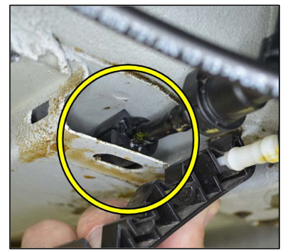

Where did you place the pads?  Struggling to understand where, though I did find this, which looks like the official fix albeit for a VW
https://static.nhtsa.gov/odi/tsbs/2014/SB-10069579-2280.pdf
Did you put the pad inside the circle in the attached photo?

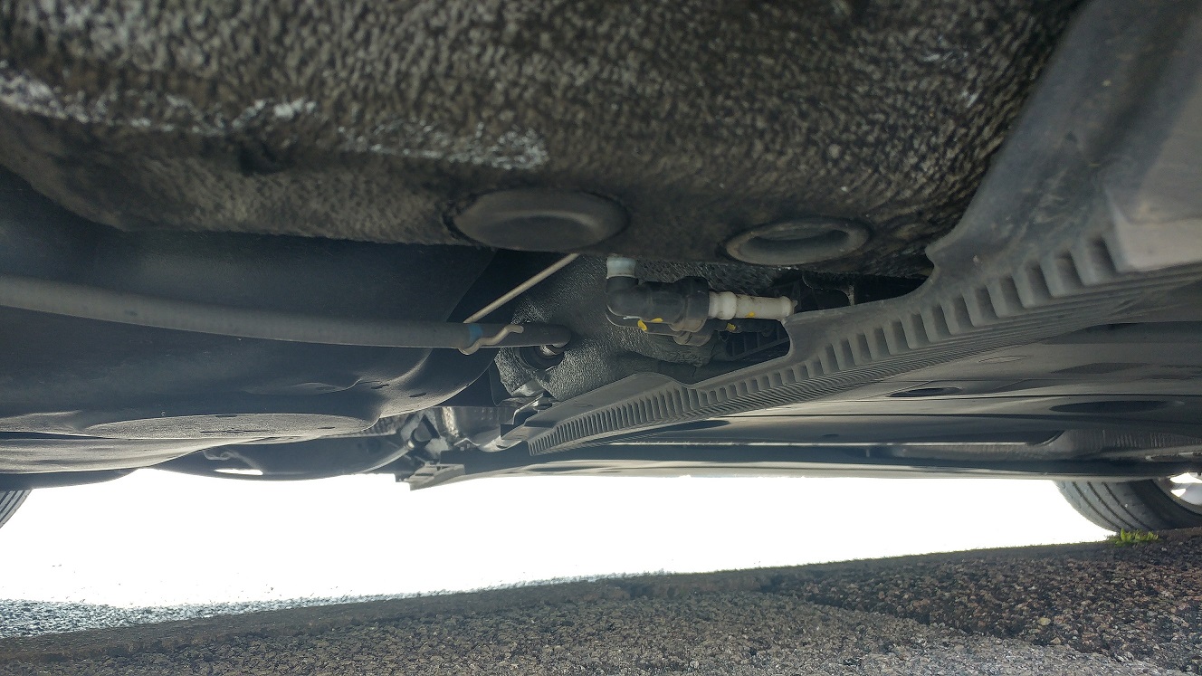

Where the 2 fuel pipes come out of the black bracket, I fitted the pad between that black bracket and the floor above of the car. When I felt this bracket there was a bit of movement up and down. So I was hoping this was actually the cause of my slight rattle. No such luck in my case. The original post by stu83 with the photo is accurate.

Did this black plastic fuel pipe holder bracket just pull down or is there a method to unclipping it - I didnt want to break it
I just pushed the foam pad between the bracket and floor with the end of a screwdriver without taking the bracket down. Shame in my case that was not the cause of my slight rattle. Still have not found the cause even now.

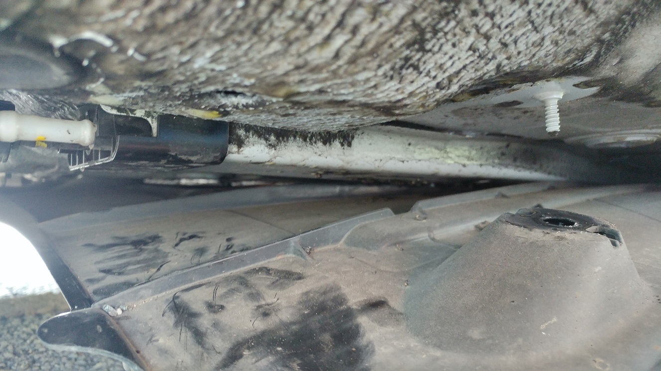

Cheers - Yes I have just pushed some foam in the same - but it doesnt seem to be the problem - I am wondering if the fuel lines are vibrating further in the floor openings - and so maybe the VW fix with isolator pads are the answer.

fwiw to anyone else i wedged a sticky fabic square like in the OP above and inbetween the 2 pipes which solved my issue

Lately I've been noticing that rattling/vibration sound at 2K rpm in the right door area of my 2015 vRS, but couldnt pinpoint where it was coming from, until i found your post.
I just unscrewed the outer endge nuts od the plastic bottom so i could "bend" it down and reach the frame where the fule lines are and stuffed the frame with four dishwashing sponges through the cutouts on the frame.
That solved the "car is falling apart" sound and made me happy ☺️.
