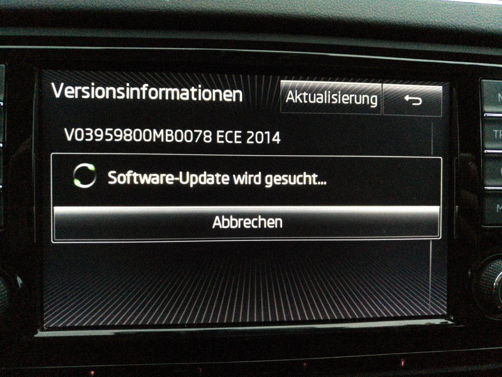

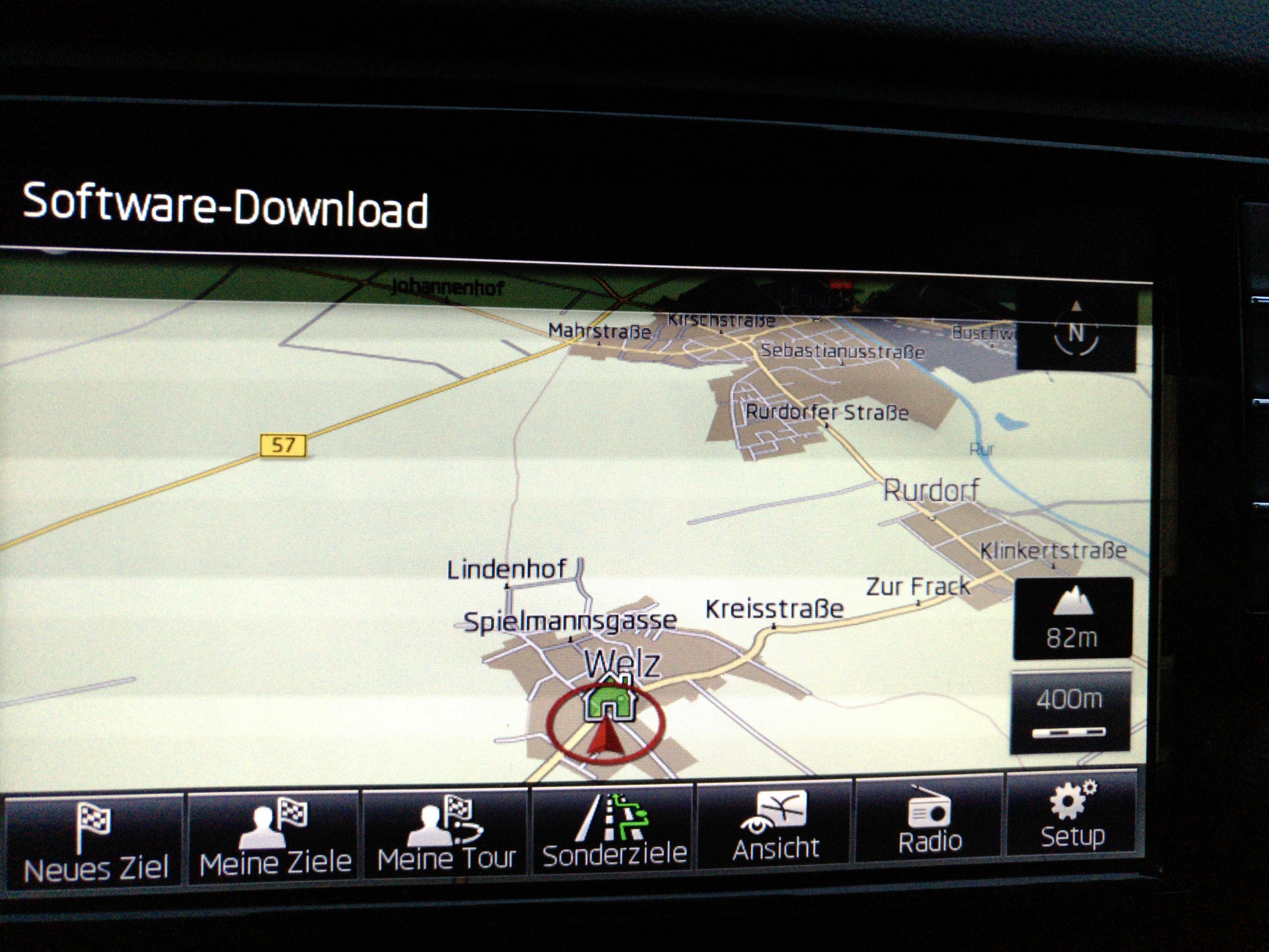

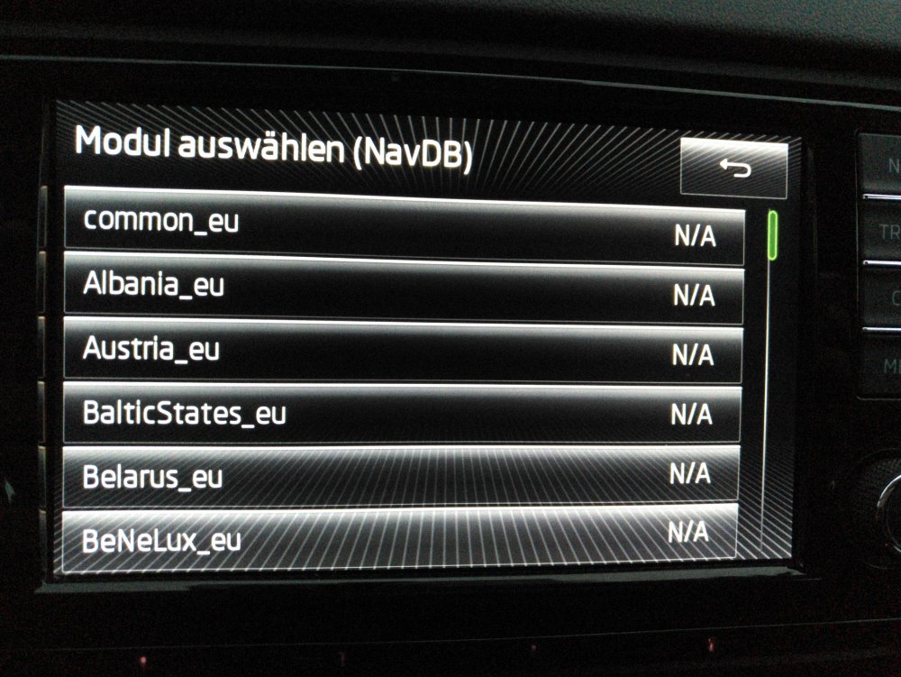

When i do plug in the SD-Card (32G, Fat32) with the correct files on it, in the Top of the Display a message pops up [Software-Download]

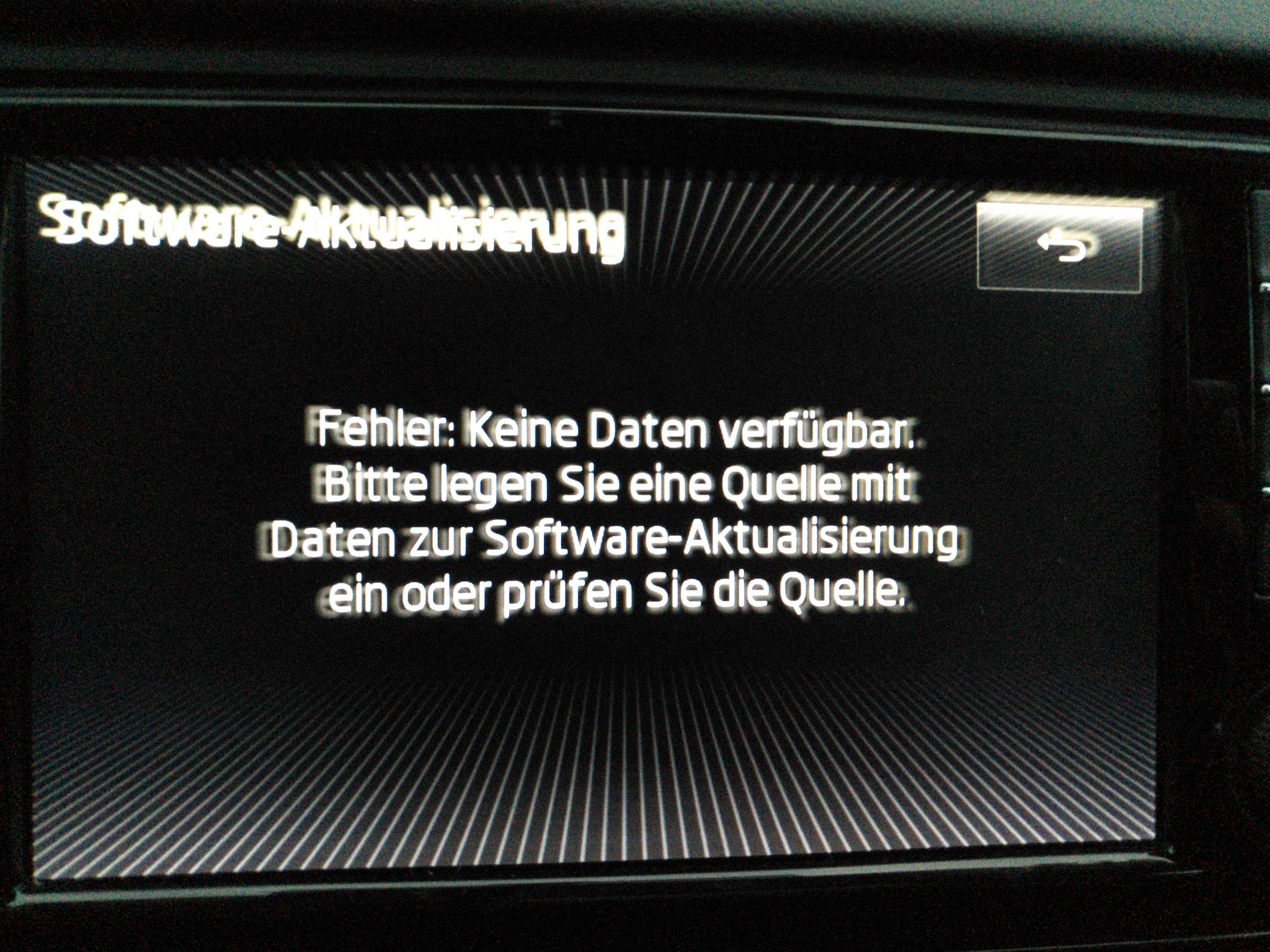

Then i go into the regulary update menu. After searching for an update about half a minute it says:
"Error: No Files available.
Please put in a source with data for the update or check the source"
(Fehler: keine Daten verfügbar.
Bitte legen Sie eine Quelle mit Daten zur Software-Aktualisierung ein oder prüfen sie die Quelle)

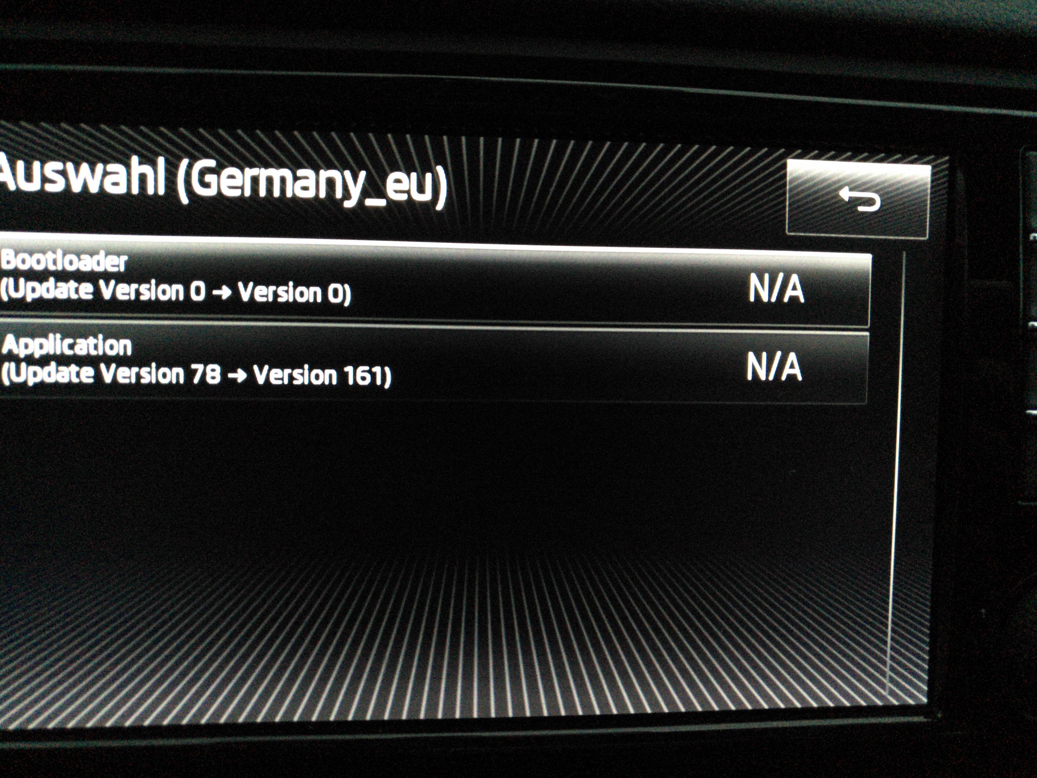

Even a manual update via pressing Menu for a few seconds does not work. It recognices the new data but will not update.

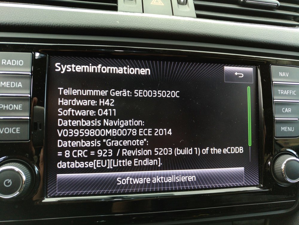

I checked it via OBD II for errors in the device and it says, that the Map-data is damaged. Maybe this might be the problem?

I am going to try the solutions out. There is another Update Menu after 30 Seconds? After a few seconds the Update Menu Pops up, which i have shown in the pictures.

When I insert the SD-Card, a message pops up in the too corner of the Screen "Software-Download". So it recognises the data.
It seems more, that I cannot update due to a damaged map (bootloader?) In the device itself. Navigation is working fine. Even e.g. when I drove from Germany to Liverpool, England.

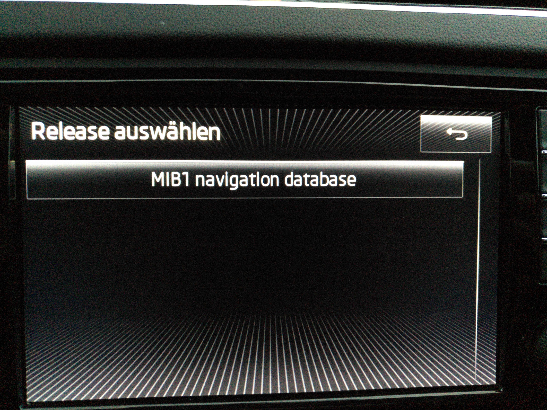

Just to give other People with the same problem a solution:
Enable the Engineering/Developer Menu via CarPort/VCDS or similar.
Hold Menu button for about 30 Seconds to enter the Egnineering Menu.
Choose SWDL/Software Download, Tick Manual Download and proceed as usual. You are now able to do the update.
