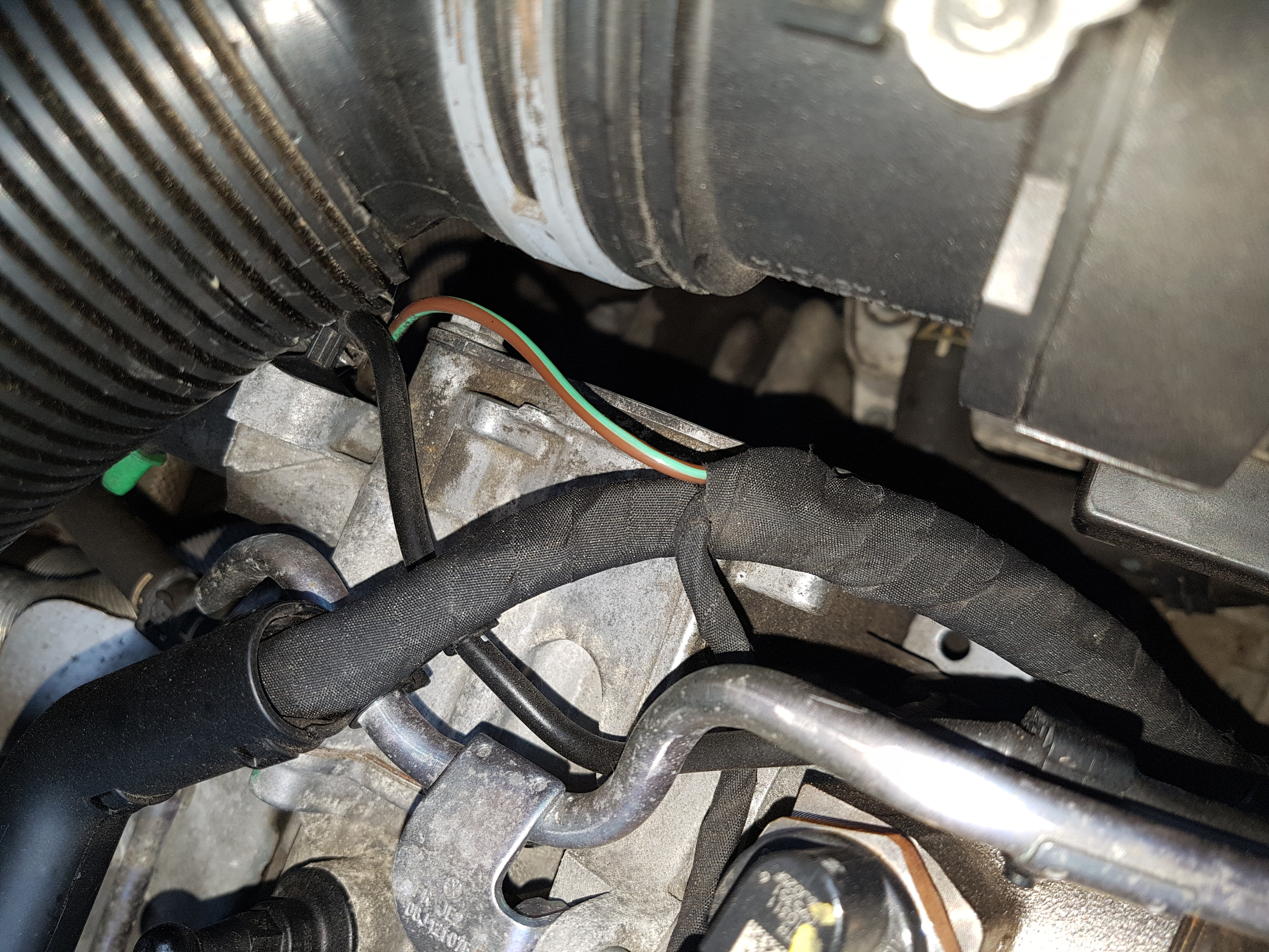

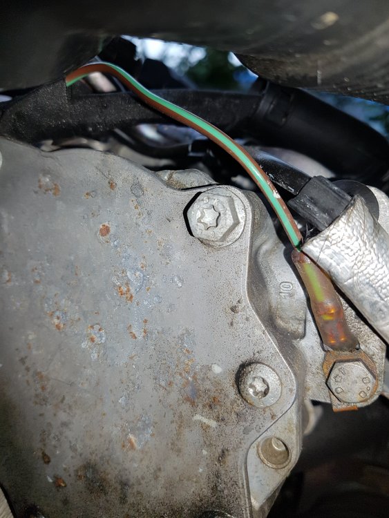

The engine cranks but doesn’t fire up. Physical inspection doesn’t reveal anything apart a loose earth wire as shown in the photos below. Error codes are also shown below. Battery and the alternator are fine.

I'll try to have a look where the earth is clamped to. It must be somewhere very local though given how short the cable is and presumably a bolt or nut has fallen off. Did the AA man try grounding that wire somewhere to start?

Probably need to remove the intake pipe to replace the bolt. Easy enough, few minute job with spring clamp pliers. If it is causing the problem, you could just wedge it against a metal ground point to test.

I've reattached the earth as per the pics above so thanks for that one. The AA bloke tried grounding it various ways eventually culminating in him blowing up coil one, which he replaced FOC like he was doing me a favor :dry: since reattaching the earth I haven't tried to start it as I don't want to damage anything jut in case cranking it will make whatever it is worse! I don't think it will be the chain as I found some invoices showing the tensioner had been upgraded by the previous owner.
