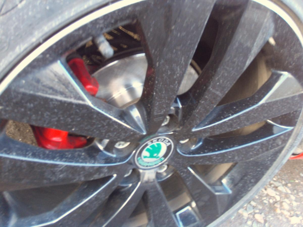

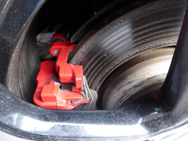

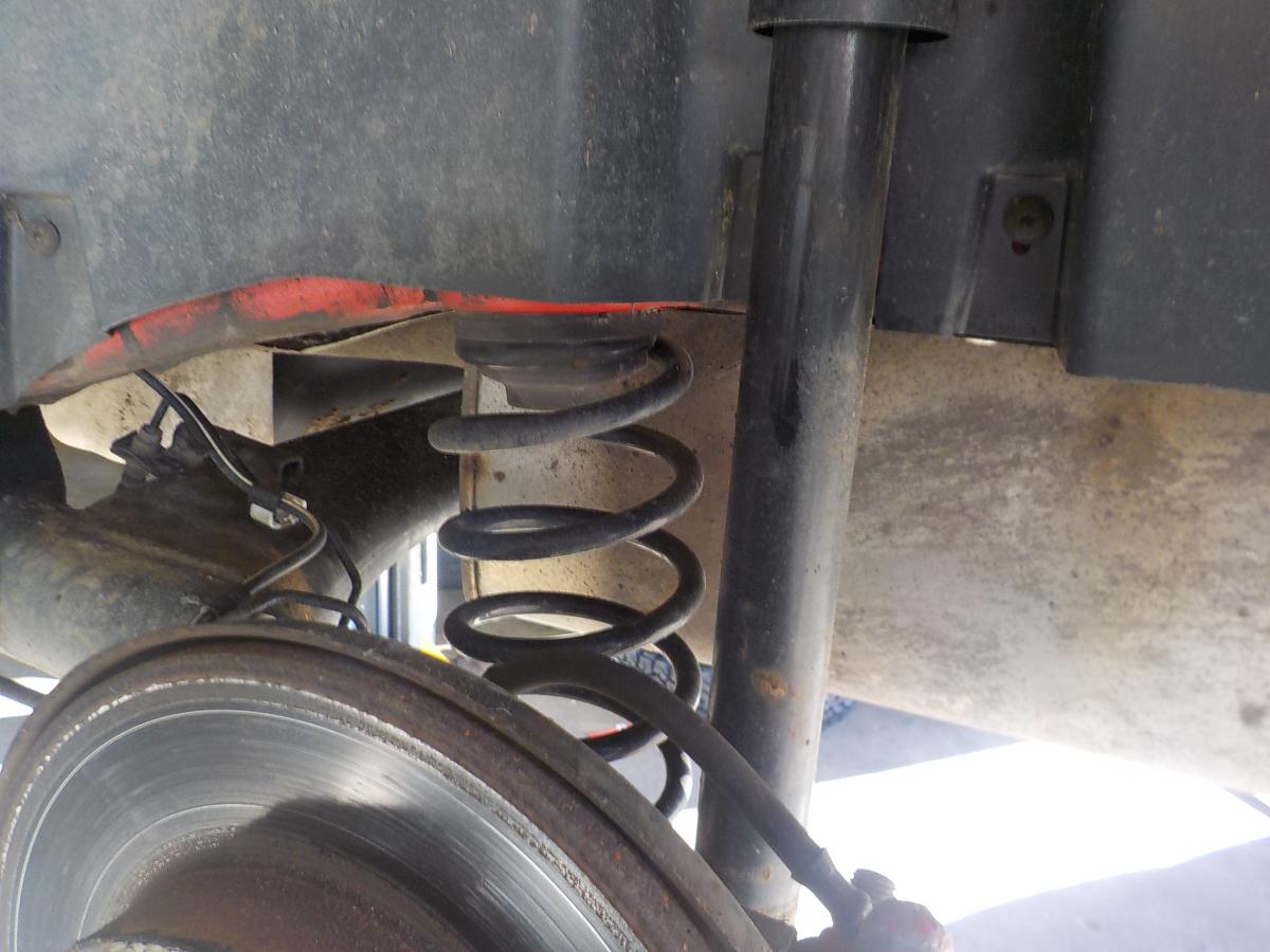

As to the corrosion of the rear disks, I can't honestly say that I feel competent to comment on whether or not they need to be replaced - I will get someone else to have a look at them; for safety and insurance reasons I need to sort this.  The wheels were not removed to facilitate close inspection of the disks / pads - I would expect a decent garage to do this as a matter of course.  I can't quite see why the rears would be corroded and the fronts not - weird!
How much should replacement of the disks and pads (front and rear as separate items) cost?
Corrosion on rear discs is often due to a build up of dust and corrosion on the sliding surfaces between pads and carrier. This causes one of the pads, usually inner to stick, so that only the outer pad is actually braking, the disc on the inner side then builds up rust ovwr time due to lack of pad contact.
Its because your servicing dealer was lazy and did not strip and clean the brakes at the major service as recommended by official skoda service schedule. Many dealers deliberately flout the guidelines to save time and then upsell you pads and discs later on.
Its actually easy to fix, strip the brakes, clean up the carriers, lubricate with the correct grease, file off excess corrosion on the disc, (if the discs are still above min thickness) refit with new pads and the discs should clean up after a braking session.
^^^ Corrosion is due to them being rubbish discs.
Brand new Demonstrators with under 3,000 miles can be red with surface / cosmetic corrosion.
I changed mine about every 18 months because they got bad and that was with 10,000 miles a year but a salty winter, and sitting around,
and going rusty just parking after a run and it raining or washing the car.
4 new discs & pads are under £140, and easy to change and service the calipers / pins.
I MOT'd my 14 year old Suzuki yesterday, 54,000 miles parked outside, same conditions as a Fabia gets parked, and still the original discs fitted, pads replaced once though.
Bottom Discs are on a Golf. but same thing 'build up of corrosion' maybe other night, maybe still pull on the hand brake and clear the rust in the first few hundred yards, but still the pads last longer than discs...

I still don't understand why the rears would be worse than the fronts, is it just a matter of "chance"?
Rear do not get the work out that fronts do. The wear is more from the cosmetic rust being taken off and then ending up scoring the rears.
Have you given the rear discs a look. run your finger across the discs when cold, felt for a lip,
or even had the wheel off and look at the back of the disc?
