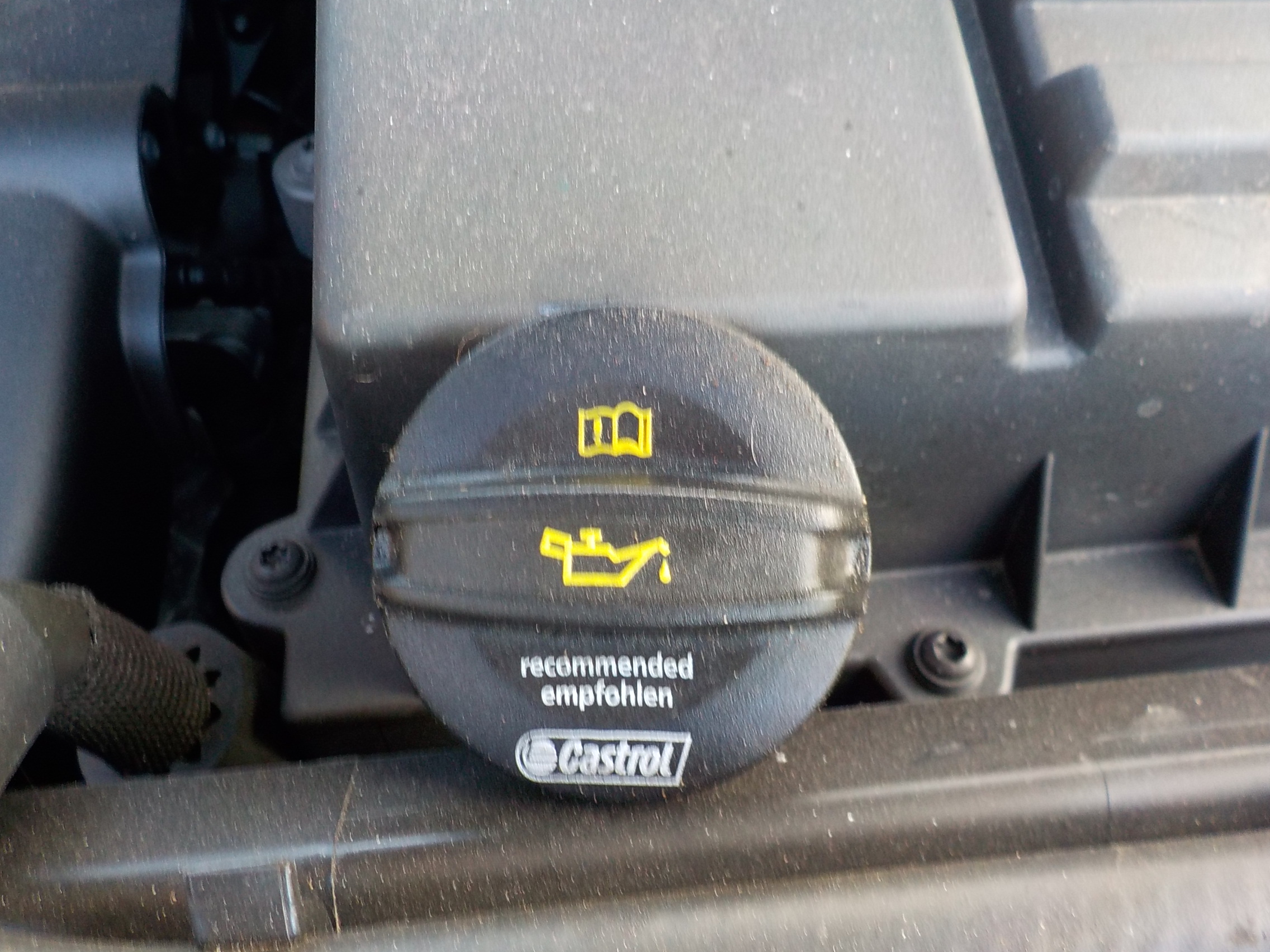

CASTROL on the filler cap. (edit)

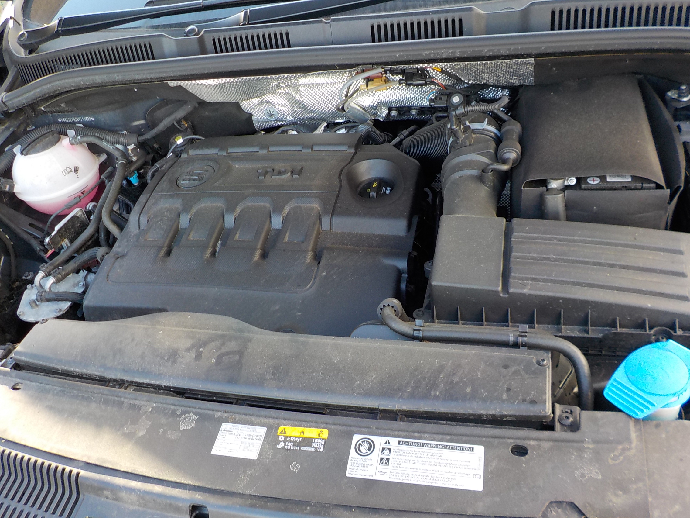

11 months old SEAT, 15,000 miles and it has had 3 litres of 5w 30 FS LL in now,
black as the ace of spades and it is not due an oil and filter change for another 5,000 miles.
Not one you would want to buy in another 25 months when it is at auction.
