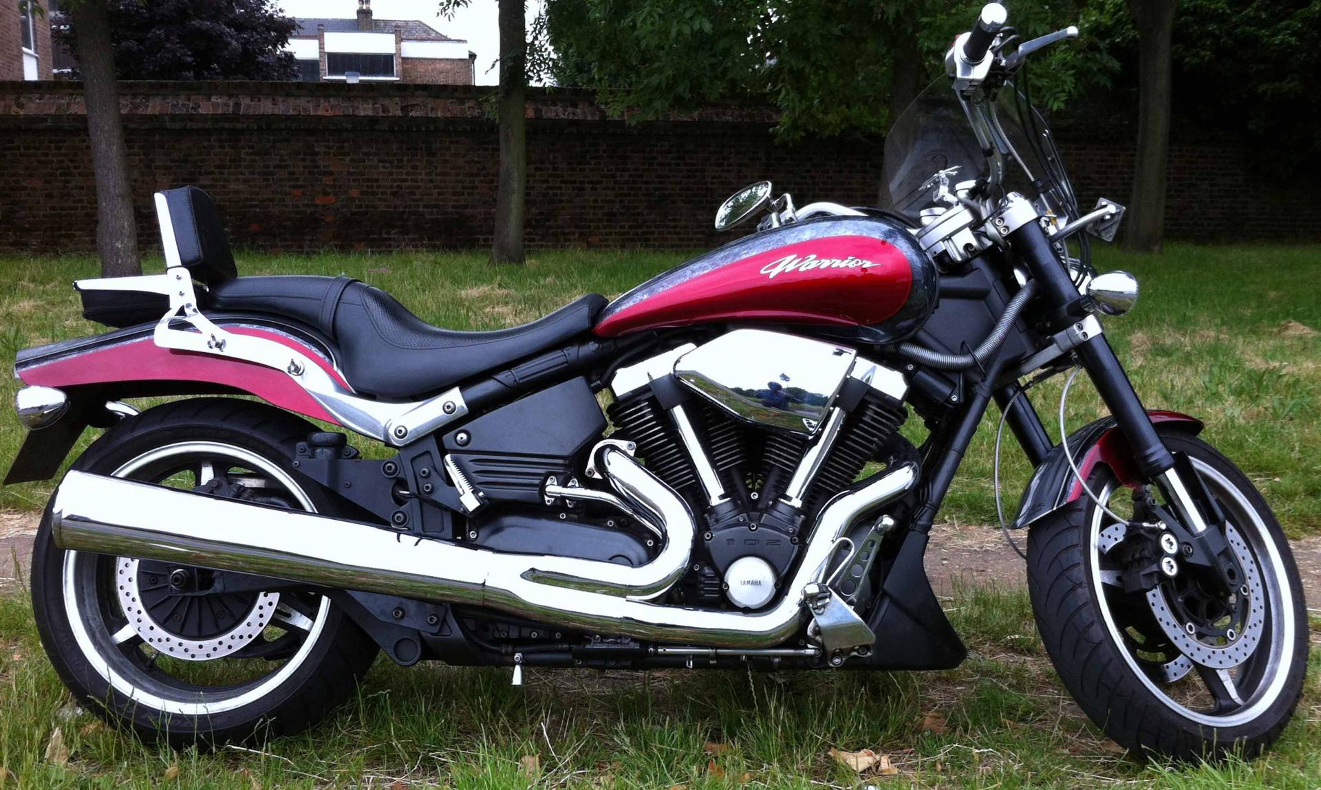

thanks for the info ... motorcycle bulbs are sooooo much easier ... even the led units on my beast ... yamaha xv1700 warrior ... not too many in the uk
