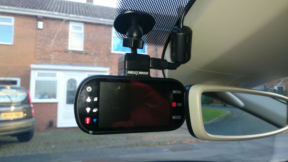

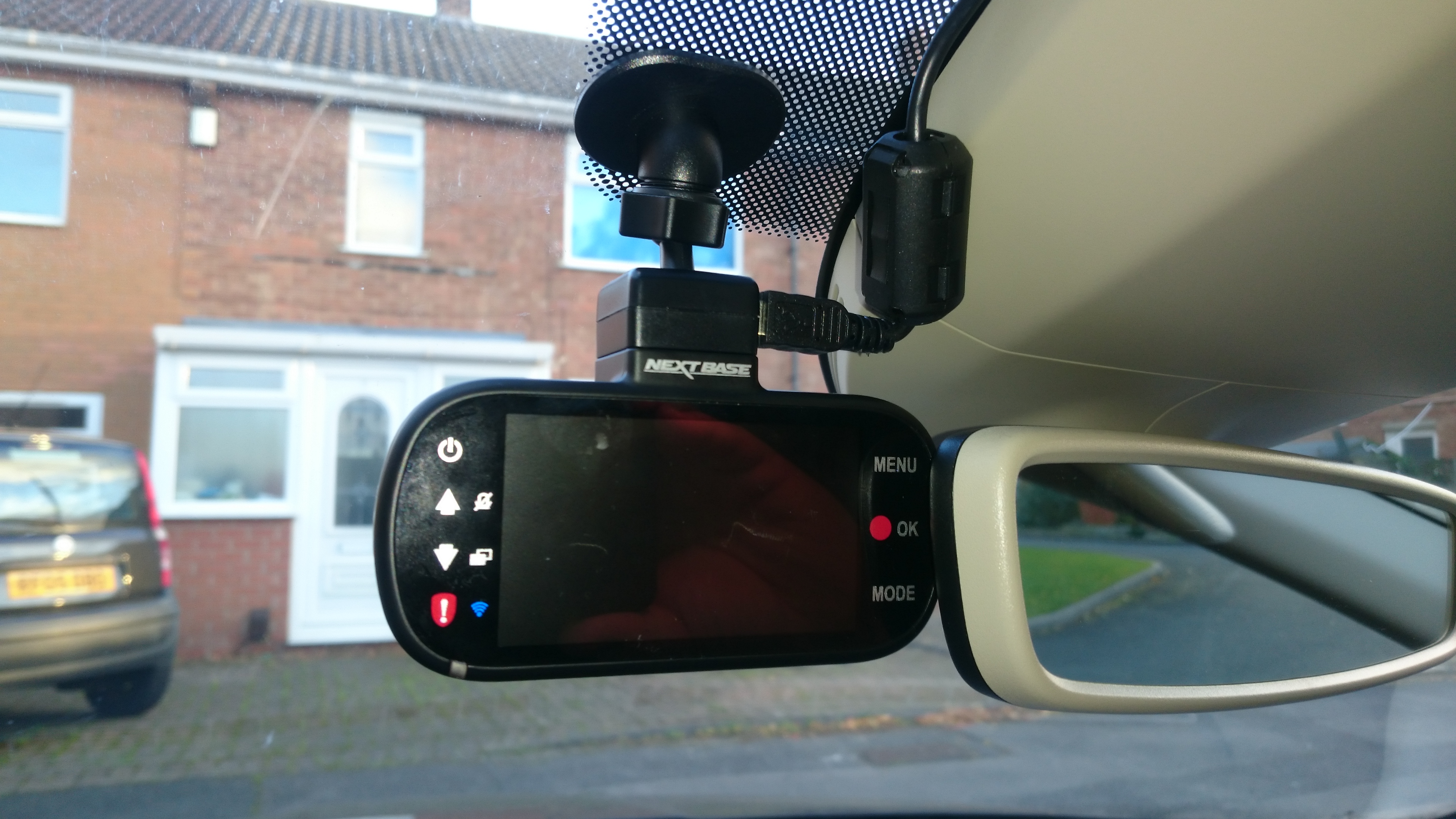

Installed my new Dashcam; a Nextbase 412GW. I did have a cheap twin camera dooberry that was okay but it was 4 years old, the picture quality wasn't great and it relied on a capacitor rather than a battery to shut down properly. The new unit has a 1440 line camera and superior night-time performance.  It also has a magnetic, quick-release bracket so it can be dropped in my pocket.  It's wired in with a genuine Nextbase hardwire kit.  I thought about a generic kit but the official version came with two piggyback fuses. In the end I slotted it in an unused fuse slot rather than borrow a different circuit.

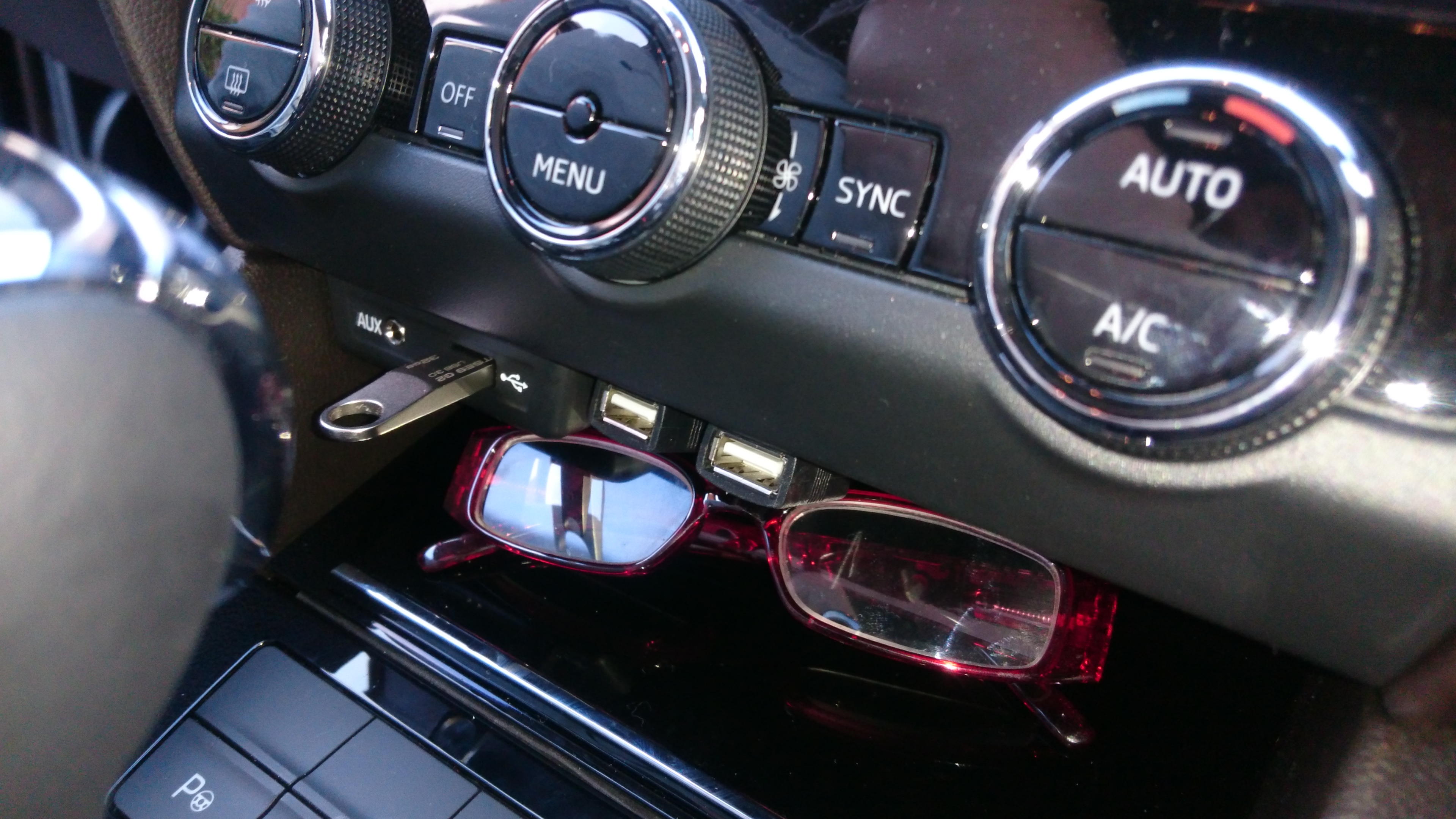

The other item is a 12V to USB module. 12 volts DC in, 2 x 5 volts DC out. The output for both together is rated at 3 amps, which is more than enough to charge two smartphones simultaneously. I was able to feed the module through the gap between the "ashtray" and the ventilation controls. It was a bugger of a job due to limited access behind the console but I applied an unusually high amount of patience. The module is stuck on the back of the console next to where the passenger's knee would be. I used another piggyback fuse adapter (another unused circuit) as the power source.

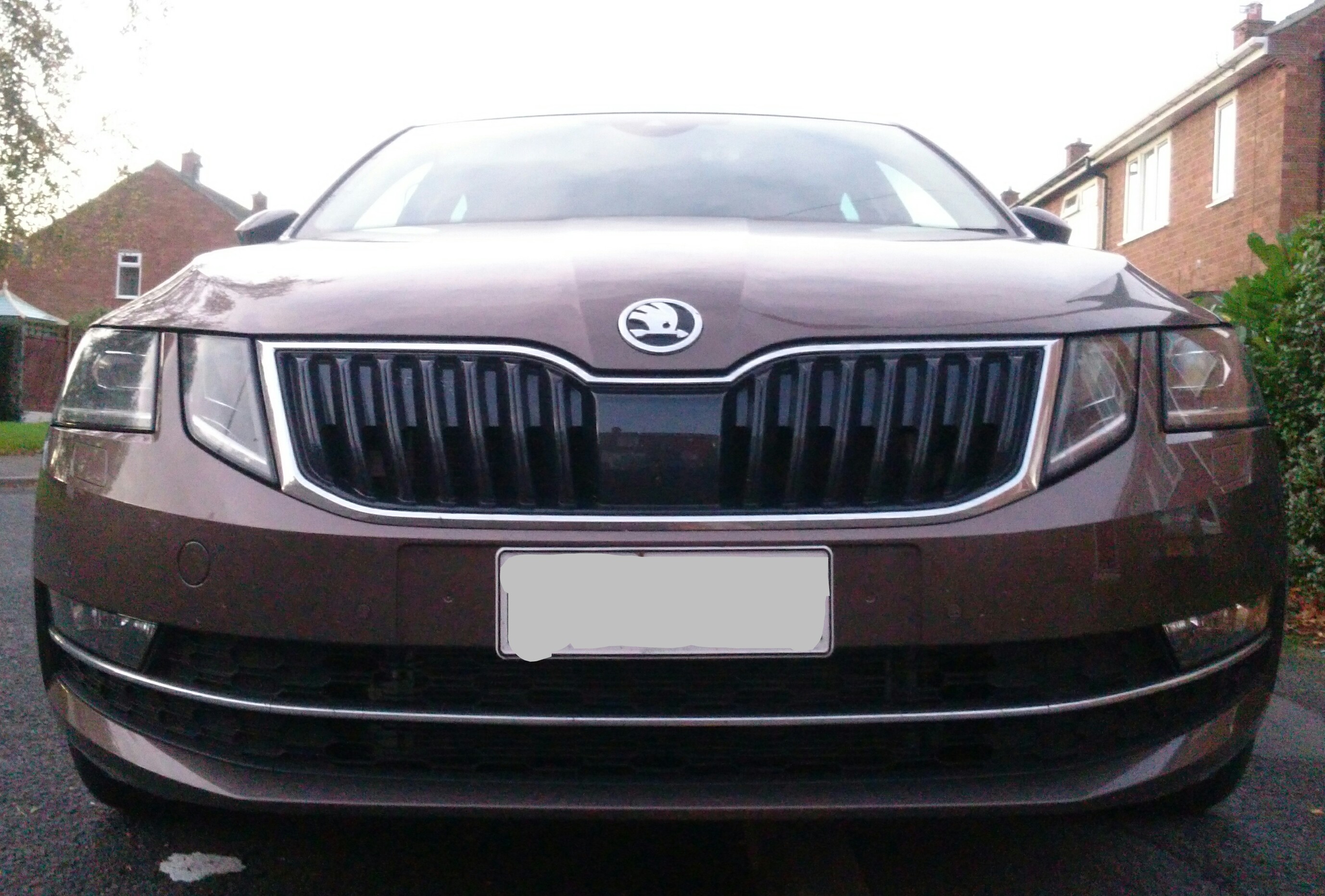

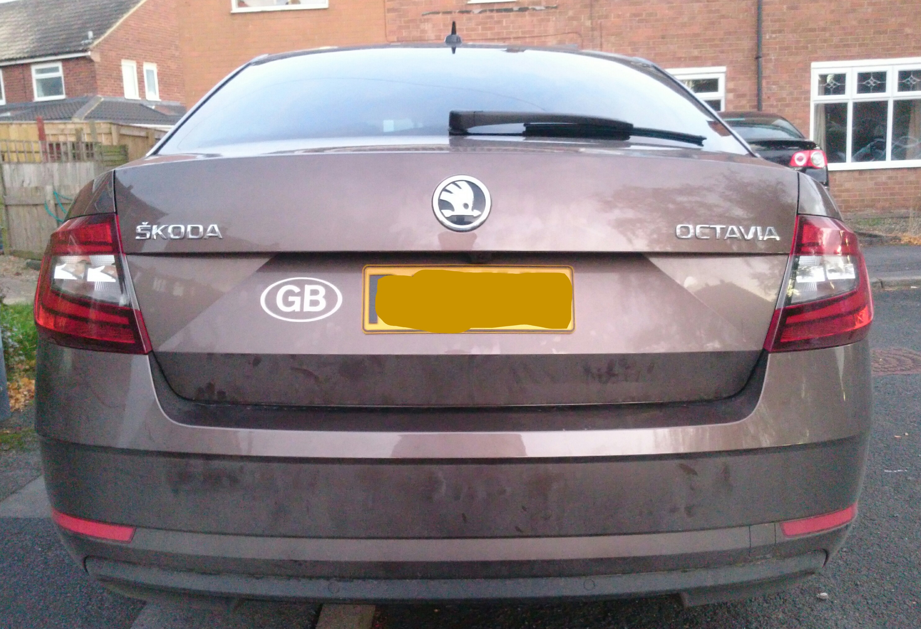

For a change I went for a short, pressed-metal number plate. My reg is only 5 characters so before anyone tries to claim it's not legal to fit such a small plate, all of letters and numbers used are the correct size, the spacing meets the regulations and there is the required 11mm gap around the edge. I think the Octy suits a small plate and actually makes the car look wider and more imposing. Using a smaller plate on the back gave me enough room to add the GB badge on a flat surface.
I'm still undecided over the badges on the back.  I normally debadge my cars on the day I get them but I quite like the typeface.

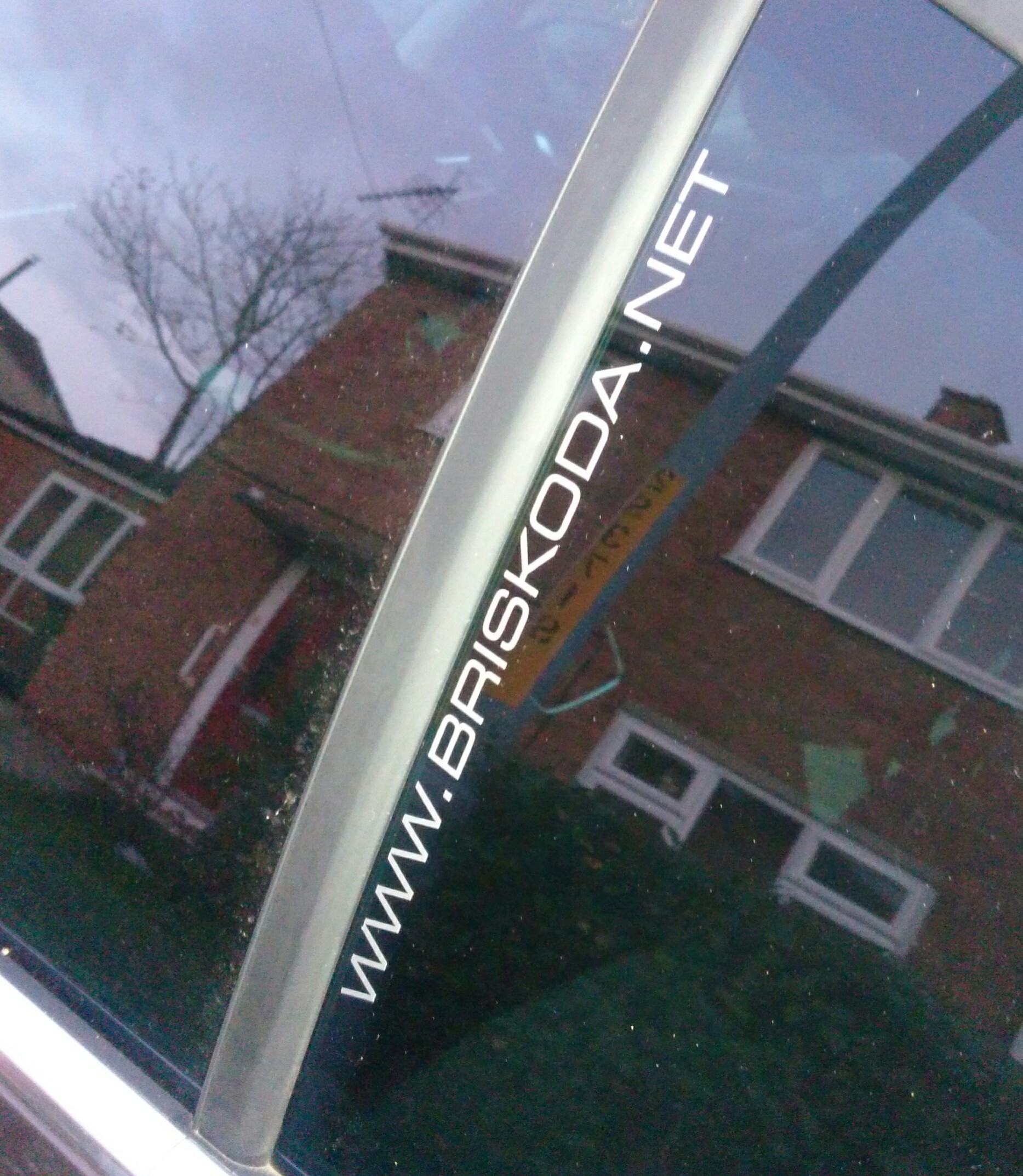

The second change had to be the stickers. One on each side on the rear quarterlights. The silver really pings off the dark glass.
