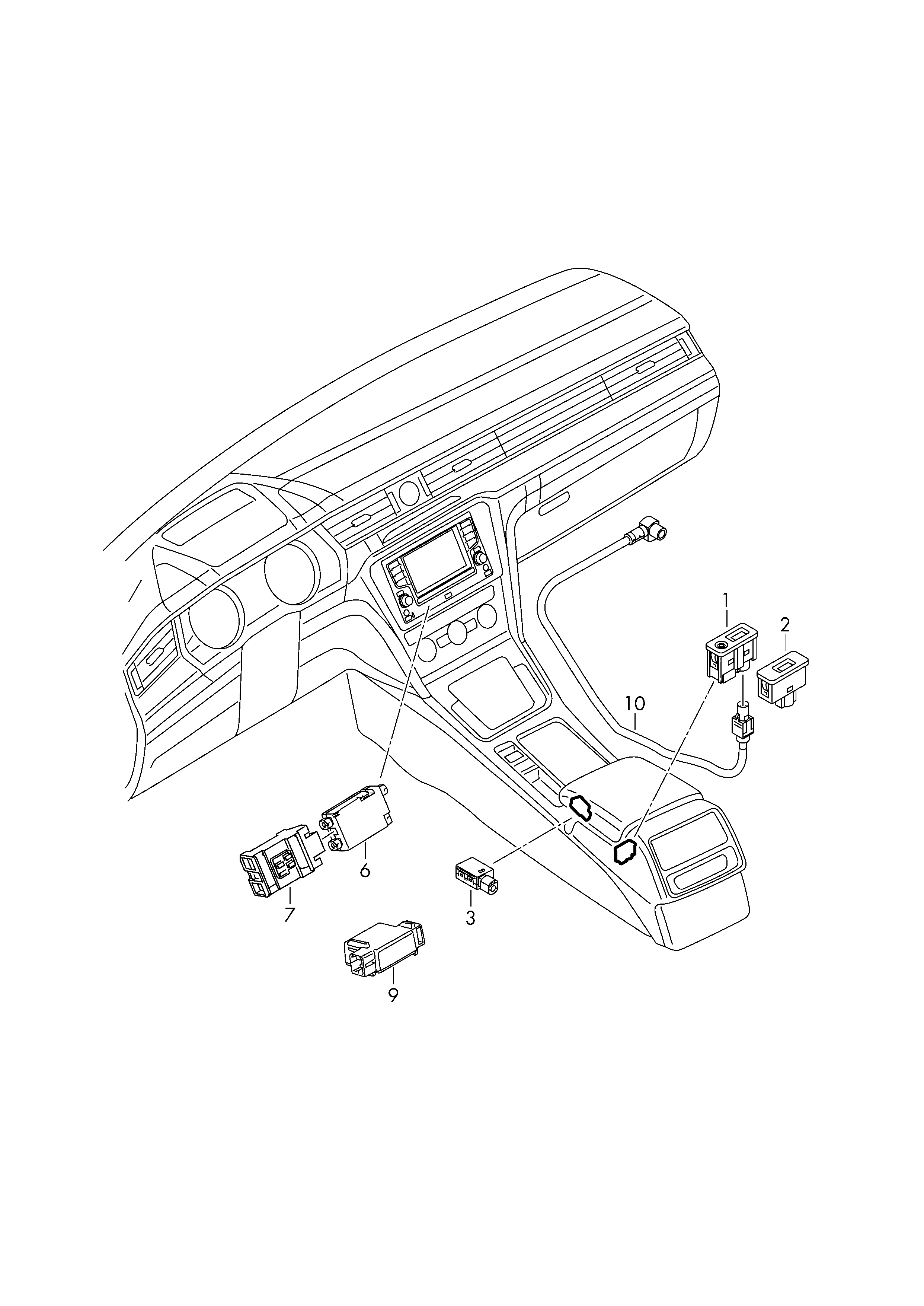

@SomeOfTheGear it does give you the option of sourcing the parts from the facelist model to hook up the USB in the box
@SomeOfTheGear - it is possible to retrofit an additional USB data port in the storage under the armrest, however it's no easy task.
it was available as a factory fit option in some markets, even on pre-facelift Superb.
I contemplated doing, did all the research and figured all the bits and bobs needed - but i didn't end up doing it cause too much effort.
Instead I went down the much easier route and got an AAWireless device (been flawless, no issues, and no lag), as well as converting my rear 12v port to a USB QC port.  this way I can connect wirelessly and charge my phone if I need to.
if u do want the actual additional USB port, then u will need a USB Hub, USB socket, and wiring.
Part numbers:-
  1. 5G0035953C - USB HUB to 2 ports
  2. 3G0035643 - holder of the HUB
  3. 5G0035222E - MIB2 Carplay USB/AUX Port Audio Input with Socket Harness
  4. 8E0973754 - Connector for USB HUB
The HUB itself is powered by a separate power supply, which u'll need to source/tap from somewhere.
u'll need to remove the glovebox headunit so u can access behind it.
u'll need to remove the centre console, plus centre arm storage area to fit the USB hub and additional socket.

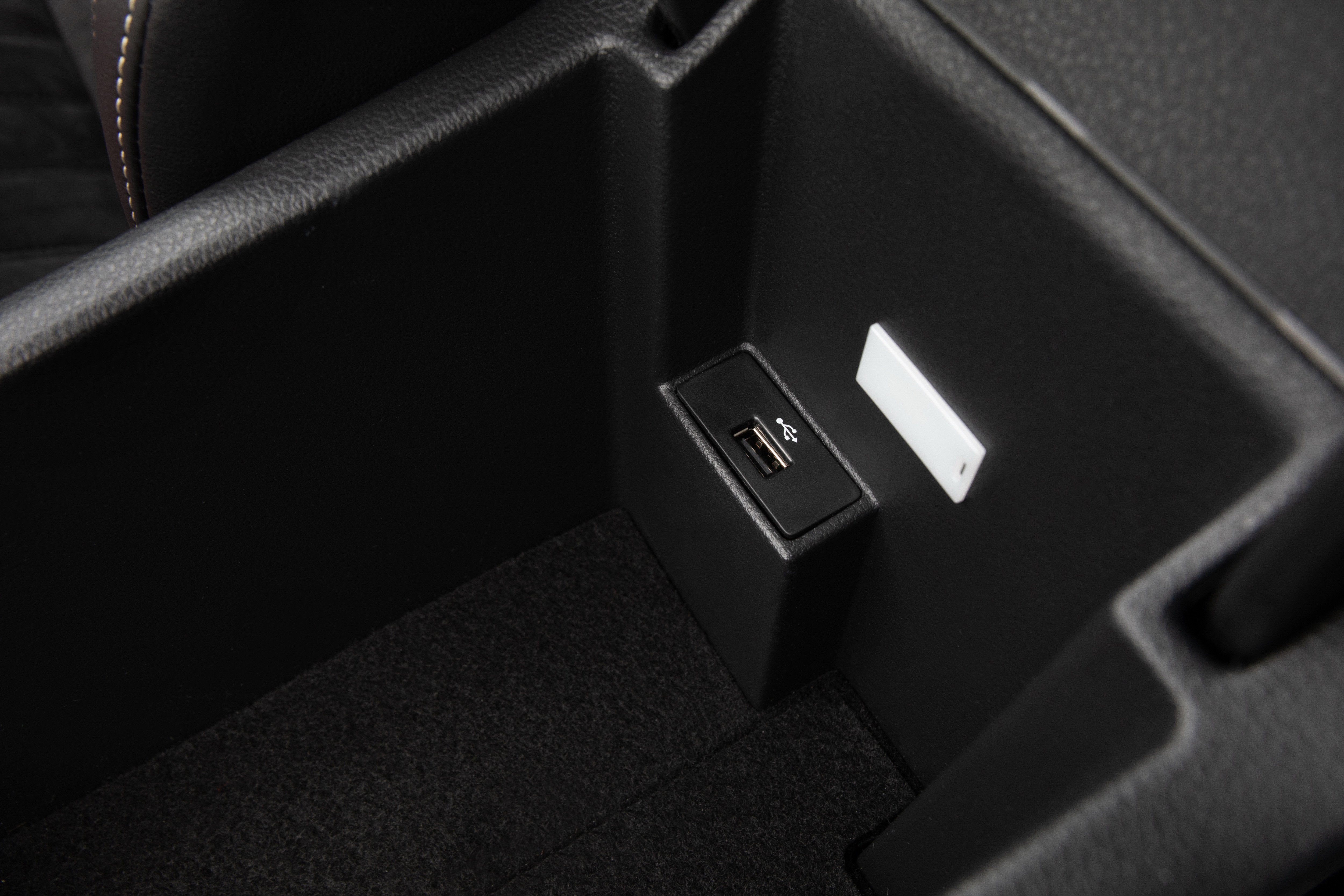

This is how it looks when fitted from factory...
The wiring.......
