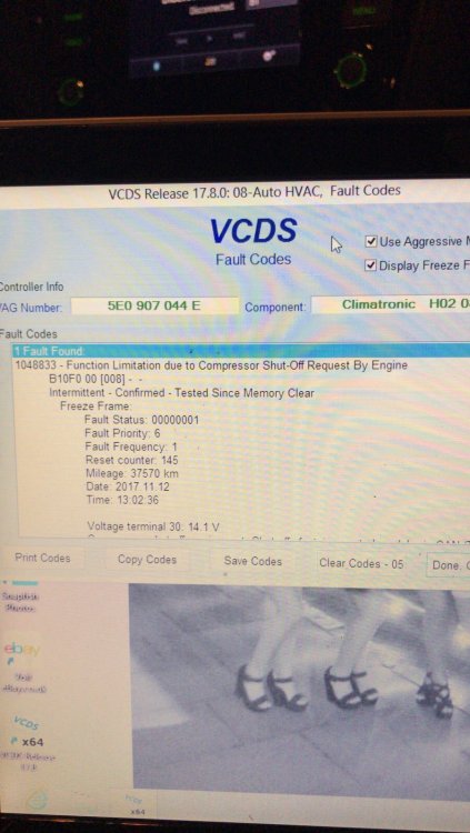

Just spoken to a mechanic whos a family friend and owes me a small favour and hes said he would do the water pump and cambelt for £300 including parts. Im starting to think this is a no brainer and saves all the hassle having to drop the car at skoda for the day getting charged £82 ect. And even if the waterpump gets replaced for free I would still be looking around £150+ to have the cambelt done? My brother has vcds so we will be plugging it in later to see what pops up.

This is the fault code found
Just a Quick one guys, does the vrs have 2 waterpumps an electronic one and a mechanical one? If so which one is to be replaced?  Cheers Josh
