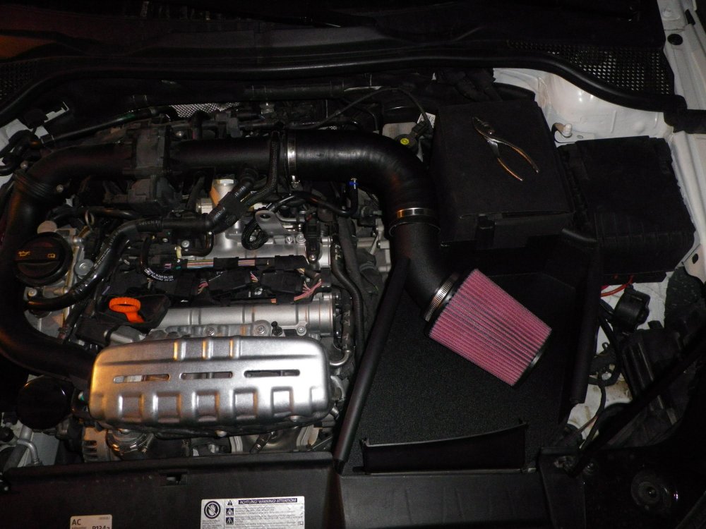

Thanks for the info. Would those mods affect the pipe with the breather mod?

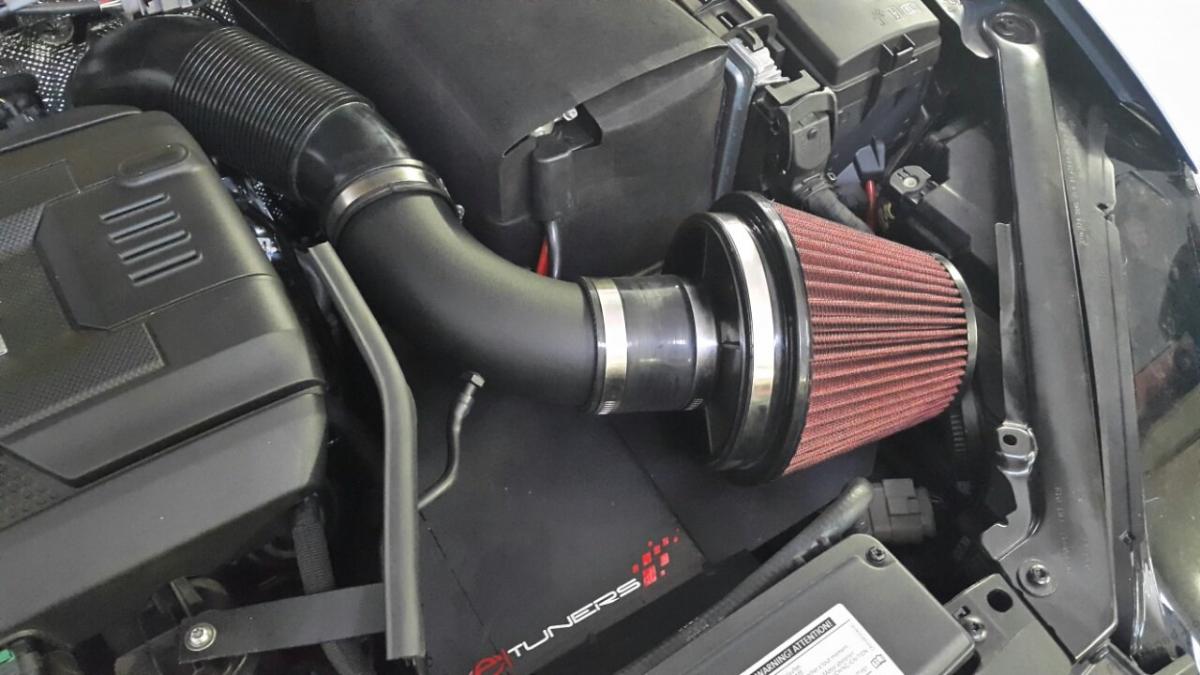

For cars with the breather pipe mod there is a little plastic nipple sticking out on one of the pipes (see pic below), this is where the breather pipe connects to.
Most aftermarket kits have this now, you would be better gains with induction kit than just a filter

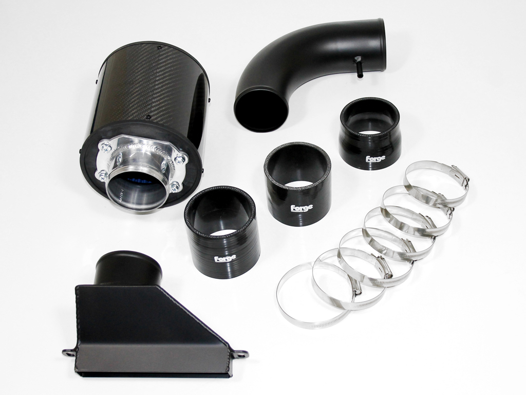

Thanks Kobayash, the forge one looks good.
The second one, does it have the breather pipe connection as well?
Best not judge a book by the cover then, the Forge ones were pants, no idea if better.
