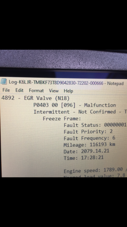

After over 2 years it’s came back to haunt me, over last couple of weeks the glow plug light has flashed on a few times then clears, got car scanned and came up with fault as per pic,  got reset and ran ok for days on end ( lad very surprised who scanned it) that it never came back on sooner.
Last night on way to work it came on again but this time the EML came on also, that was still on today but then cleared this afternoon when I moved the car.
got it scanned again tonight and same fault egr valve.
what am finding strange is the intermittent times it does it and he finds it strange also.

The other common failure associated with the EGR is failure of the N18 solenoid valve which controls the opening of the EGR valve itself. You will need the diagnostic report to determine if this is the case.
So could it be the N18 solenoid ? With it having (N18) on the report in pic I posted ? Or how do you find out ?
sorry about this but we’ll and truly out of date with these modern cars and Packed in being an  Hgv fitter 20 years ago
cheers
Edited by Snapper1725
It certainly looks like the N18 is gone based on that scan. Unfortunately I think it's integral to the EGR assembly but I'm not 100 % sure.

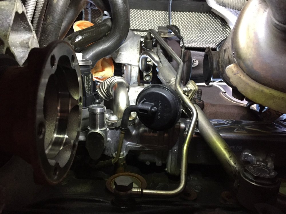

Had a look yesterday, a vacuum pipe comes off the inlet side of turbo which goes to a solenoid on the bulkhead, one pipe off it goes to the turbo but the other pipe goes in to a solenoid above the oil filter ( think that’s the N18 from google search but not 100%)  the one coming out goes down back off engine, which I think is to the valve on the egr valve but haven’t had chance to get underneath or down back for a better look.

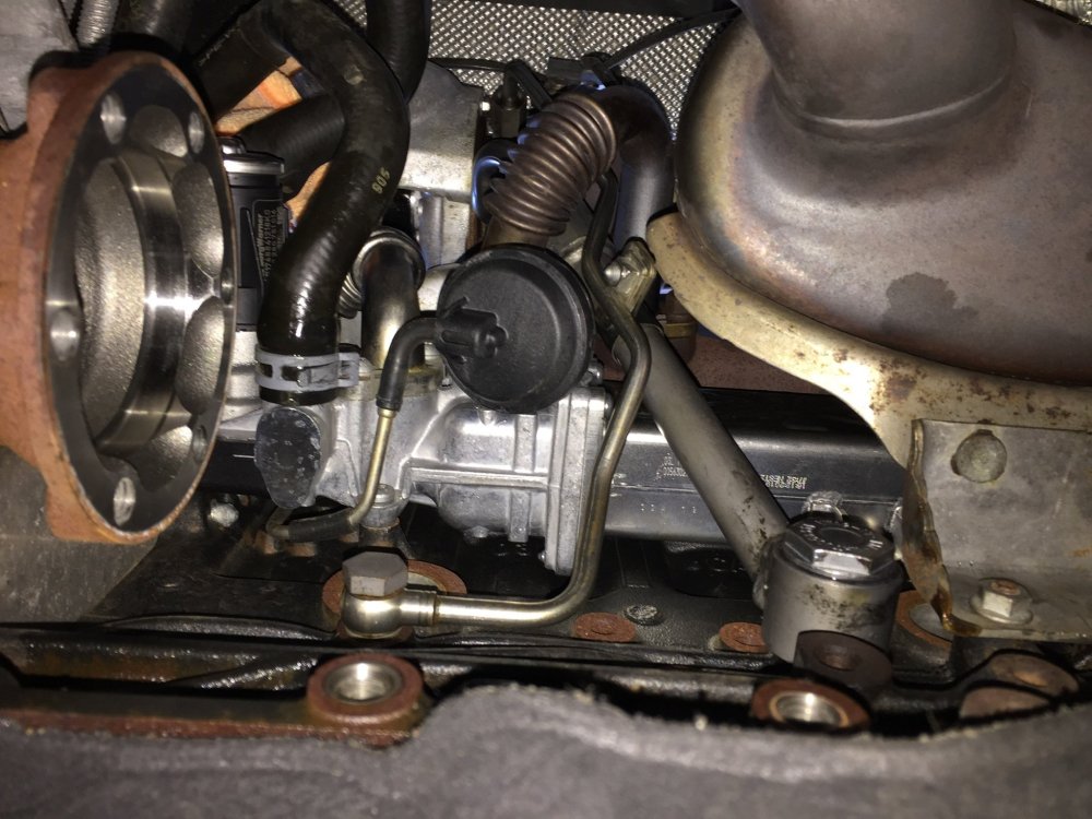

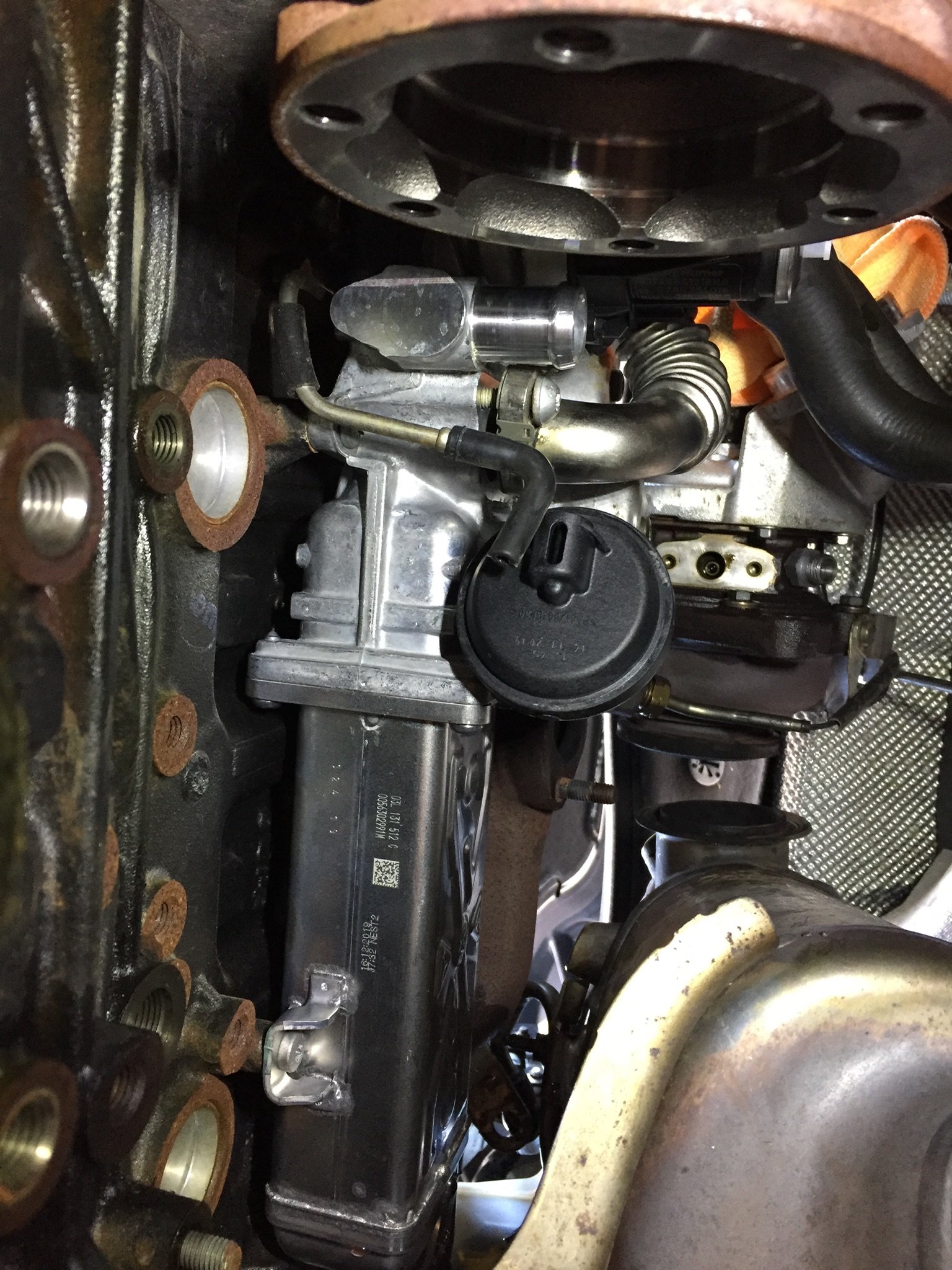

Well it was time to bite the bullet and change the egr valve.
So hopefully all sorted now 🤞
