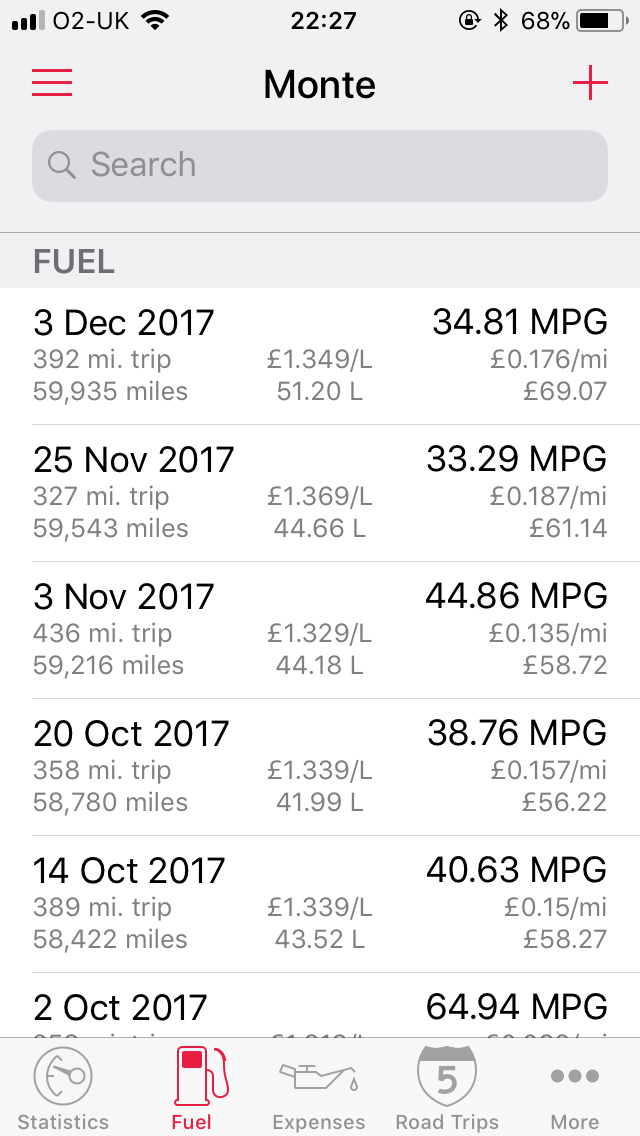

Deffo noticed a decrease since the cold weather :D
i'll go with the weather ;)

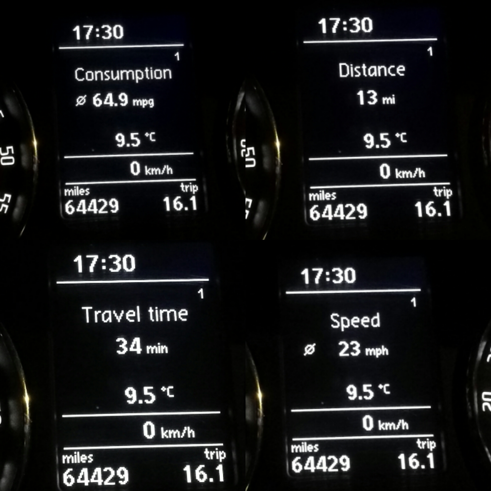

I just used a tank of fuel and it turns out that i have been achieving the same miles as before. The computer was showing 60 mpg average  but when calculated how much fuel i put it and how many miles I've done, it equates to 49/50 mpg.
After the service and cleaning the MAF sensor and the ASV valve it seems to have changed to 50 mpg but the distance achieved is exactly the same as before.
So it was all a computer thing......

So drove back from work today, and that presume economy came back. Keep in mind it's mostly city driving, lots of hills and a few stretches of roads.  65mpg!!!
Sort it out :D
