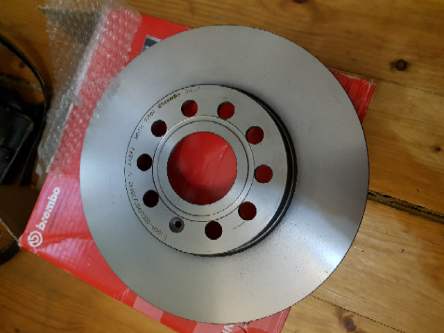

I forgot I bought these on line from euro parts they were %50 off over new year, they arrived today  £50

Done the rears last week , new disks and pads, these are front ones, I bought new  new front as well  pads last month

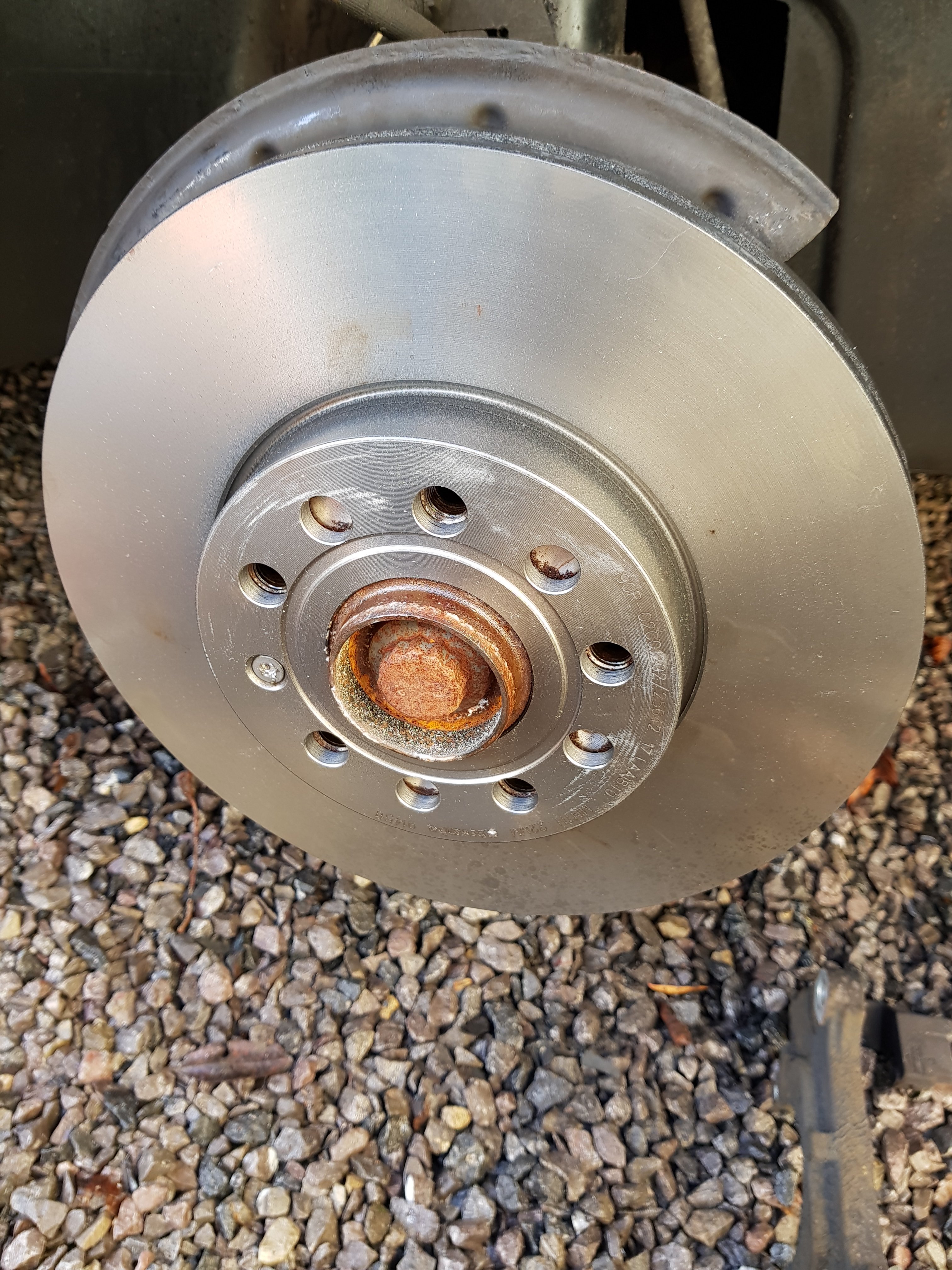

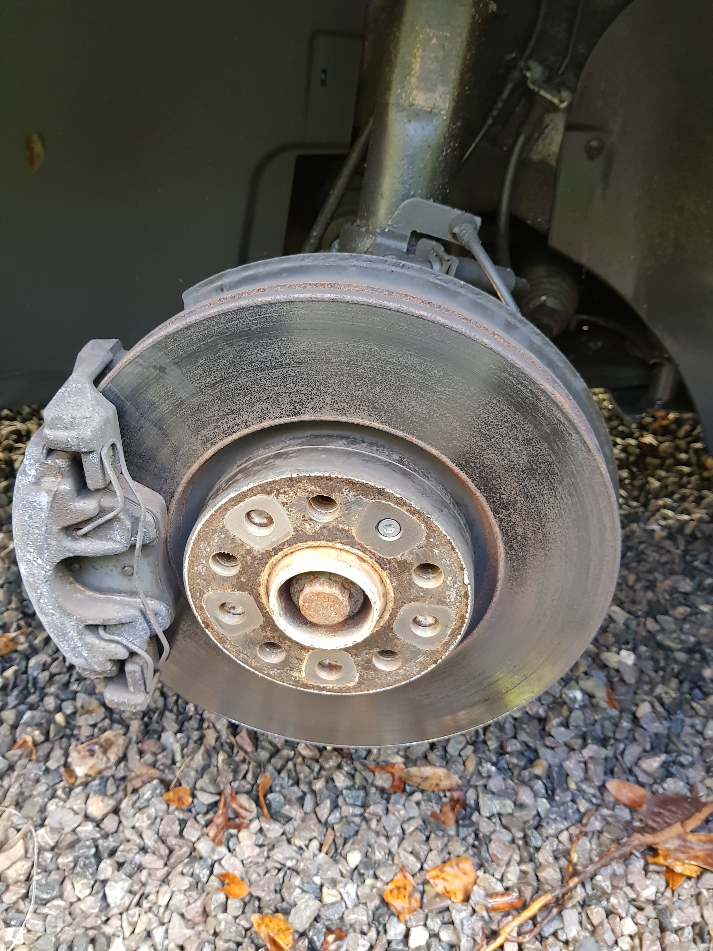

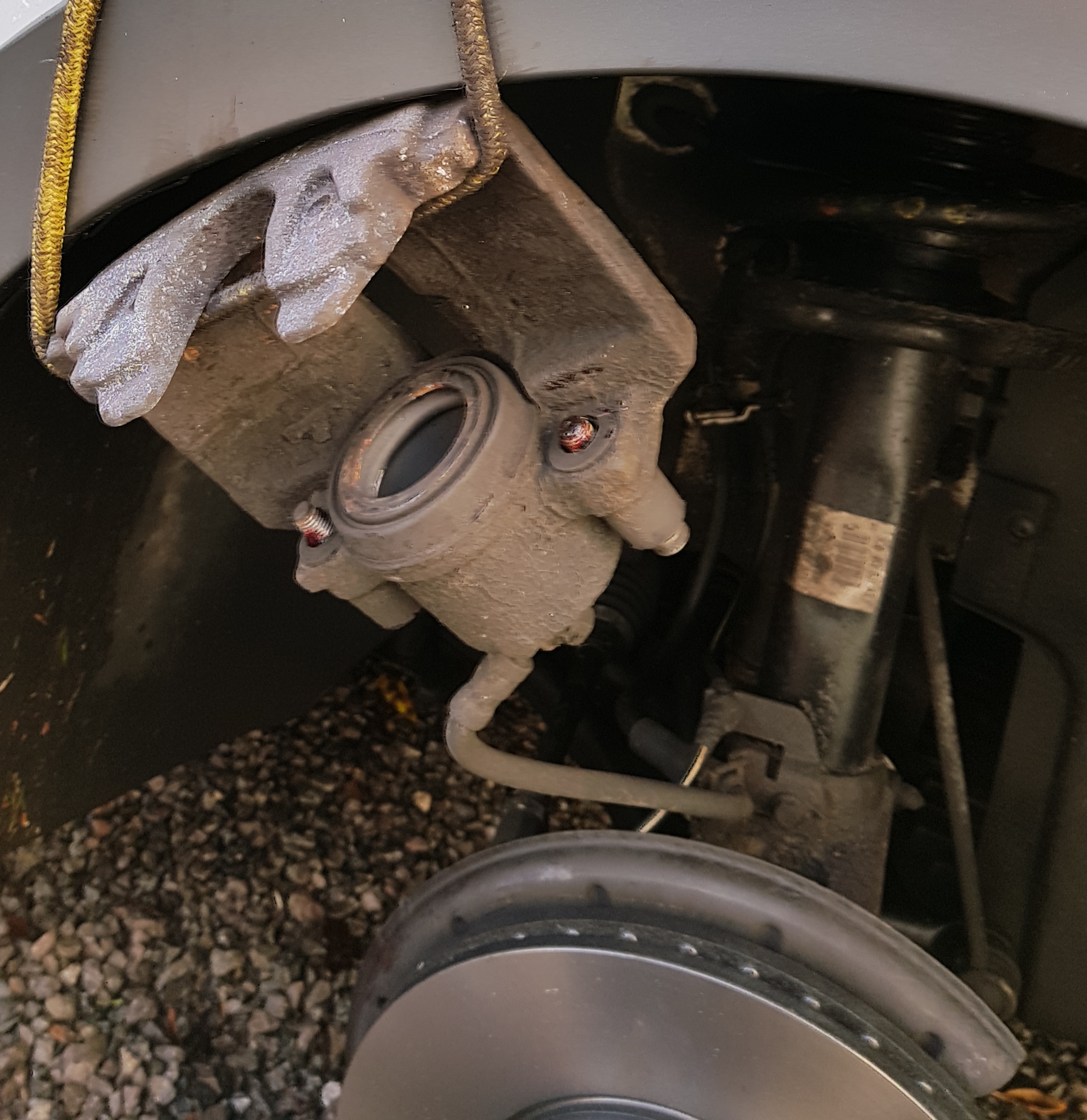

Just changed the front discs and pads, a lot better now. The old pads had plenty of meat on them and the discs looked ok. The braking before was making a noise and the steering wheel shook
The front carriers are held on with 21 mm standard bolts
The old discs or pads weren't worn out just didn't seem to be sweeping the disc area properly as can be seen in the photo, the calipers were free and slid freely on their pins
