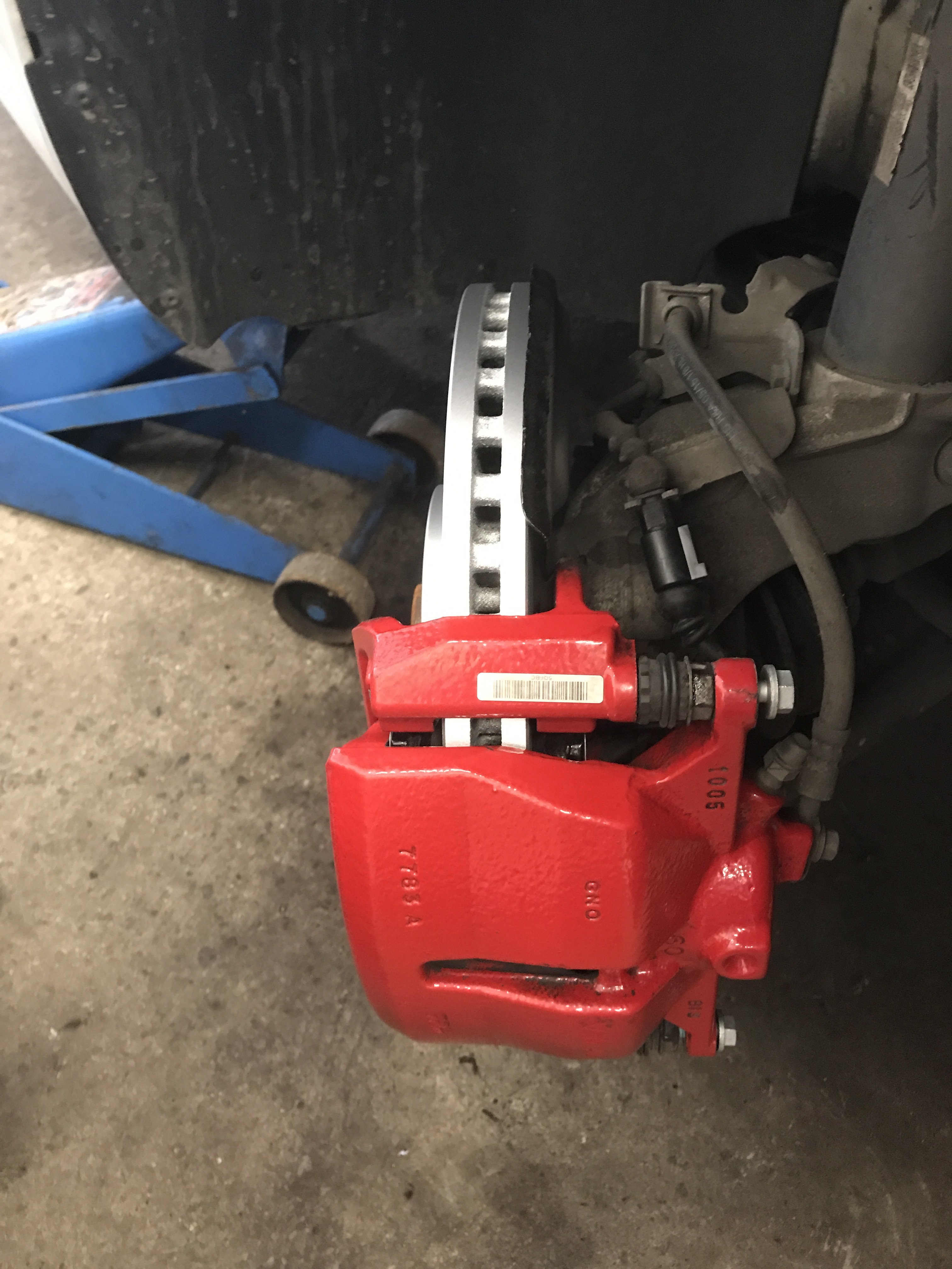

Mine came with the 340mm brakes but swapped them out for some ttrs 370mm brake set up. Now it stops with the extra power

You can pick them up from £500 yes bolt straight on but you need the hoses and I'm running  16mm spacers to clear calipers

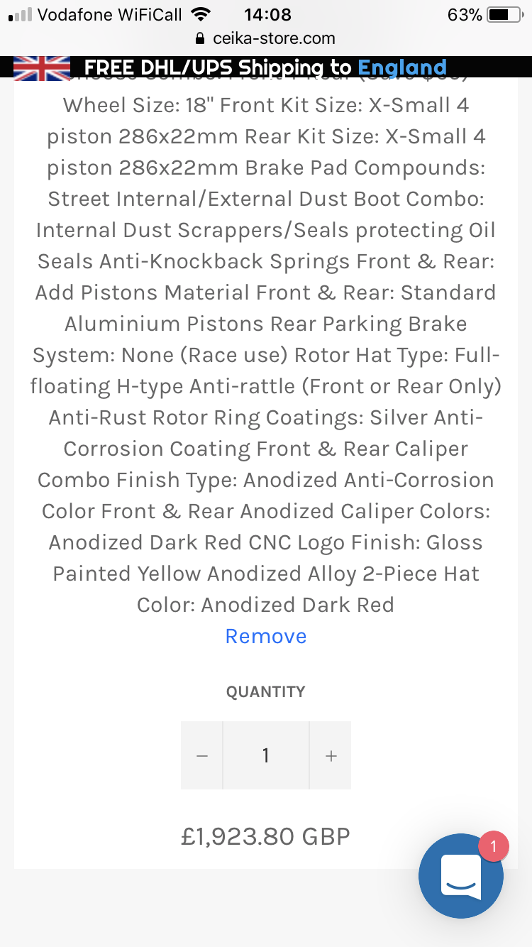

Ive has a quote on the below. Front and rear 286x22mm full floating discs and 4 pot calipers
