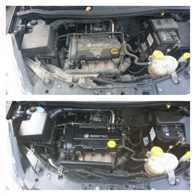

I have heard of people using pressure washers on a engine bay but its not something I would recommend at all...
Far safer method is to get some decent APC/Degreaser, a brush, a couple of old MF towels and a trim dressing.
Start from the out side and liberally spray APC on all the surfaces and allow to dwell for a couple of minutes, then agitate using a soft detailing brush then rinse with the open end of the hose, repeat if required then dry using the MF towels.
Dress all the clean plastics and if you feel the need polish the jubilee clips etc, job done.
Not a Skoda but a recent one which was proper mingingpixlr_20171119123840823.thumb.jpg.4453ec97ab6364a1fa31ad85fb179031.jpg
