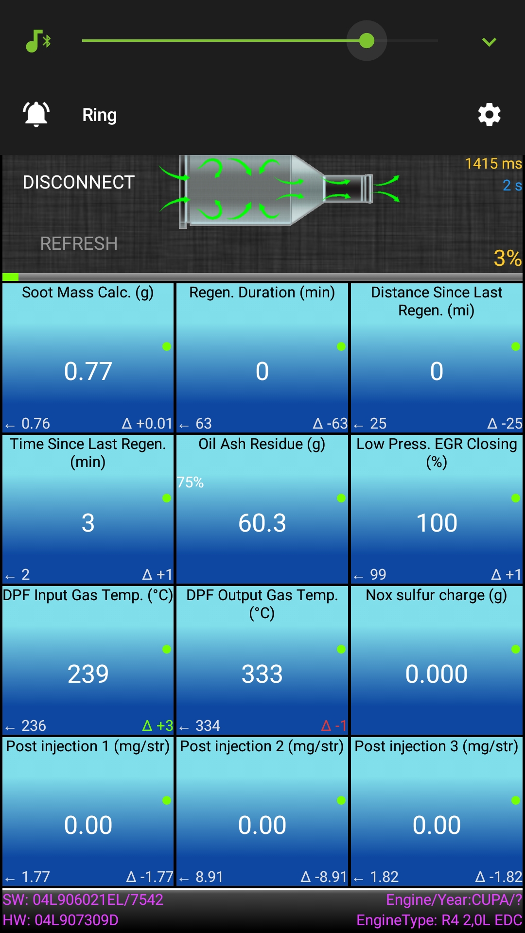

That ash residue is very high, will need a new DPF soon I'm afraid.
3% of soot mass should not trigger regen.
75% of oil ash is very high.
It's either a parameter when oil ash is very high to do regens, or some 'aging' option that prevents regen to complete (seen this in BMW).
However you might have issue with EGR/fuel injectors/etc been disfunctional thus preventing successful regens.
My advice is to connect it to diag soft to check for errors, then force active regen via obd but most probably at the end you will need to clean the DPF :(

Thanks everyone! I'm taking the car to my local dealer today to have them confirm the diagnosis. I'll ask them what needs to be done, and whether it's covered by any warranty. They should also have the service history for the car (which wasn't supplied when I bought it) so that might tell them if there's been a gap in servicing where someone might have put the wrong oil in, etc.

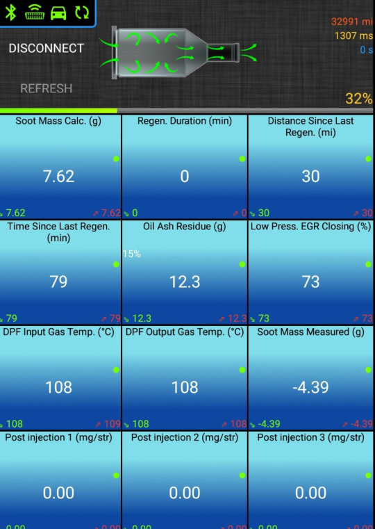

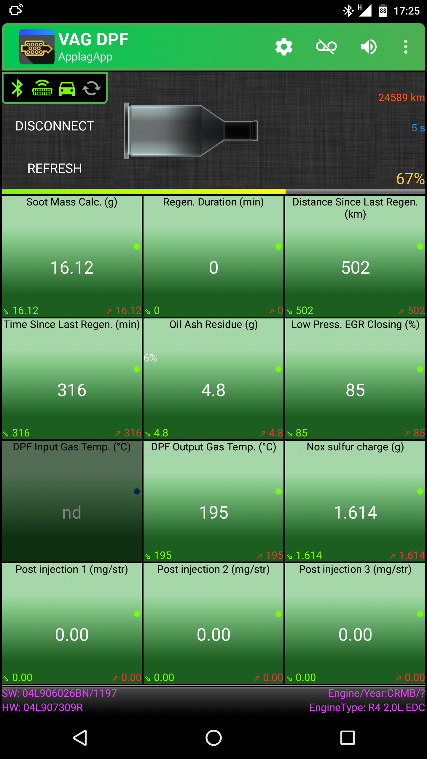

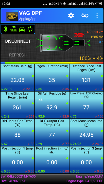

Thanks for this post. I was wondering what was the "normal" values with this app. On mine (2.0 TDI) with about 33k miles, the readings are as below:

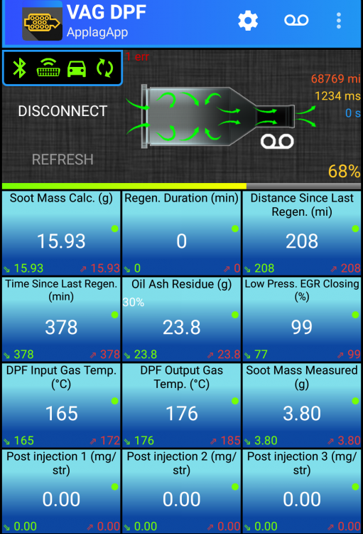

Mine is a 1.6, with nearly 69000 miles. My figures are similar to the ones above (albeit doubled!).
Edited by J_D
Formatting
2.0 TDI 150hp. Mainly highways and country roads. Maybe ~5-10% city driving, not more. In kilometers.. ~15000 miles
Edited by TTodorov

Spoke to the Skoda dealer down the road today. They were initially skeptical of "my app", told me to uninstall it and reinstall it :dull: but after they plugged the car into their diags they basically confirmed the same readings. They agree that the oil ash residue (60.4g or 75%) is way too high for the mileage and reckon the DPF has less than a year left before it'll need replacing. They said it could be down to the wrong oil, or something catastrophic happening in the past such as a turbo blow up.
