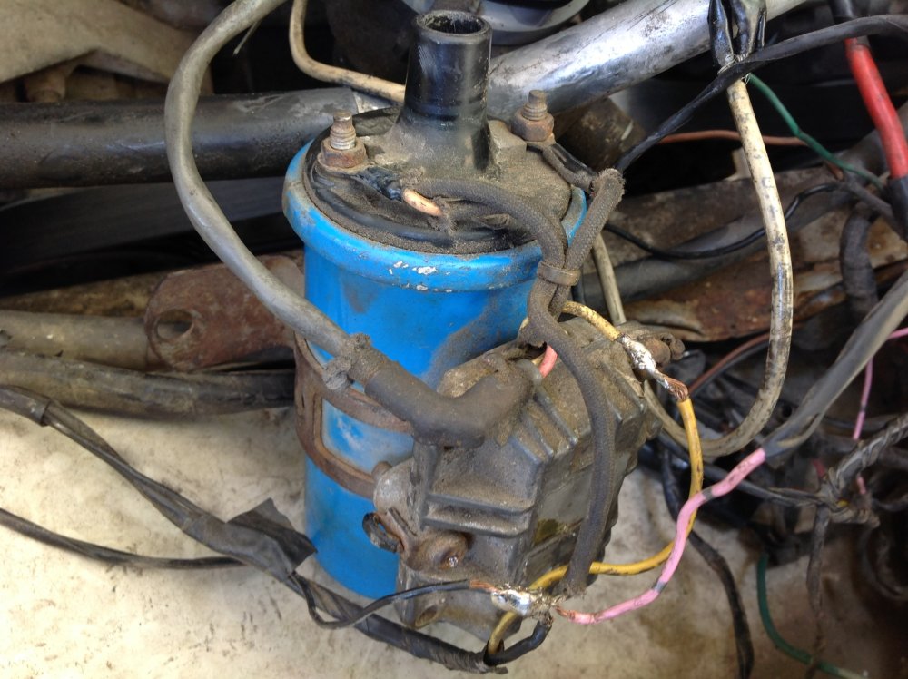

I need to replace the ignition coil for my skoda felicia 1.3 but I'm not sure about the right part to order.
Currently I'm using a Bosch ignition coil, the blue one with a Toyota module attached to it. That's the way I received the car.
But since a few days ago I feel a loss of engine power, running with a little bit of misfiring. The ignition cables are OK, new ones.
The spark plugs are new, Bosch. I took the car to two different mechanics, both agreed that the coil is at fault because is not producing a strong enough spark.
So, which ignition coil and module are the right for this car?
Thank you!
OP
Ignition coil: 047905115
Ignition module: 6U0905349A
