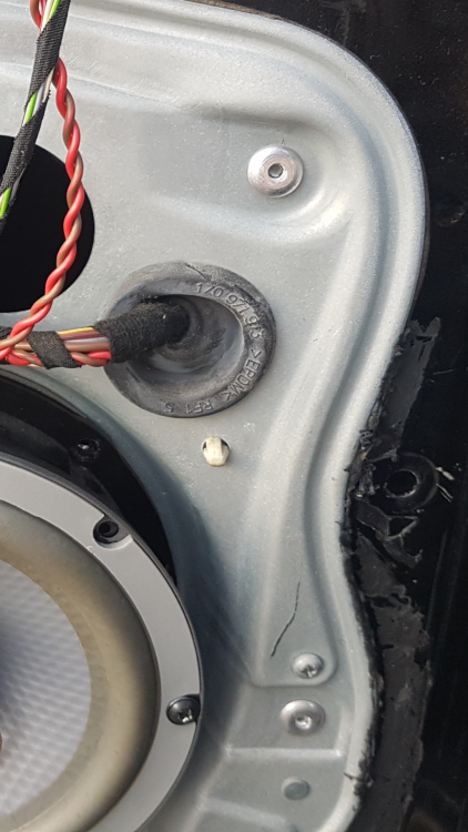

it is good practice to use new rivets. however when i bought my fabia vrs (6y) back in April, I needed to carry out some mods to the door speakers,
as one was actually beyond repair and sounded awful.
Anyway, when I took my passenger side front door card off, I noticed that the aluminium skeleton, had previously been removed to carry out repairs,
and on either side of the panel, there had been a self tap screw, into the body of the door, so there was one on the left most point, and one on the right most point.
in my opinion, the previous mechanic had been lazy, but it proves that you can secure it back to the car with self tap screws.
I didn't have the correct rivets or a rivet gun for that matter, and put the screws back in to secure it. as this was my most logical option at the time.
I had the same fault as you with the window going down and not coming back up, it was the cable for the regulator that snapped, you should still be able to hear the motor working when you press the switch,
and some very painful noises, you just need to replace the whole thing, i got mine for about £65 + vat from TPS - Trade Parts Specialists.
PART NO. FOR THE PASSENGER SIDE REGULATOR - 6Y1 837 461  - this fits my car, pretty sure yours is the same - Skoda fabia 1.9 VRS 54 plate
when I had this fault, was when I went  back in and re secured it properly with rivets, as i'm certain that the screws were causing it to rattle (because it wasn't secured all the way round)

I agree to disagree.  My holes were not ovalised, nor am I saying the job should be bodged. I'm just demonstrating that it can indeed be done, if one does not possess a rivet gun. I did agree that the screw method is not a solution it's a temporary repair, hence why I've properly Installed the carrier, you can see the screw just below the rivets I'd put in that day. They'd probably been in there for about 6 months with no issue.
