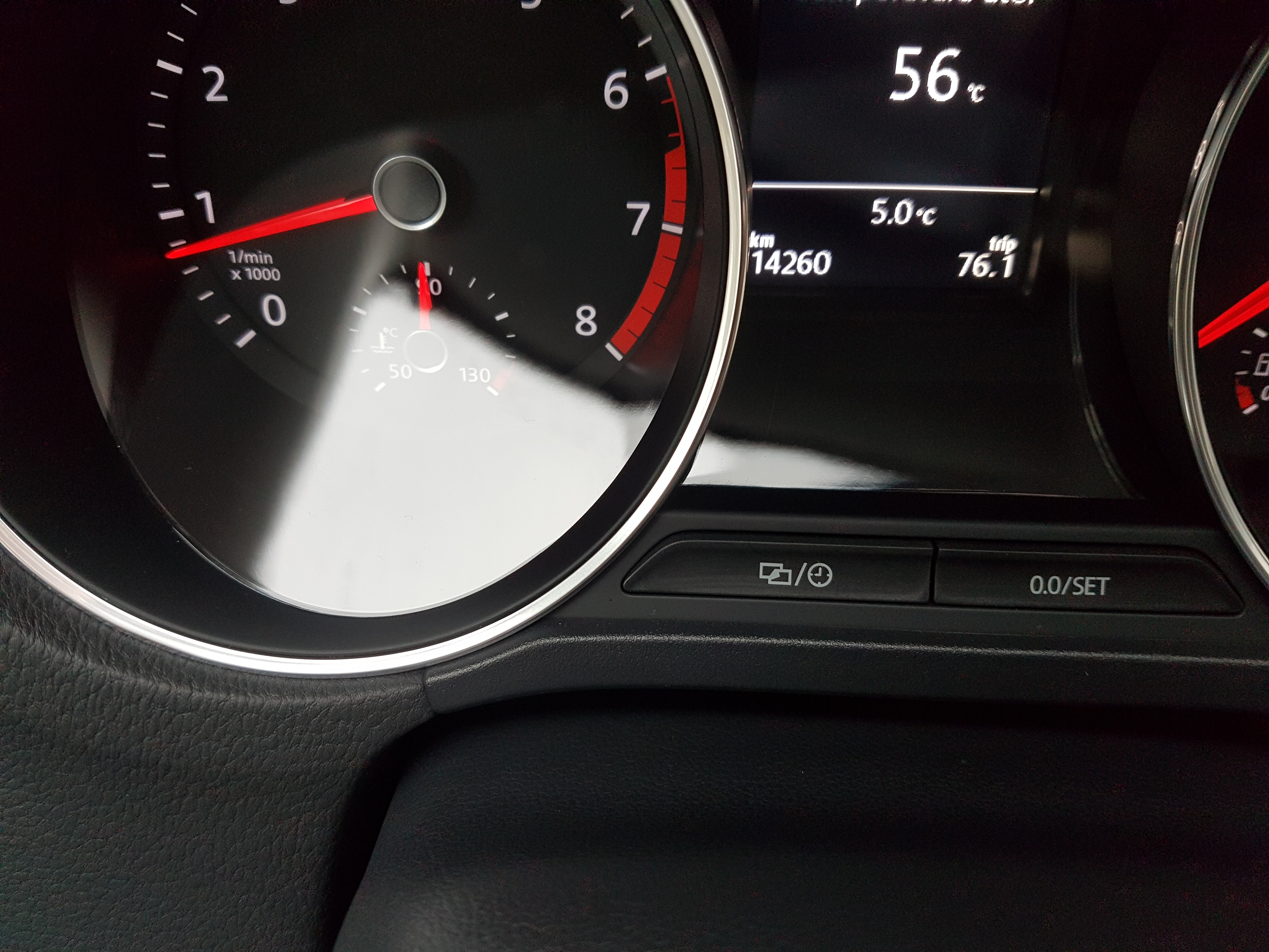

Here is an example on the Polo this morning. However, 10 minutes later they were both at 90 C.
