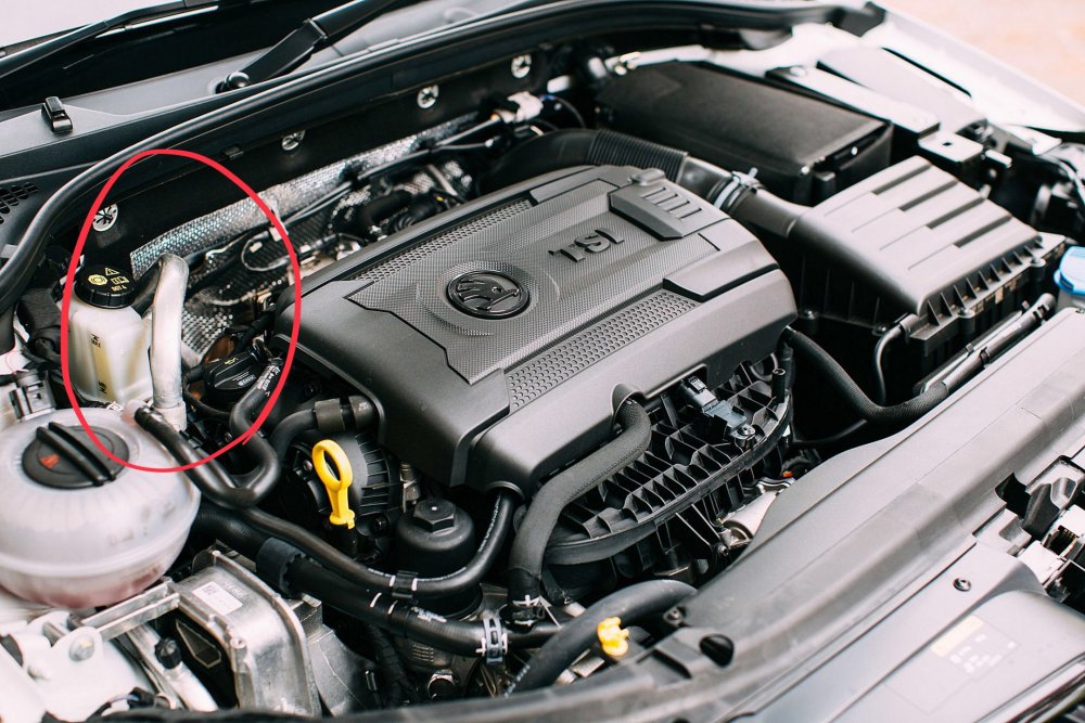

The heat seems to be emanating from the area circled in red.  Presumably, it’s a pipe which circulates hot water.

In the area you circled in red there is the turbo which gets pretty hot in a few minutes after you start the engine.
I would say normal operating temperature for the turbo is above 200 Celsius so the bonnet above should get pretty hot.
