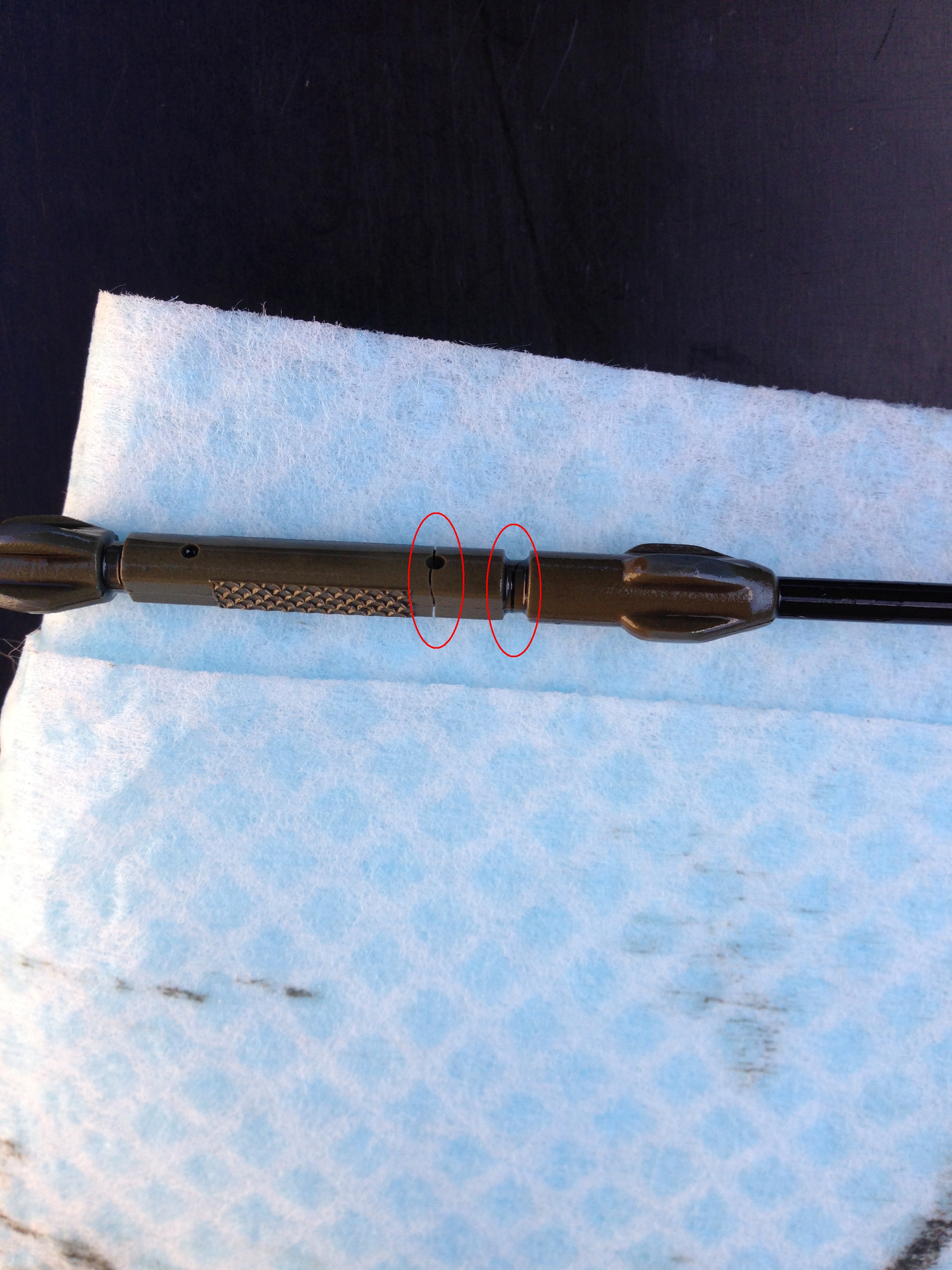

Oil was changed today. The dipstick doesn't match either of the examples shown in the manual. But I found this image online which does match, and the markers were as I had worked out.
Having changed the oil putting the same amount in that I got out, it appears a little high, in the D zone. But as per the Note in the image, this can be normal, apparently, and it will self-correct. So my question is, what causes the oil level to be too high like this?
Second thing: exactly where the 2 is on the image, the maximum indent, my dipstick has a crack. I guess I'll have to replace it, but how big an issue is this?
A big issue if it breaks.

OK, thanks, I'll go ahead and get a new one. I wouldn't be surprised if other people have cracked dip sticks as it's quite weak at that point, and could easily go unnoticed. You really have to look very close after cleaning that inside part of the dipstick. Might be worth people checking their own.

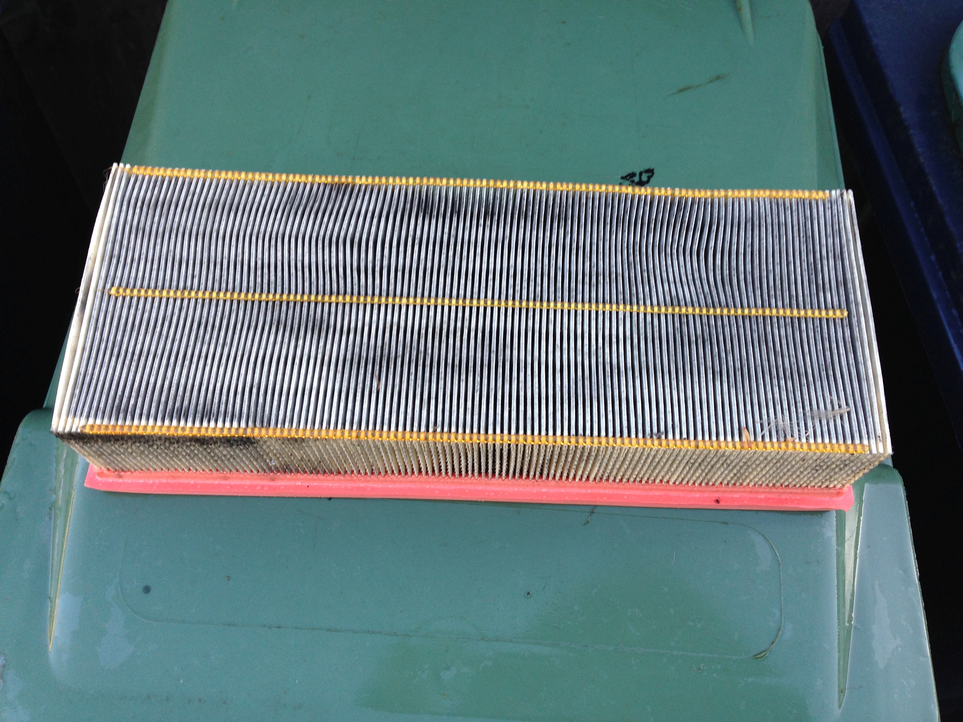

I also changed the air filter, even though not due according to the schedule. Think it's the original. Looks past its best in my opinion.

here's a pic of the cracked dipstick. New one on order from dealer for £11.36 including VAT. They're both at weak points but even so I can't see how this damage would have occurred. Only thing I can imagine is someone put it in part way and then applied a lot of side ways pressure rather than downward pressure pushing it in. Wasn't me, obviously.

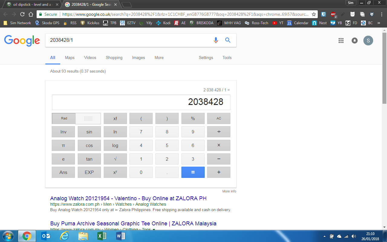

Technical product information Transaction No.: 2038428/1
Service information: DPF regeneration impossible / increased engine oil level
Release date: 03-Oct-2014
30 minutes ago, chimaera said:
Thanks for the 'clickable' link...
If Google doesn't know, I... (the average driver) doesn't know...
