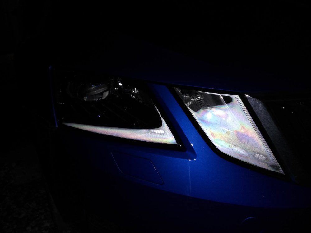

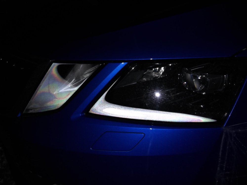

Bought a brand new Octavia III facelift with full LED headlights (AFS) this January.
On the second day of ownership i noticed mild condensation / moisture inside the headlights. It develops near the DRL which happen to be the most forward pointing part of the headlights and probably also the coldest.
The lights are all LED, so they don't heat up much when running.
On the third day the moisture has got worse. I'm worried about the lifetime of the electronics and the reflective surfaces inside the headlights.
I'm thinking of trying to dry the headlights (by either canned air, hairdryer, silica gel or whatever) but these LED headlights seem to be a closed unit with only an electricity plug on the back side. No big rubber cover as with the old halogen lights.
  • Is the condensation to be accepted?
  • Can I somehow open the headlight to dry it?
PS: I have contacted the dealer, but am waiting for a reply.

So I contacted the dealer who said that previously (i.e. some years ago) they would have changed my headlight units. But then the factory has apparently changed the criteria for when a replacement is offered. They need to conduct a test of my vehicle at the Skoda workshop. The test is simple: they leave the car in idle with the lights on for 1 hour. If the moisture is still there, Skoda will replace the headlight units. The Skoda mechanic stressed that I should not expect the moisture to diminish while driving, as the ventilation in the headlights will keep drawing in moist air from the outside.
After one month ownership I can summarise my experience down to:
1. The moisture was most prominent in the few days after delivery. Probably moisture from the assembly line, transportation or storing of the vehicle before being driven in the cold.
2. Moisture level is now very low and only occasional. Most of the time there is no moisture in the headlights. But every time there is a significant drop in outside temperature the condensation comes back.
3. Having the headlights turned on does not generate enough heat to evaporate the condensation.
I have learned to live with the moisture, and the problem is for now below what Skoda consider as an error. Still it looks crappy and cheap on the parking lot...
