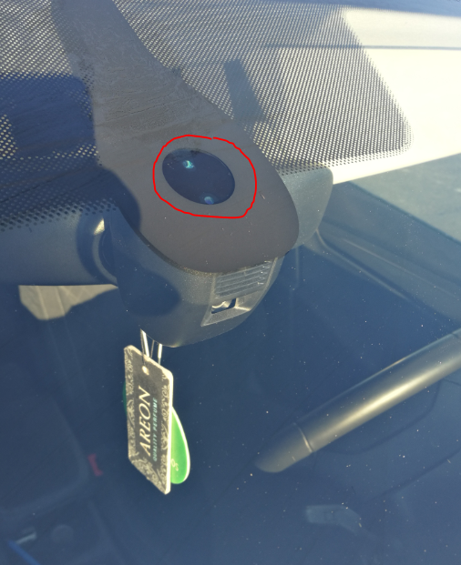

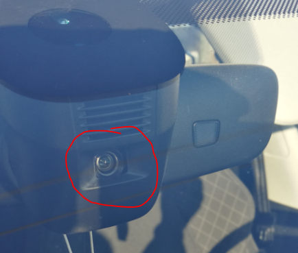

Hello guys, i'm new here, just found this forum.
Mine Skoda karoq 2018, 1,6 TDI, have this kind of camera on the mirror, actualy below it. What does is says to you ?
Can i ask, is it possible to get lane asist and road/speed sign recognition ? via vcds or other way ? It's not V shape camera above mirror, what is mentiont in this thread.
Still have, auto brake, parking sensors at the back only, front asist, auto high beam, DRLS, dont really know what to mention more at the moment.
Photos :
https://ibb.co/MkGf1RJ
https://ibb.co/qNsdpxP

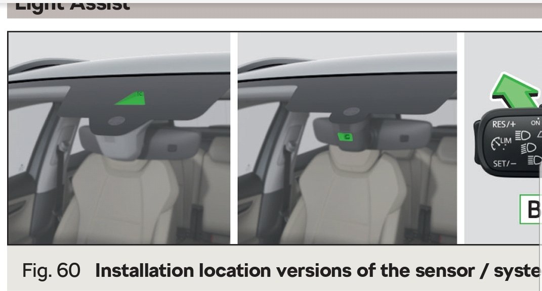

That is the light sensor, according to the manual. I don't think that your car has the camera for lane and signs recognition, because mine has the camera and I have the version with the triangle.

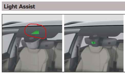

This is the light and rain sensor (circled in red), it is used for the automatic turning on and off of the dipped headlights and operation of the automatic windscreen wipers...
This is most definitely a camera...
Given the specifications listed for the car, it appears that it is being used for the 'Light Assist' feature (automatic switching between dipped and high beam headlights).
To benefit from the other features you would like (Lane Assist and Traffic Sign Recognition), I suspect you'll need the camera that is absent on your car, the one behind the triangular aperture...
You're right, @silver1011!
Sad to hear.
So the only thing that could do the camera i have, is dipped and high beam headlights, correct ?
Or is it anything more, that is possible to achieve from it ?
Anyway thank you for the fast respond. Amazing community here.
Yes, This is just FLA mirror
