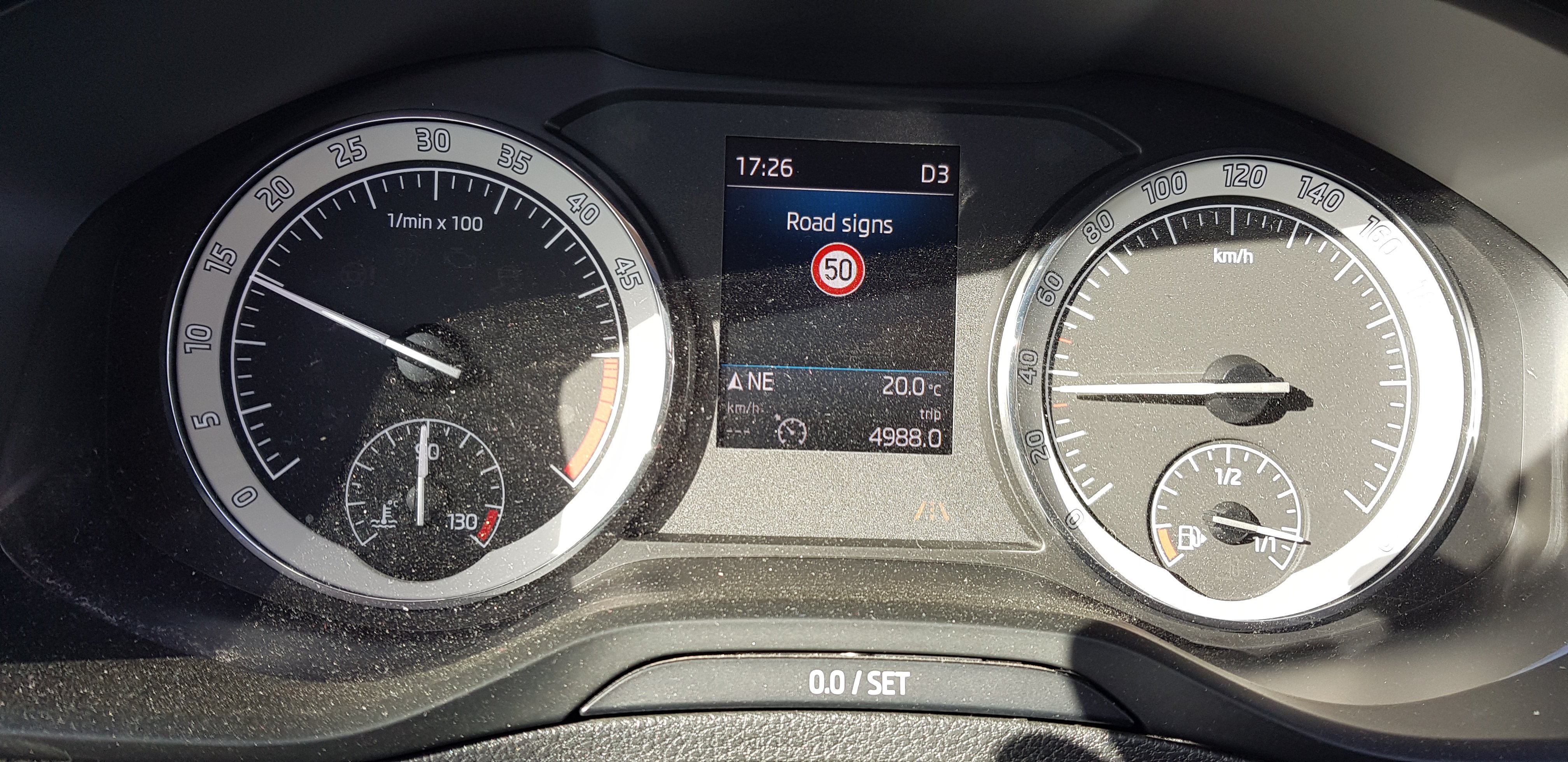

Tested Today the new feature. The system works in a fused mode with navigation, meaning that the read road signs overwrite in navigation the speed limits known from the map, if they are different, while the limits known from the map are displayed if no road signs are available, especially when starting yo drive. In any case, both instrument cluster and navigation will display the same value. Great benefit that I can now visualize in Instrument Cluster, of course, the speed limit, even when I don't use the native navigation. I can now also compare it with the speed limits displayed by Waze.
Thinking about the morality and the legality of enabling this feature, by putting myself on the Skoda side, I would say that I invested money to develop it, I request money from customer for it, but with some tool that doesn't belong to me and which, very probably, had unauthorized access to my CAN database, someone managed to enable it and to not pay anything to me. Is it OK? Of course, being such a great feature for a  safer driving, it should have been included by default to the standard equipement, but, unfortunatelly, who ordered my car didn't includ it, even if it would have cost less than 100€ to a car which had a price list of almost 40k €.
