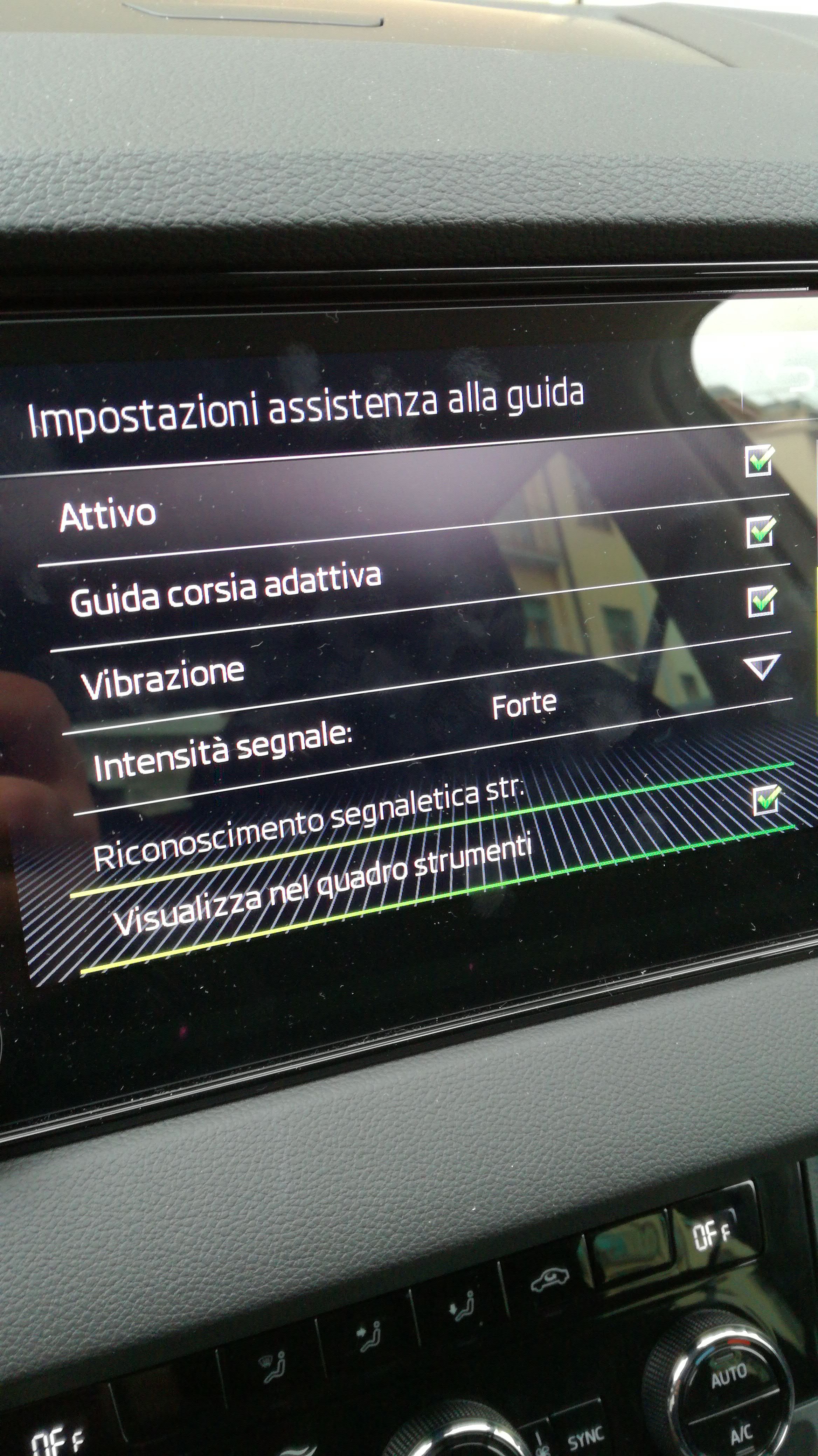

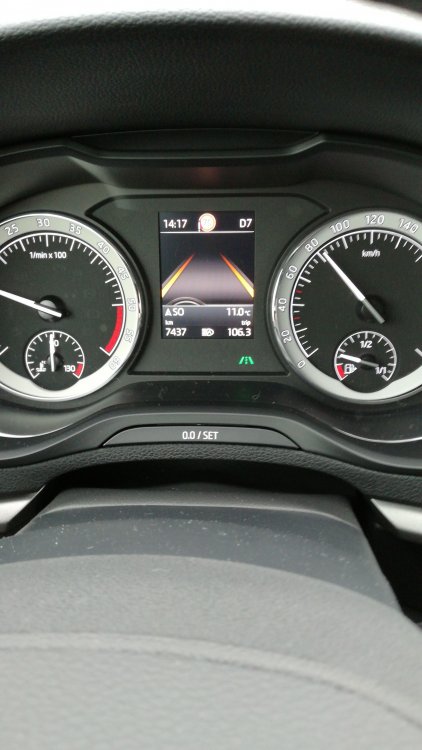

  • I received my OBD11 earlier this week and have managed to implement some nice changes including: Traffic sign recognition, auto high beam (light assist), mirror dip, acoustic confirmation of lock
  • Well, as we're leaving the EU thats not going to be a problem is it??      When I collect mine I will insist it's activated.

So it supports conclusion that Road Signs work in most western EU countries while in the East and rest of the world they don't.
12 hours ago, pa_ko said:
Rozpoznávání silničních značek funguje ? V jaké zemi se nacházíte? Ptám se, jak vypadá, že v některých zemích není možné aktivovat silniční značky (je možné je aktivovat, ale nefungují spolu s daty s posádkou). Takže se snažím shromažďovat zkušenosti a zjistit, co se děje.
road sign recognition works
Czech Republic

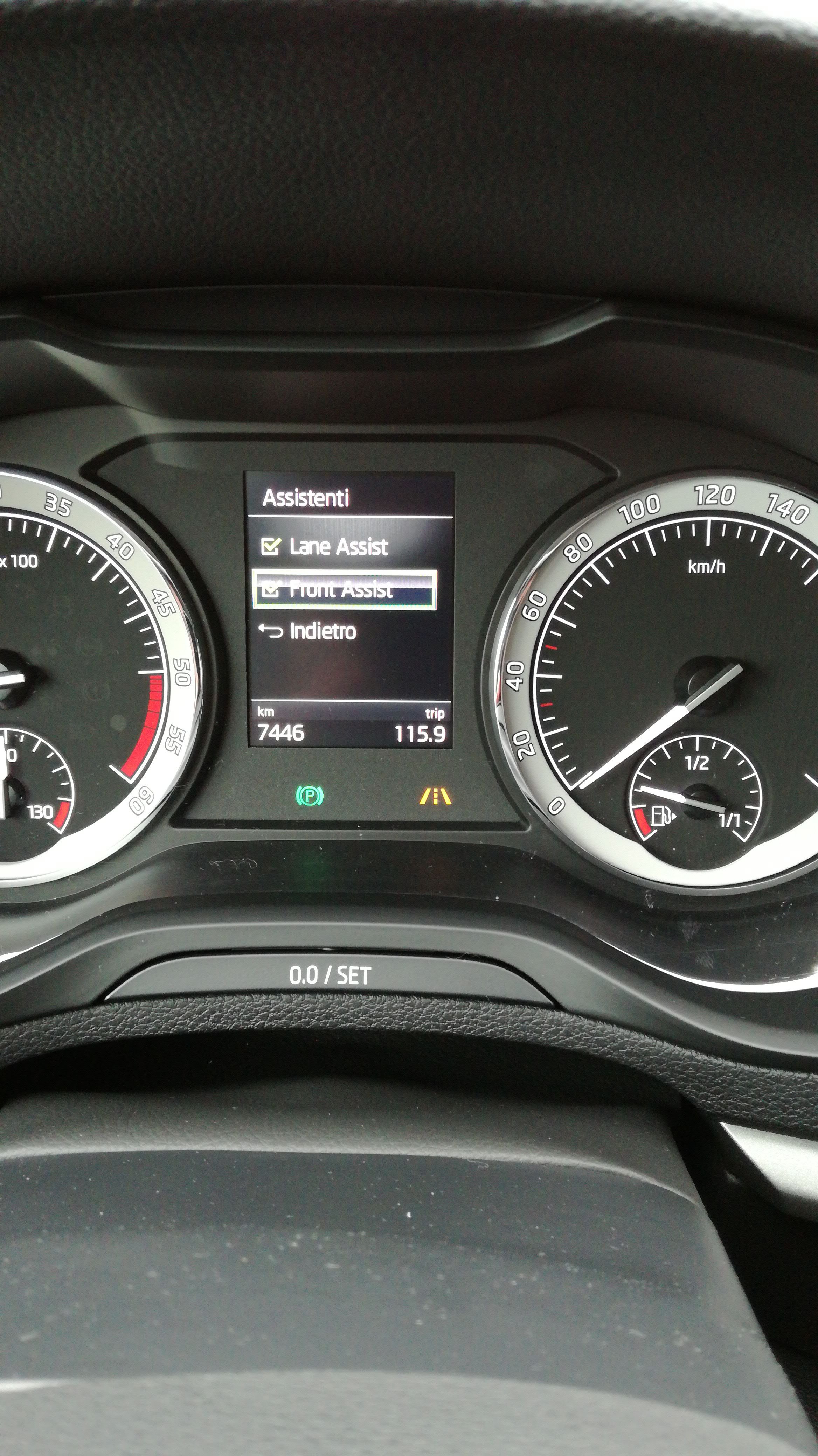

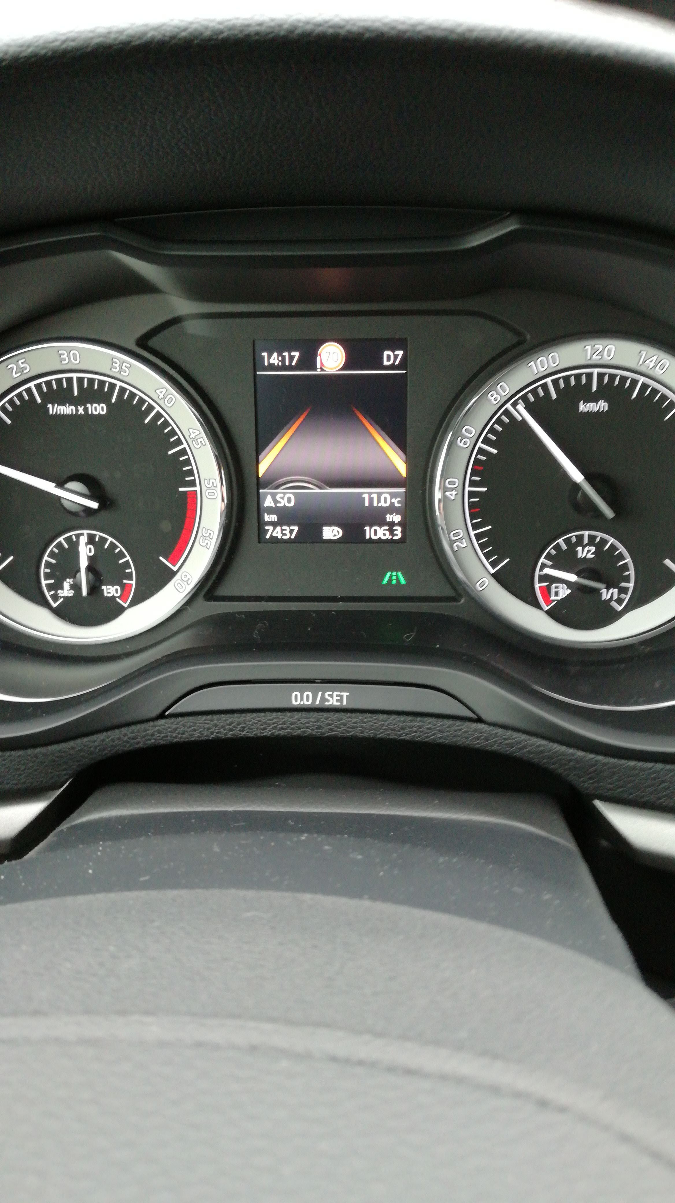

Good morning, many thanks
Lane assist attivato

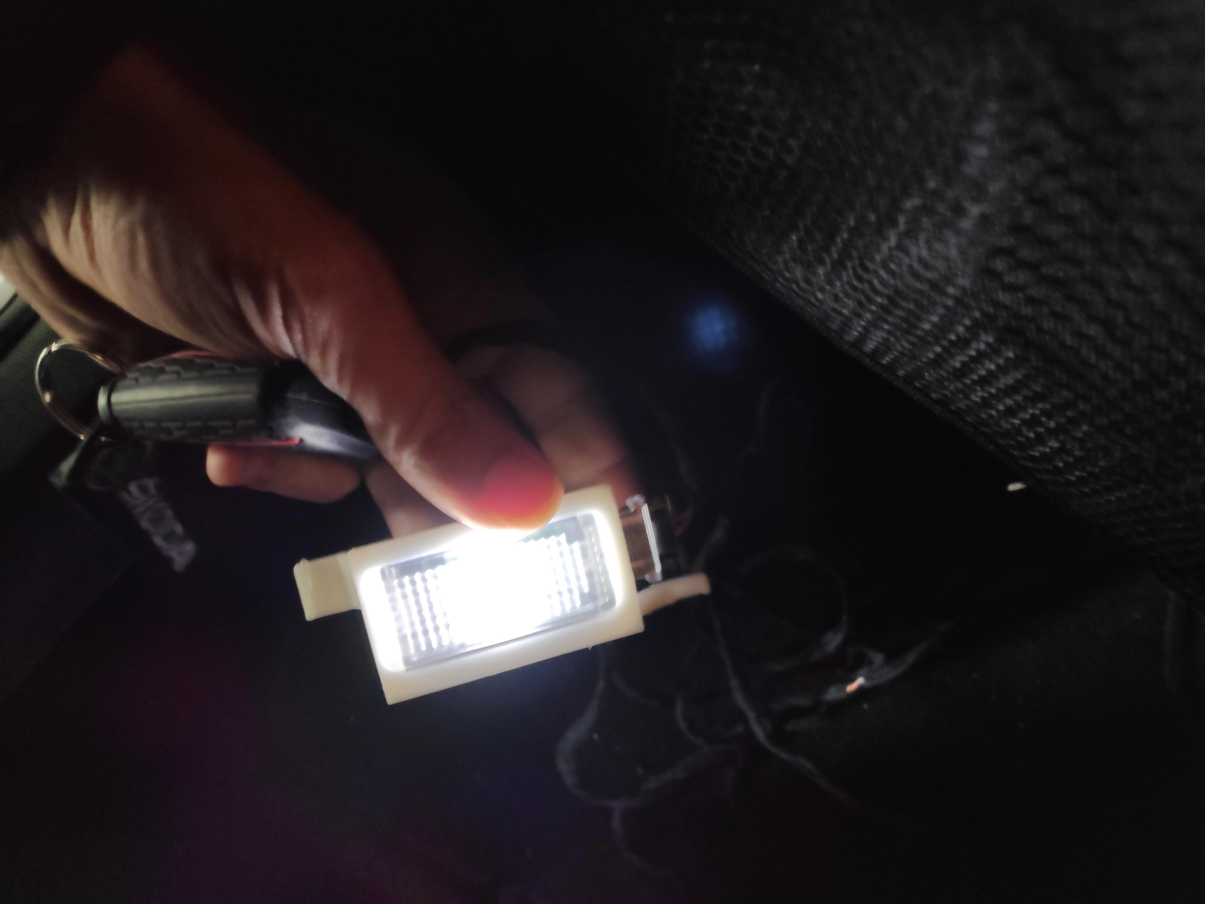

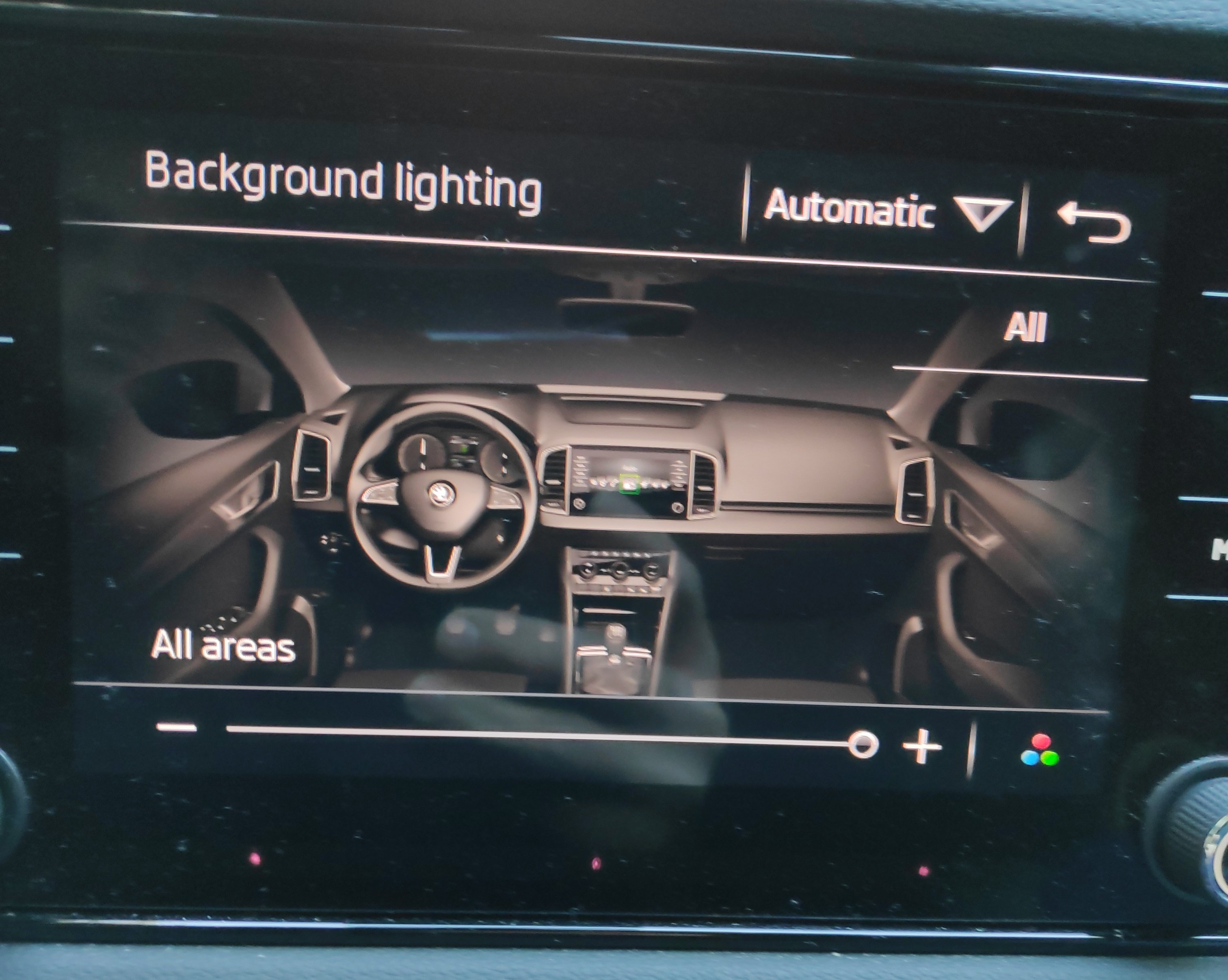

Is anyone retrofited footwell lights ? i just did and i followed these commands and
I can see the lights working along with the sallon lights, Open the door footwell 100% , close the door footwell off,
open the lights footwell on.
but the slider in infortainment system makes no deference , it doesnt work.
EDIT :
The cable of the positive wire , is connected to BCM 5Q0 937 084 CD
pin C 72
I believe that it have to be connected to another pin or there is another VCDS coding sequense
Controller 09 - Central Electronics
16 - Security Access - enter 31347
10 - Adaptations
Go to
 Leuchte30FR LC72-Lichtfunktion A 30
Change this value from ‘not active’ to ‘Footwell light’ from the dropdown menu
Leuchte30FR LC72-Dimmwert AB 30	= 100
Leuchte30FR LC72-Dimmwert CD 30	= 100
Leuchte30FR LC72-Fehlerort mittleres Byte DTC-DFCC 30	= 2
Leuchte30FR LC72-Lasttyp 30	= 36 - LED Kleinleistung
Leuchte30FR LC72-Lichtansteuerung HD AB 30	= Always
Leuchte30FR LC72-Lichtfunktion A 30	= Footwell light
Leuchte30FR LC72-Lichtfunktion B 30	= Terminal 58xs dimmer
Leuchte30FR LC72-Lichtfunktion C 30	= Interior Lights

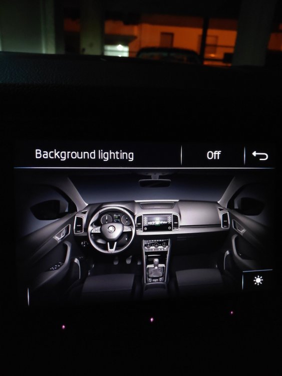

in the meanwhile there is also the B50 that some people use ,
i guess that the only way to make the Footwells light work , is if you enable this from MIB2017-skoda-kodiaq-22.jpg
After more research i found this commands
Int. light, 2nd generation: weicher Farbwechsel: active
soft colour change-not neede
Int. light, 2nd generation: Instrumententafelbeleuchtung mehrfarbig: active
AID colour- needed
Int. light, 2nd generation: Mittelkonsolenbeleuchtung mehrfarbig: active
center console colour-not needed
Interior light, light configuration: Ambiente_Applikationsleisten_in_Instrumententafel: installed
needed
nterior light, light configuration: Mittelkonsolenbeleuchtung: installed
again Center console- not needed unless you have led in the Center console
Interior light, light configuration: LIN-Dachkonsole lokal aktivierbar: active
roof consol- not needed unless you have LED’s in the roof

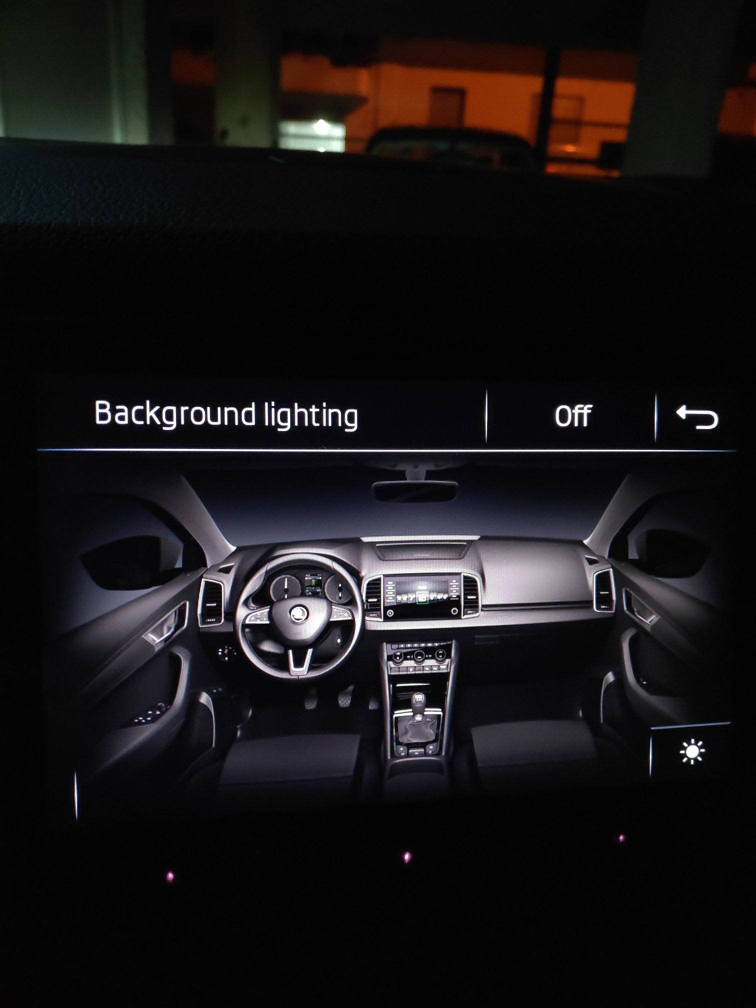

Interior light, light configuration: Fussraumbeleuchtung is to enable footwell lights
Interior light, light configuration: Ambientemenue mit globalem aus: active
gives you a off button in background lighting to switch off door and footwell lighting
Interior light, light configuration: Ambientemenue mit alle Zonen: active
Adds the “background lighting” buttons in settings- needed
Interior light, light configuration: Ambient_Farbliste_HMI: active
gives you the colour slider at bottom of background lighting screen- needed
After that the Background Lighting Menu appeard but i have no control to dim the Footwell lights
anyone can help?
Edited by Tezaman

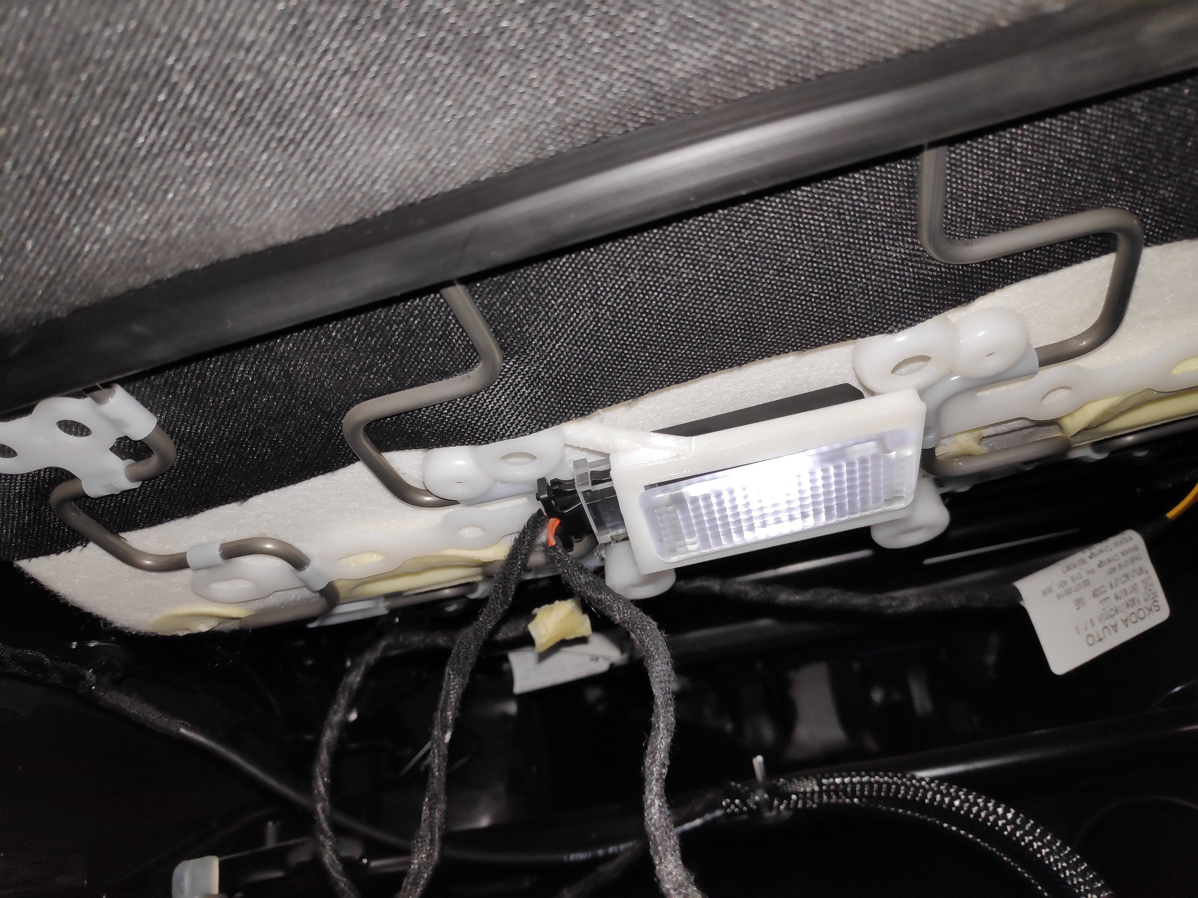

I also intend to add footwell lights. Front and back. How did you add at the back?
The programming is the itch!
from the aliexpress suplier , i got a kit with a pre made wire harness , and 4 led lights
The best way is for some one with footwell light from fabric, to share their scan, to confirm the configuration.
How did you installed in the rear seats? I can’t find a place to fit them.
i am preparing a 3D printed Bracket
ypu can order this also
565881547 Light Holder
Edited by Tezaman
Today I did a proper restart on MIB by holding the button 10secs.
And the slider come alive !!!!   I can dim the footwell lighhts as ambient lights while driving..!
The only thing now that I have to enable it's the graphics on the MIB that shows the intensity of the footwell light
https://www.thingiverse.com/thing:3420703

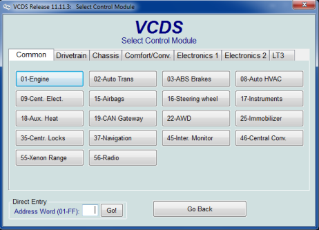

Some codings are explained as follows:
Select STG 09 (vehicle power) STG Access Permission -> Function 16 Enter access code 31347 STG adjustment -> function 10 Channel ...
or
Select STG 17 (instruments) STG adjustment -> function 10 Select channel display depiction
Where is the STG menu or button? I am missing something. My VCDS is 18.9
