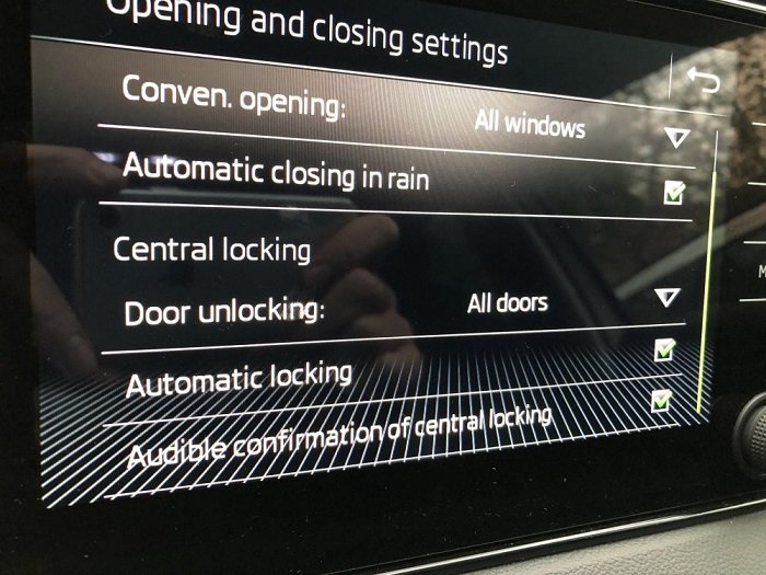

  1. Go to [09] Central Electronics
  2. Go to Secuity Access and enter 31347
  3. Go to adaptation channels and set the following:
  4. - (15) Access Control 2 - Regenschliessen_ein aus (Rain Closing on / off) - Select Active
  5. - (16) Access Control 2 - Regenschliessen_art (Rain closing Type) set to Permanent
  6. - (28) Access Control 2 - Menuesteuerung Regenschliessen (Menu Control Rain close) – Set to Active (enables the menu in the ifotainment screen)
  1. 9 Central Electronics
  2. Rain and light sensor
  3. Byte 0…Enable Bit 2 “Regenschliessen aktiv”. (rain closing active)
  4. Bit 1 should be active too….Regenlicht aktiv (rain light active)

On 05/02/2019 at 10:55, irfant said:
If the car has got automatic wiping then rain closing can be coded. The car doesn't have sunroof
Irfant, have you tested? Does it work on yours? Did you use the coding that I suggested?
Not tested the coding.
PS: Rain closing works fine. Tested on rainy day, also water sprayed from a bottlle triggers closing...
