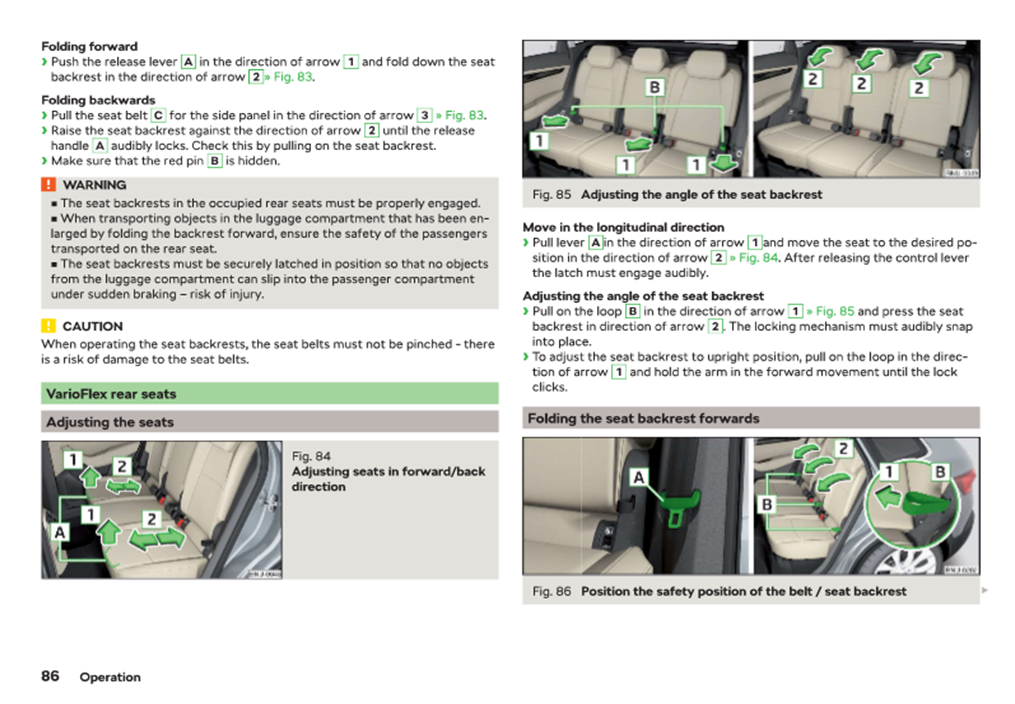

I'll double check tomorrow if I get a chance but from memory there isn't a handle under the middle seat (unlike the outer seats) and the manual only shows the outer seats as moveable so I'm pretty sure it doesn't move - it does recline alright though.
i believe manual :giggle:
It's a bit hazy as it was the beginning of January and a fairly quick test drive but I do seem to remember lifting a handle below the middle seat I was sitting on to push it backwards. Didn't work so I got out and that's when the salesperson had a go which worked.

this should clear things up
