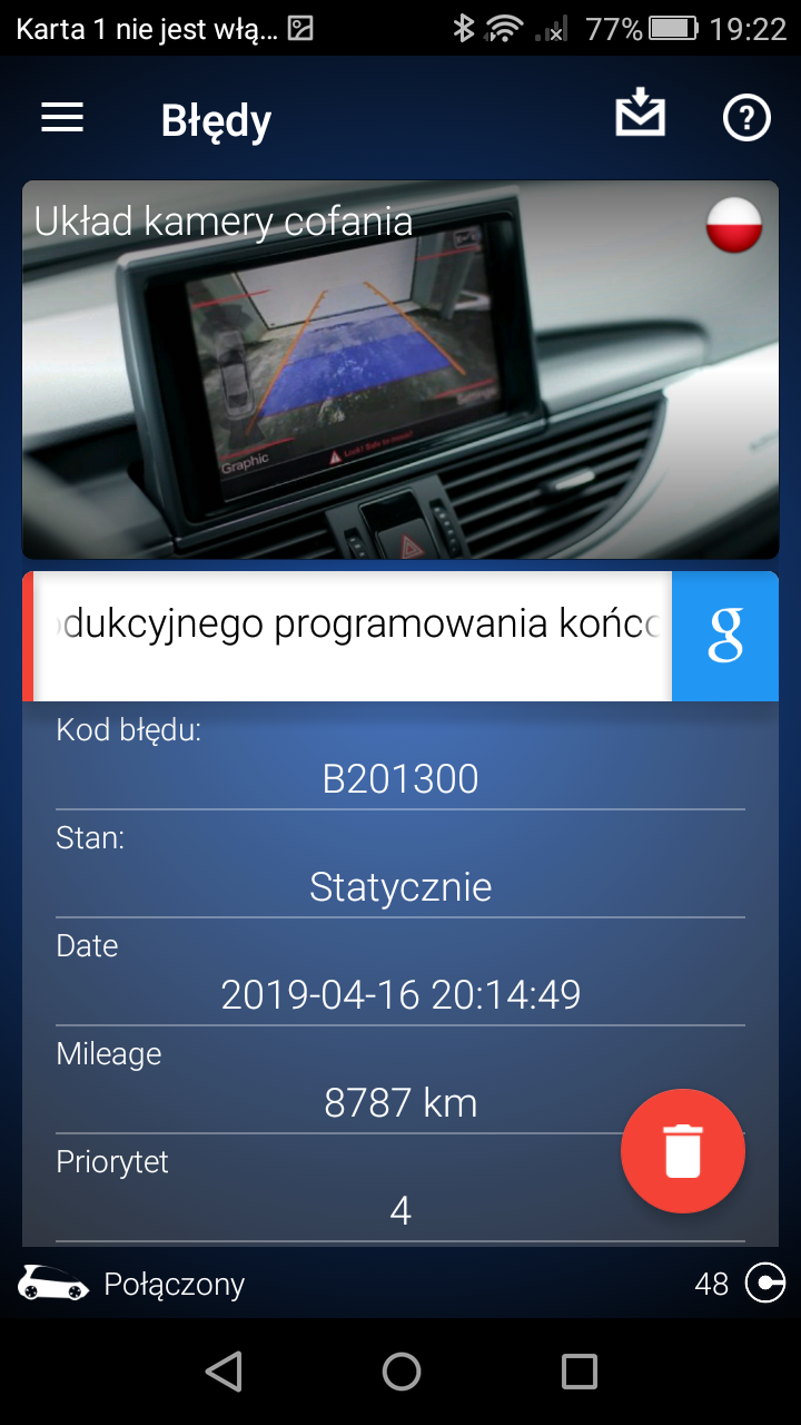

when I bought a new camera without software I had errors: B201000 no basic settings, B201300 no final production programming, U101300  driver uncoded, the camera cannot be coded by VCDS..... Only after load the software using ODIS, the camera can be coded.
