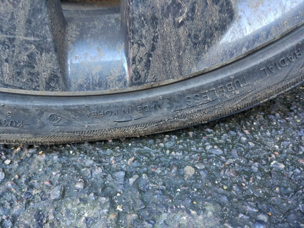

Is that tyre damage anything to be concerned about?
Tyres are 1.5 years old and only have 13k on them. It's the front left side. Been over some nasty pot holes lately. :(
Edited by Chibakun
The AA recommend that any damage to the sidewall resulting in bulging or tears mean the tyre is not safe and should be replaced.
Yes looks quite serious damage - it is a big weakness on ultra low profile tyres - they do not cope well with potholes etc.
I have friends who have had complete tyre failure on these sort of tyres owing to hitting potholes/road damage.
Personally I stick to 16'' wheels for that reason - our roads are now in a deplorable state,I do not do any night driving now unless I really have to - at least in daylight one has a sporting chance of avoiding potholes.
In some areas up here we end up doing an almost constant slalom through road defects LOL
Have you had the wheel off and looked at the other sidewall?
Don't risk using a damaged tyre anyway.

I'd not be going on the motorway with that tyre myself.
Replace - Immediately!

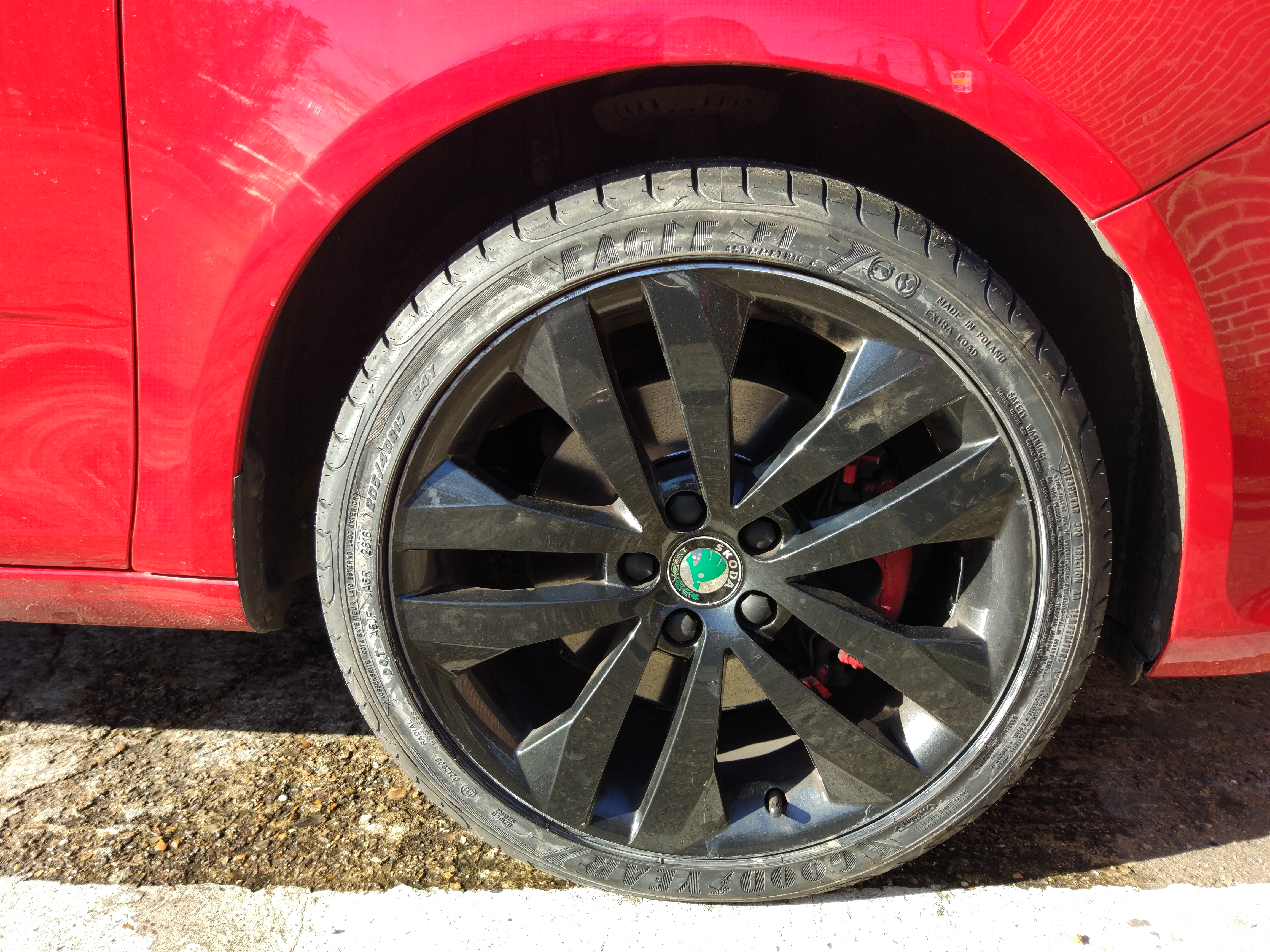

I've ordered 2 Goodyears
2 hours ago, Chibakun said:
I hope the rim isn't damaged inside.
Used those on my fabia for 2 years and rate them highly

Goodyears fitted
