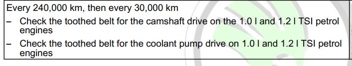

Skoda maintenance manual says inspect 1.2 TSI camshaft and water pump belt after 240000 km. It does not mention age at all.
240000 km for a cambelt seems a lot to me.
Some cars will never get to 150,000 miles if they do 5-10,000 miles a year.
I would like to see a 12,000 miles a year 1.0 / 1.2 engine going 12 1/2 years without a water pump needing replaced.
So as for that service schedule that needs taking with a pinch of salt.
