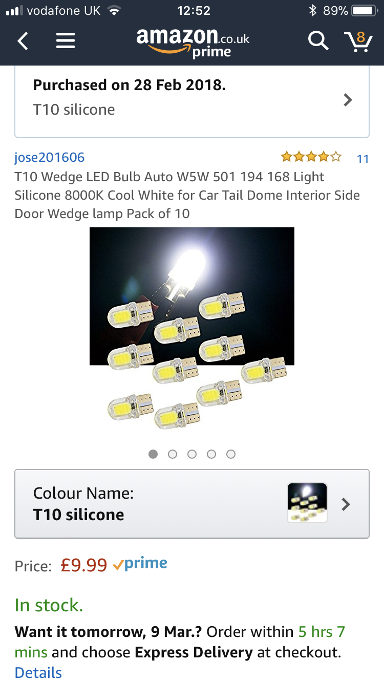

Do you mind me asking where you got the LEDs for the interior? It's an upgrade I'm considering for my own car at some point.
The LED I got off amazon, they are perfectly ok for the job and fit everywhere apart from the glovebox which has a festoon type bulb. I did the footwells, boot lights (in the tailgate for an estate), puddle lamps in the mirrors (glass out and use a pair of long nose pliers to pull the waterproof grommet out) and all the overhead lights. Just be aware, when you take out the footwell lights and boot lights you have to remove the metal cover to gain access to the bulb, it’s not that easy to remove the cover, just use a tiny flat blade screw driver. The bulb is fiddly to get out and the new one back in but it can be done. Also bend the contacts for the bulb holder to heather a bit more for the LED bulb to catch it. You will need 13 bulbs in total (missing out the glovebox). It makes a big difference to the look of the car at night.
