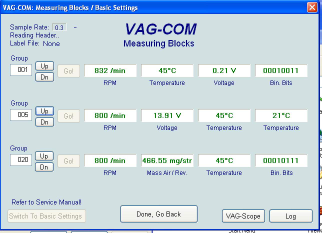

P.s. I was checking parameters whilst the engine was running and in Group 5 I was noticing two different temperature values. is this normal? (I have attached a screenshot)

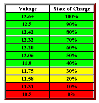

Checked voltage before starting the car up and its around 11.75v
This corresponds to 30% charged.
Thanks for this. I will check the voltage tomorrow morning again and if its the same I will change the battery.
