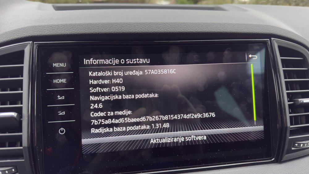

Can it be installed on version on the picture ?
Karoq
1 hour ago, Goran6061 said:
Can it be installed on version on the picture ? Karoq, i don't have sd card slot, only USB.
Edited by Goran6061
On 22/01/2026 at 20:56, Perb_bug said:
FYI,... this version doesn't work on my Škoda Karoq
I'm sorry but I have no experience of the Skoda Karoq but from your picture I would say no. These files are for MIB2 units only. They will only work on the Skoda Amundsen and Columbus MIB2 versions as well as the equivalent VW Discover Media and Discover Pro versions.

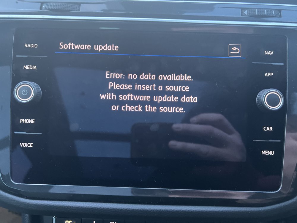

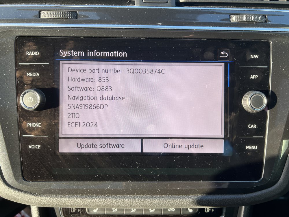

I found out why we have problems detecting or loading Speed Cam POI points:
1. The USB media or SD-CARD is not prepared correctly. In my experience and also in the official instructions it is written that it must be a FAT32 partition and 4096 cluster size and must NOT contain any BOOT records!!
2. The problem with an unrecognized database is that the created database does not support the device in your vehicle. The file "metainfo2.txt" contains 5-digit codes that describe device support or Firmware version support. In the case of an unsupported code, the database will not be recognized or installed.
VW T-ROC ŠKODA KAROQ
I also found another POI database SpeedCam which supports many more vehicles, but I don't know if bigade1 agrees with the post.
I used AI to help capture the data, so there may be some errors!
