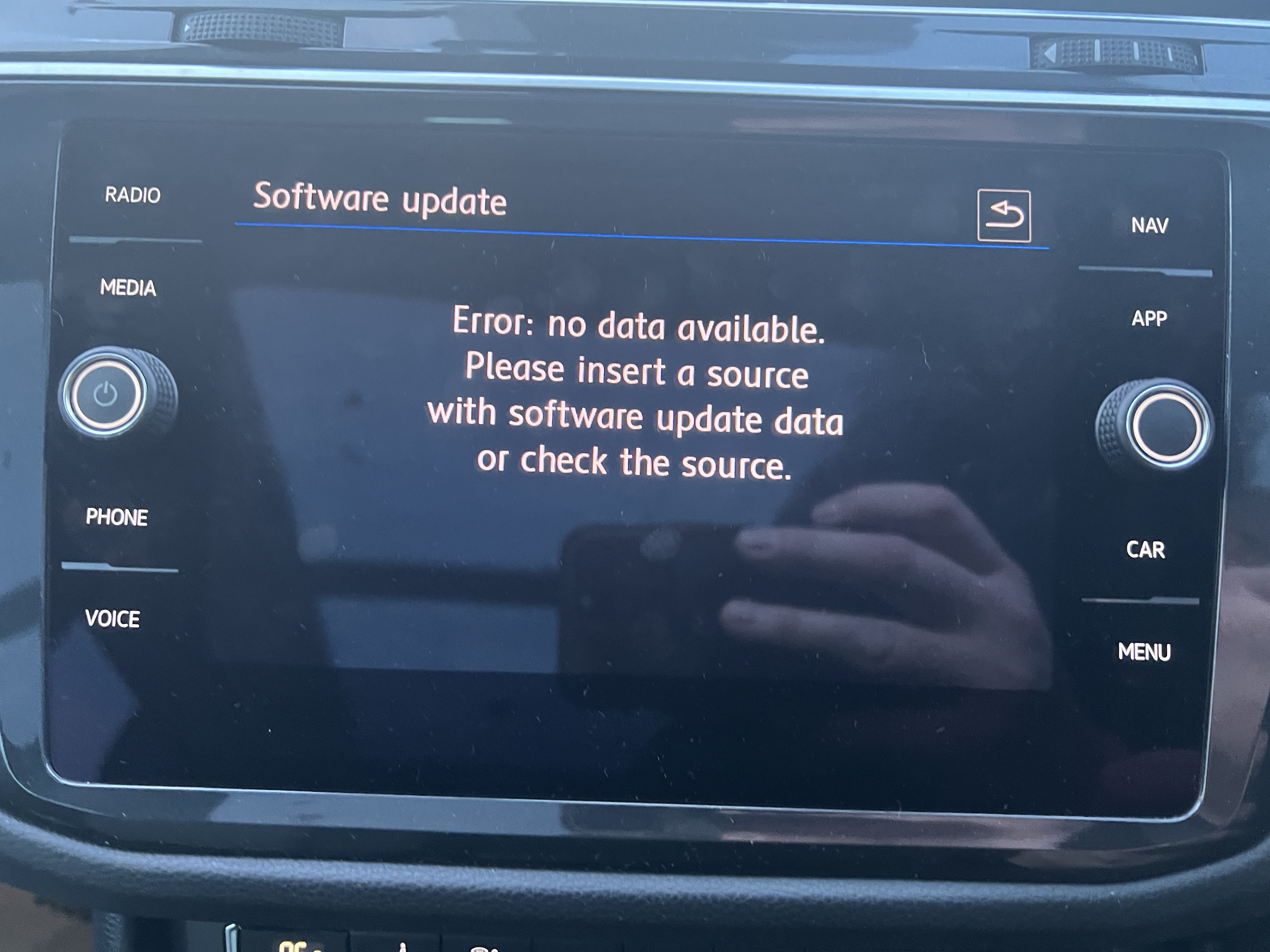

Hi everyone, I've tried everything possible and I still cannot get the latest update to install. When I put the SD card in it says "Update available", but when I go to install the below message appears.
"Error: No data available. Please insert a source with software update data or check the source."
I've tried:
Formatting the SD Card
Using Windows and Mac (I discovered Mac isn't compatible)
Extracting the folder directly to the SD Card
Using only the internal folders of MIB2HIGH, etc
Removing and reinserting the SD Card when searching for update
Locking the SD Card
Removed the metainfo2 file
Can anyone offer any other suggestions or a fix for this please?

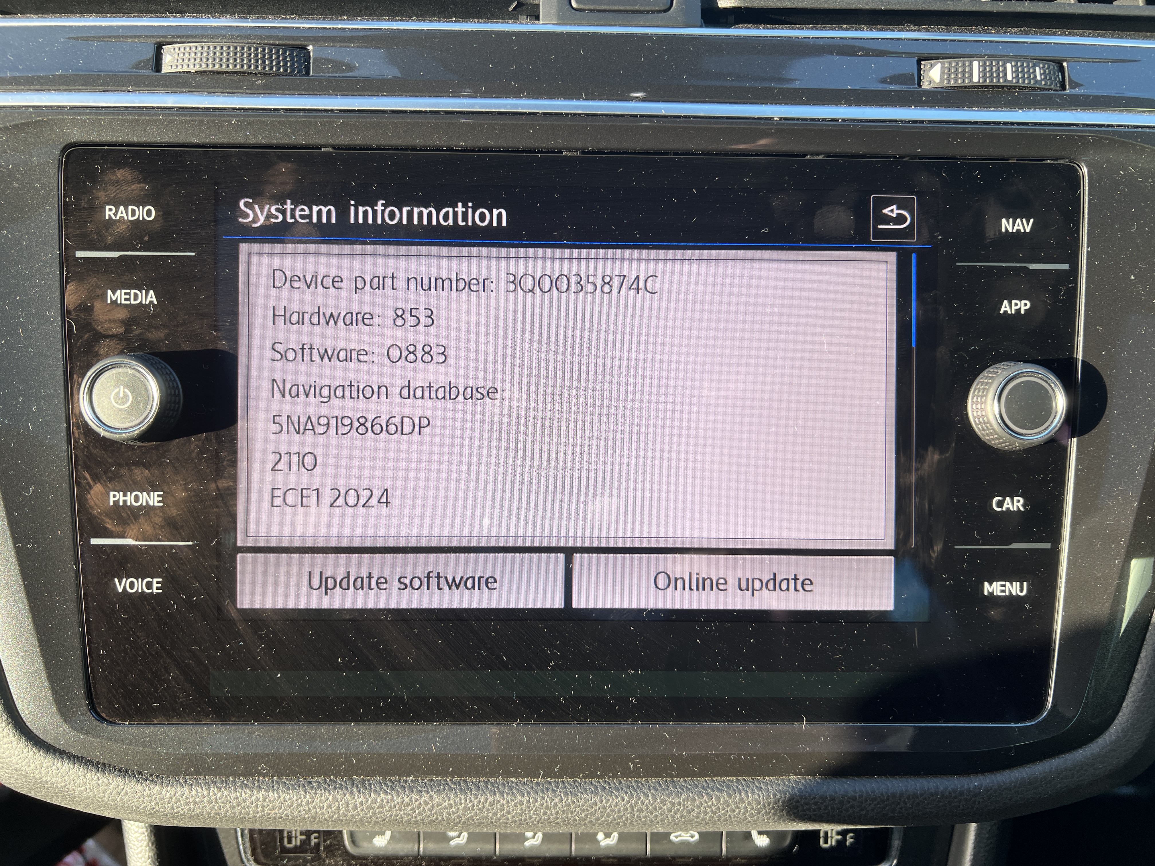

Hi BHughes, thanks for the reply.
I've followed the instructions each time, searching for the update through POI's. My image is just for the part number of my unit.
