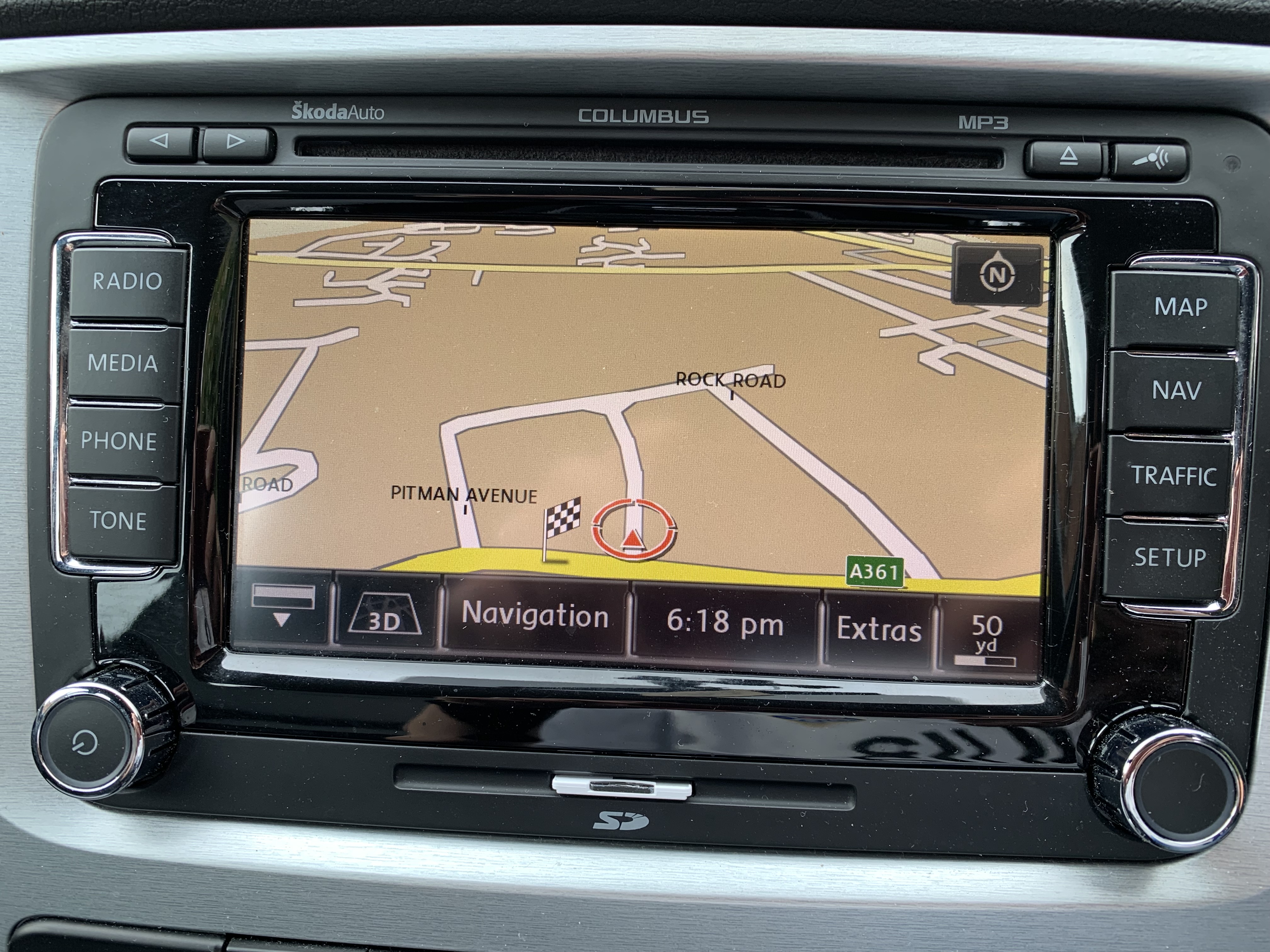

Hi all, new Octavia VRS owner here :)   I have a 2010 with a Columbus Sat Nav (as pictured).  I have tried bigade1's files (thanks for this) and followed the instructions. (I do also have a pocketgpsworld sub)  But can't see to get the files to be able to load.  I have no "manage memory option".  Is my Columbus too old to support the files please? Many thanks in advance.
