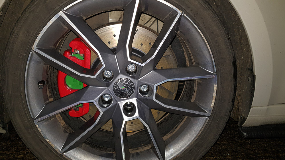

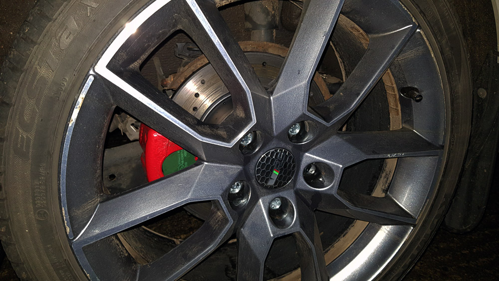

called Mtec last night and they had a full set of these for me plus greenstuff pads this afternoon. I got the protective rust proof coating, dimpled and grooved. Have to say im impressed by the quality for the money, the EBC pads were almost as expensive as the discs.
295 all in considering the pads were near 160. They have a few discount codes running. I think they look really tidy.
Edited by JohnnyType2
Ooooh if i knew they looked that good treated i would have gone for it. I figured i would  be ok untreated.  and if I needed to do them all again in a few years then £230 ish isn't too drastic for new brakes all round. I would say i'll paint them but i know i wont.
They wear down to a nice pattern with the black coating. If only if would stop blowing I could fit them tomorrow.
They look like this run in... :cool:
